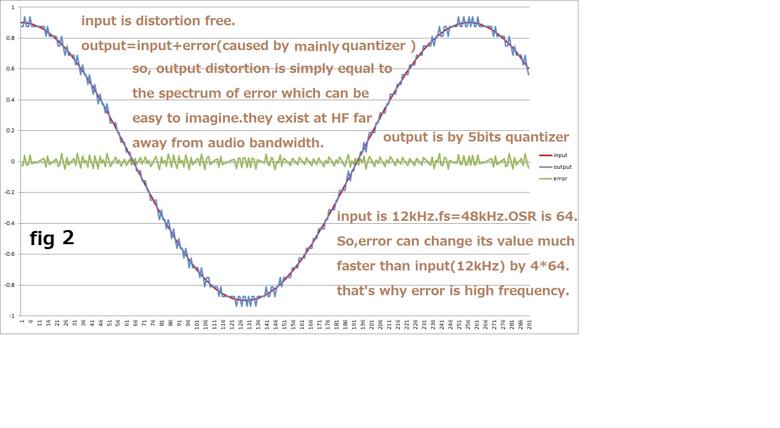

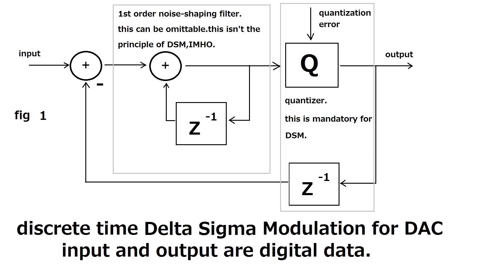

Here is my SIM by Excel.I usually use Excel because the spreadsheet is basically the recursive formula which has the real number.The process of DSM or FIR can be seen step by step.It's easy for me to understand. DSM is also easy to visualize by Excel.
fig.1 is the simple 1st order DSM to be SIMed.The quantizer is 5bits.1 bit is also possible.But a little bit difficult to understand visually.Almost every circuit consists of input, output, and error.The output can be defined like this.
output=input +error
Regardless of quantizer resolution and OSR, this formula is true.fig.2 is input, output, and error SIMed by Excel. The output of SDM is usually difficult to understand without math.Even using math, it's not friendly.A rough estimation of the output spectrum is not easy. But the difference between output and input, which means error, is friendly for me. It apparently has much high-frequency noise and less low frequency.
And I'm sure the toggle frequency of error depends on OSR.The higher OSR is, the higher it toggles.In other words, high OSR can shift quantization noise far away.Large quantization bits decrease the amplitude of error on the other hand. Both decreases THD of error.It means the decrease of output THD.The true meaning of OSR and quantization bits can be guessed by fig.2 without math.
fig.2 is the SIM of large amplitude, 0.9*cos. Smaller amplitude is also possible to SIM.fig.3 is 0.00097 (1/power(2,10)). DSM also can output somewhat accurate data. But the residual quantization noise is large because of the 1st order.

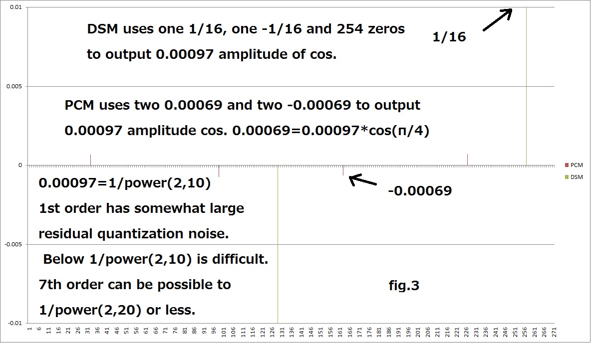

If you use 7th order, as low as -120dBFS(1/power(2,20)) is possible as long as I measured the output of a real FPGA.
PCM and DSM are the way of digital recording.PCM is high resolution with low sample rate (a little bit higher than Nyquist).DSM is low resolution with high sample rate.Both solutions are possible.DSM is practically good at high accuracy.I can't say the sonic issue. It's the subjective issue.

OK. I think it's time for me to give up, I just cant be convincing enough. But I must test that code, Marcel.
But I will give it one more try.
Take a pure 1 bit S/D device running at 128fs.
The weakest signal it can represent is just to let one of these 128 timeslices be 1 and the rest zero. If doing so, the weakest signal at maximum frequency ( fs/2 ) will be 1/128 of maximum amplitude.
Isn't this a striking picture? Disregarding any math. It's kind of a matter of common sense.

Svitjod, your 1 lsb pulse for the entire base sample rate window is mistaken, way "too simple" for Higher Order Modulators
D-S makes new decisions on output bit pattern at each of the OSR time steps - the output is very 'busy', spans multiple bits of the 6 bit DAC

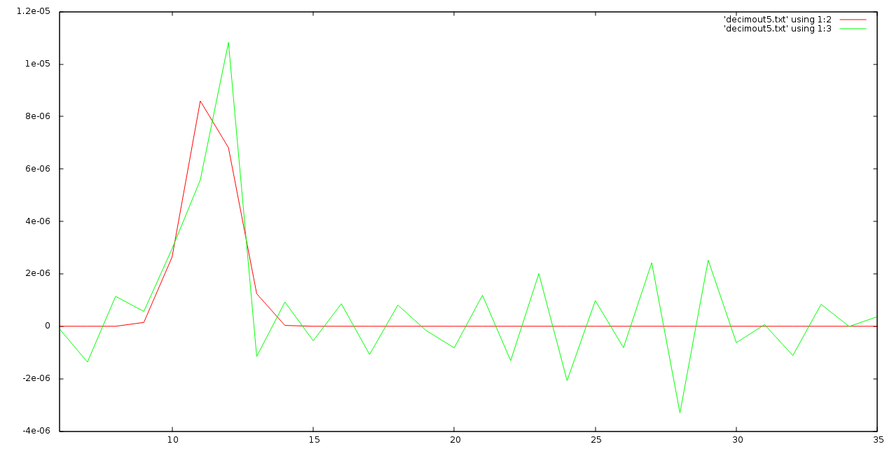

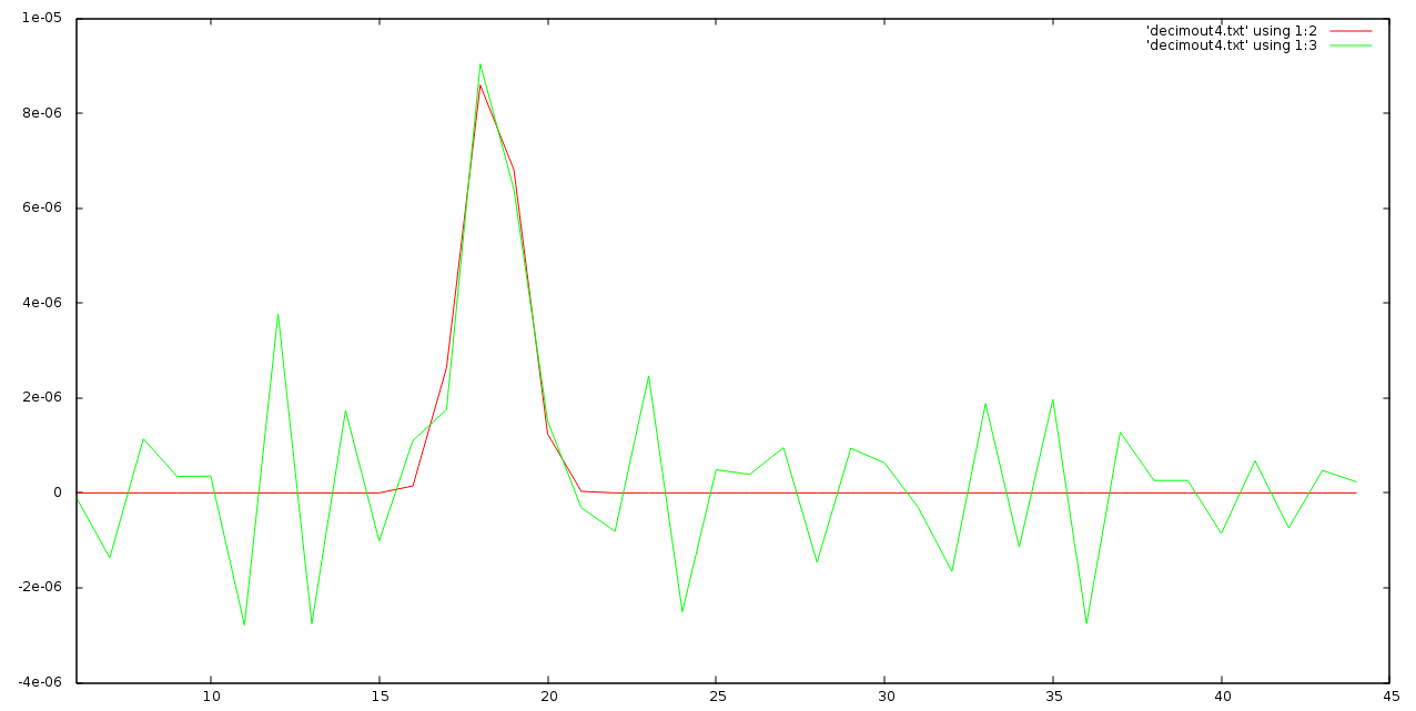

Please allow me ...
In essence, what you've described is a very basic "oversampling" process:
- begin with a *low-precision* quantizer, operating at some oversampling ratio (128Fs, for example)
- input this oversampled *low-precision* signal into a simple averaging (FIR) filter, with equally-weighted taps, and with a length equal to the oversampling ratio (128 taps) ... so you are only using 128 *low-precision* input signals, for example, to calculate each "high-precision* output.
And you've discovered a "resolution limit" to this very basic process :(
But what you're missing, are two VERY important aspects of more modern, more sophisticated oversampled quantizers :
1. Higher-order (more "aggressive") noise shaping (in addition to basic oversampling)
2. Higher-precision outputs are created with filters (FIR or IIR, analog or digital, it matters not for this discussion) that "remember" many, MANY more low-precision input samples than, simply, the oversampling ratio
Higher-order noise shapers, and the FIR or IIR filters that follow them, are virtually impossible to understand, completely, in the time domain. The frequency domain is where you need to look. Both domains contain the very same information, of course, but often one domain is easier to understand than the other ...
I've combined a few of my Pascal programs into one: it is now a complete interpolation-sigma-delta-decimation chain, albeit with somewhat primitive filters: simple linear interpolation and sixth-order CIC for decimation. For comparison I've added a second path with the same signal transfer function as the path with the sigma-delta, but without any quantization.

I made a few plots of the only filtered (red curve) and sigma-delta modulated and filtered (green curve) signals. The input signal was a single sample of 0.0001 in a series of zeroes (first plot) or a single sample of 0.00002 in a series of zeroes (second and third plots). I forgot to put a randomize command in the Pascal code, so the dither always has the same value at the same place.
