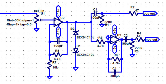

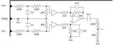

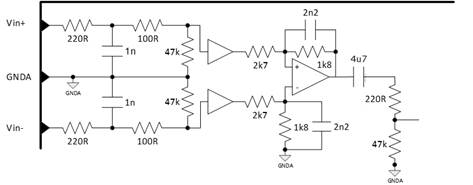

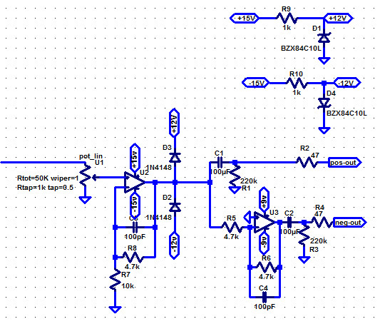

Building a bass pre-amp for use with a class D power amp module. The documentation for the power amp says the balanced input cannot exceed 12 volts on the +/- inputs and my pre-amp works on 15 volt rails so I think I need to clamp the outputs to 12 volts, just to avoid any spikes. I want to push the power amp as much as possible without distortion.
The first attachment is the input section of the class D power amp from the documentation.
The second attachment is the output of my pre-amp with a clamp using paired 10v zener diodes to ground.
The third attachment is another clamp with silicon diodes going to 12 volt rails generated from the 15 volt rails using 10v zener diodes.
In both of these I have forgotten to add a resistor right before the clamping diodes. Probably something really small, under 1k.
Now which method is better, in terms of distortion, impedance or any other problems?
Is there a better way that doesn't involve many more components?
Can I lose the output caps or at least not use bi-polars?
Anything else wrong with this?
I'm using 10v zener diodes and not 12v zeners because in LTSpice simulations the flattened peaks were always a little above the specified voltage, because of the soft-knee characteristics of zener diodes.

It is preferable to have the soft clipping at the preamp output to avoid the hard clipping at the PA output.
Most preamp outputs, the output buffers do not have a gain or if they do it is very low, like 3dB. There is a 3dB increase simply by having the balanced output so do you really need more than this? With a buffer and inverter the input would be where the clipping circuit is placed since then the output buffers would never clip.
Do you expect to run the PA at or near full output all the time? if so, then you should really be looking at your speaker setup and maybe also get into a band with "normal" players who play at Human Scale loudness levels.
Think that is what he is looking for.
So that would give us the desirable soft clipping from point #1?
