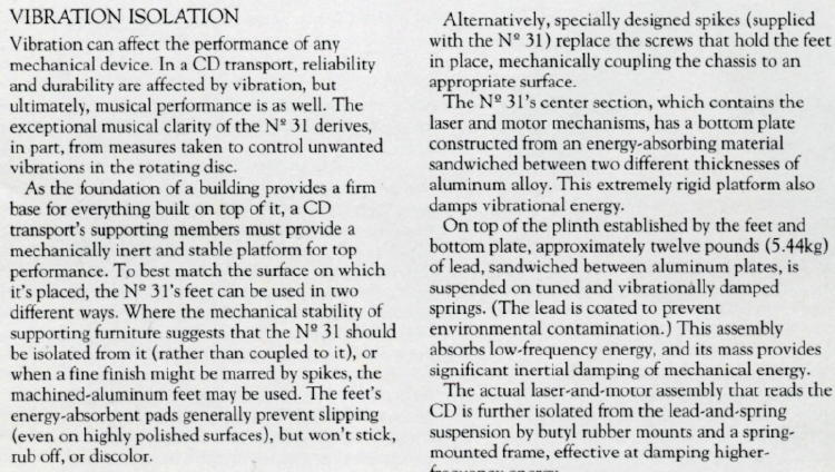

Taken from Mark Levinson 31 CD Transport literature:
Who in turn has looked at what Goldmund had done with their TTs etc...
Who in turn had it from Michel Levy and his brother, Pierre Lurne, Jean-Constant Verdier and myself.
Who in turn all had studied " Electronique et Physique Applique" as it was part of our courses at university.
Small world, isn't it?😉
