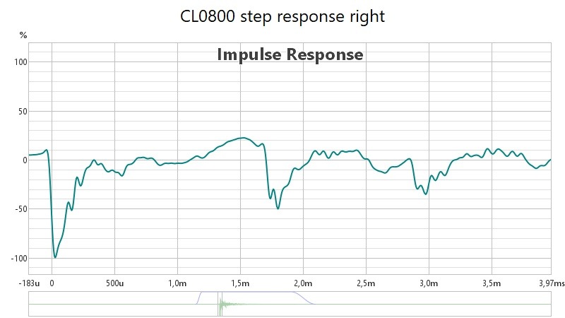

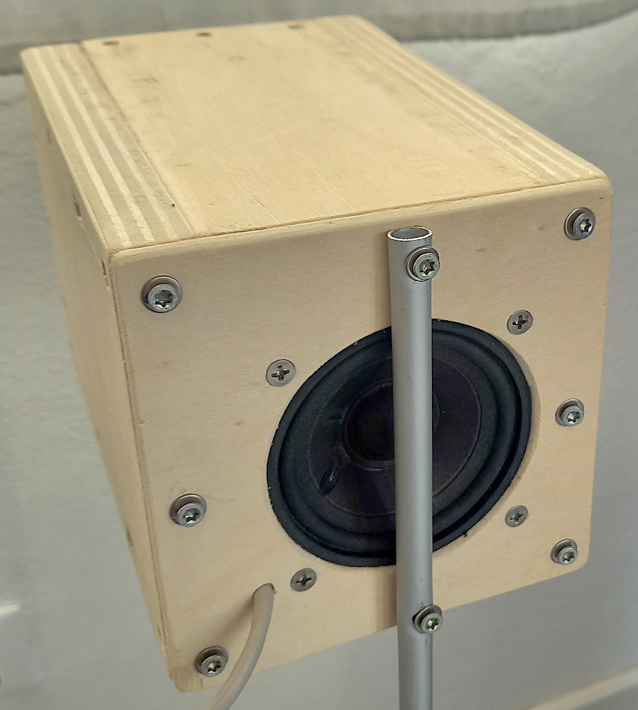

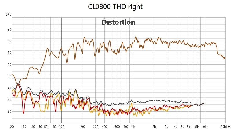

This CL0800 project is a closed box satellite with directional frontal emission.
The driver is a Faital-Pro 3FE25 already used in previous MDD projects. The CL0800 satellite sounds good although limited in bass.
The case is oversized, I will need it as a compression chamber in the next MDD project.
Construction is simple and inexpensive. The unconventional stand has a subsonic resonant frequency at approximately 1 Hz, isolating the satellite from the floor in audio band. The wiring is original in that the negative pole wire passes behind the radius of the basket in ferromagnetic material, avoiding inserting material inside a coil that can generate hysteresis phenomena and consequent distortion.
