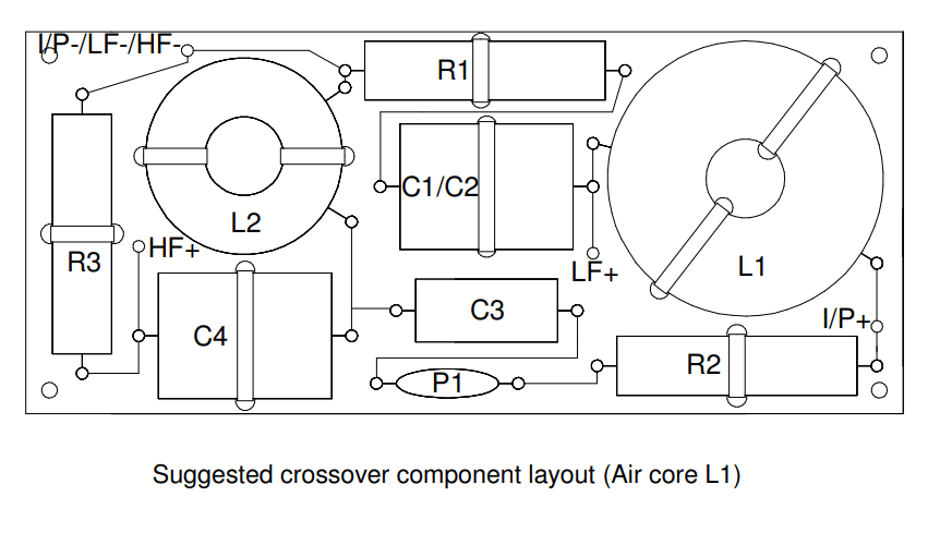

For making the crossover I'm going to use the plan shown on the link above, although one part of it has confused me a little. On the design C1 and C2 are shown next to each other but with a "/" in between. Does this mean that the values are interchangeable or will I need two capacitors for the low pass filter? Also on the diagram for C2 the value is in uH instead of uF, I'm guessing this is just a typo though and I'm just going to use a uF value instead. For the inductors I haven't really been able to find ones of the exact values so I may have to buy some larger ones and uncoil them to get the right value, does anyone have any experience of doing this and know how to get the best results? I've also drafted up a components list of what I'll need for the crossover:

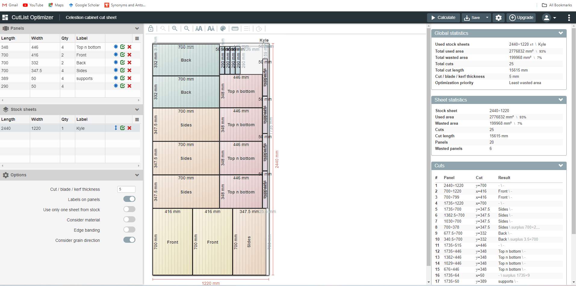

I've got a cutting list now which took a bit of calculating to figure out but has been confirmed as the correct measurements by the guys at celestion. Two of these cabs will fit pretty nicely into an 8 x 4 ft sheet (with some spare material)
I should be getting the panels cut sometime next week and then I'll be starting construction. I wanted to get peoples opinions on using biscuit or domino joints to secure the box together. I wanted to just use glue and screws but I'm not going to be painting the cabs and don't really like the look of exposed screws so something hidden like a domino seems to be the best solution, let me know your thoughts though!

I've also ordered all the electrical components for the crossover so will be making those next week as well, any pointers on how to join multiple wires to one terminal? As the bellow layout shows they recommend that all of the negative wires are joined together in the top left of the board, but this will mean joining 3 sections of around 17 gauge wire to a very thin component lead from resistors 1 and 3. I've seen people soldering these connections together, some using junction boxes and some using wire nut strips. What would be the best way to do this to get a reliable connection that won't fail and cause the speakers to break?
