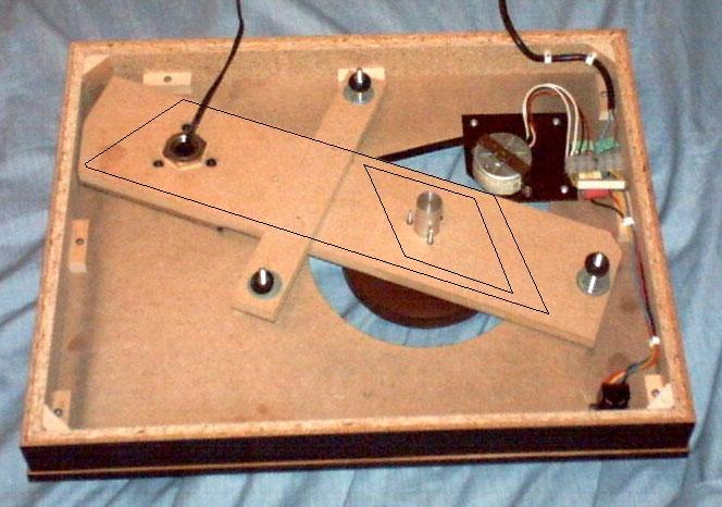

Subchassis
Remove the suspension cross piece, but first drill two screw holes for relocation.
Obtain some aluminum sheeting - I'm assuming here its 0.5 to 0.6 mm thick.
The subchassis is reinforced top and bottom with 2/3 layers of aluminum.
First remove the armboard - for further details see arm mounting.
Extend the cutout to clear the Rega arm nut.
The aluminum layers and the subchassis are glued together using contact adhesive.
(The model used here is constrained layer damping)
We are talking the proper stuff here - usually in the sniffing cabinet -
do not use the wimpy water based stuff - (well I never have).
Using these adhesives properly is an art in itself - so ask for more details
if you are not sure - it can't do any harm.
Cutouts are to clear the arm nut and for the main bearing, + various holes.
The top layer is extended at the arm end to completely cover the subchassis.
Make a bearing reinforcement, a diamond shape with cutout, 8/10mm wood/plywood/MDF.
Align and drill two screw holes for the bearing reinforcement.
Araldite the bearing into its new position, don't use too much araldite as its not
critical as the top has the flange, invert the subchassis and araldite the bearing
reinforcement into place. Araldite the cross member into position.
Weighting the subchassis at the spring on the bearing end will help if the
springs are not in even compression, but first you need to make sure that
if they have different rates, i.e. stiffness they are in the correct position.

Arm Mounting
A spacer made of plywood to take up the majority of the height requirements is used,
its hole needs to be a little bigger than the arm to allow it to be aligned in the
cutout. The spacer is attached by three hemi-head hex bolts passing through holes
to oversize holes in the subchassis to nuts underneath the subchassis.
Use spreading washers on the nuts underneath the subchassis.
A (Rega) spreading washer used above the spacer will prevent the arm from twisting
due to an offset hole.
The spacer is finally semi-permanently glued to the subchassis with PVA wood glue.
The spacer is shaped to the top cutout of the deck.
Go to a plumbers merchant and acquire some large nylon or similar hard plastic
washers to fit the arm.
They are used for height adjustment.
(I used a cut down felt mat between my platter and subplatter for fine height adjustment)
Tightening the arm nut will require the spacer to be removed, when you are finally
happy, retorque the nut after a day or so and then semi-permanently bond the spacer.
Don't use Rega locking washers they interfere with the energy flow ;).
The arm lead needs to be dressed. The cable retention part from a mains plug is a
very good part for the job. Put a twist in the arm lead and align it at right angles
to the subchassis, attaching to the bottom of the rear surround with the clamp.
Before tightening the clamp adjust the amount of 'feed' so the subchassis is free
and the lead is not in contact with the base.

About 4 years too late.... Nevertheless "drastic" mods are needed
to address the sound issues described. Two pieces of MDF stapled
together is not "hardwood" and how do you know "it works so well" ?
How do you know it a strong part of the design ? IMO it is not .....
Obviously if you like the sound do not mess about with it.
Ludicrously expensive cartridges in cheap turntables are a waste of
time. Far better to spend money on a very good turntable and arm.
:)/sreten.

Hmmm .......
Current feedback (i.e. negative output impedance) helps in allowing
the speed / voltage of a DC motor to work, i.e. compensates for the
windings DCR. Speed / Torque is not the issue.
IMO changing the motor will not fix the described sound issues.
:)/sreten.

IMO FWIW the subchassis construction determines the subtle points
of reproduction of a well set up turntable. Thorens decks for example
IMO are difficult to get to really fly without subchassis modifications.
And like I said if it isn't broken do not fix it .....
But the sound of the Walkers can be changed, IMO more neutral/ better .....
A Koetsu in a 774LC in a budget Walker ? not sensible .....
:)/sreten.
