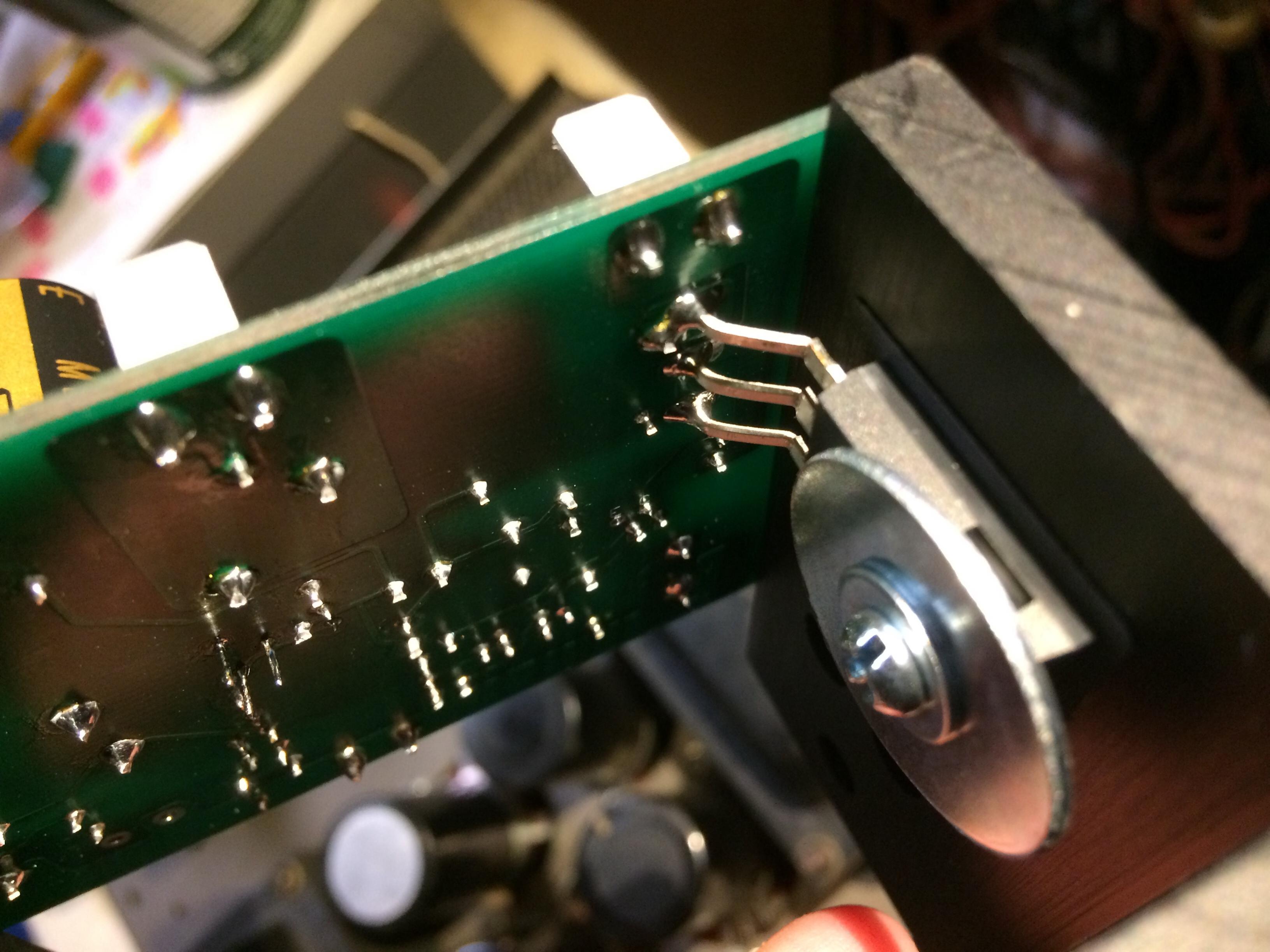

I'm struggling with my C12, when I sterted it first I had a little humm and very low volume. I had to put the volume source at maximum to have a decent sound.
One of the mosfets was warmer than others and when I moved the amp from the test loudspeaker to the good ones I had only one channel worked, then even that one stopped working. So silence and no more humm.
I've set the bias to 250mA and the radiators was less than 35degree after one hour.
There is something I noticed, the power supply give me +/- 34,65V with a Tx 24V.
I guess the Mosfets died, and I don't know why the volume was so little.
Please whoever has any idea don't hesitate.

Send me a PM with some pictures of your amp (where its possibly to see the assembled components on the board)
