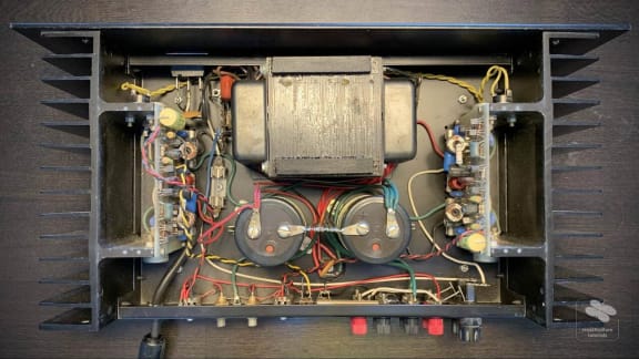

I like the wiring of the Naim - someone really had some thoughts about the construction and wiring in advance, and did't add any flying cables as an afterthought.
But - you just can't judge the quality by looking at a picture.
Agree - its the only one without high current secondary winding leads dangling over the PCB. And yes you can't tell component quality this way, besides its the weakest link that matters, many parts don't need so much "quality", just not to be junk.

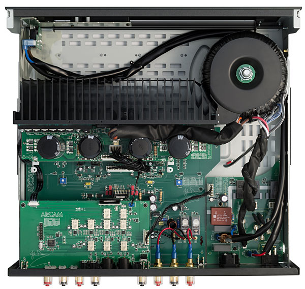

Arcam actually does make a "plain" 200W class G power amp with it's dual PS's - real clean layout (below 1).
- Class G switched "Leach" symmetric topology. I think they even use a discrete rail switcher. About .01% @ 20khz - nothing special...

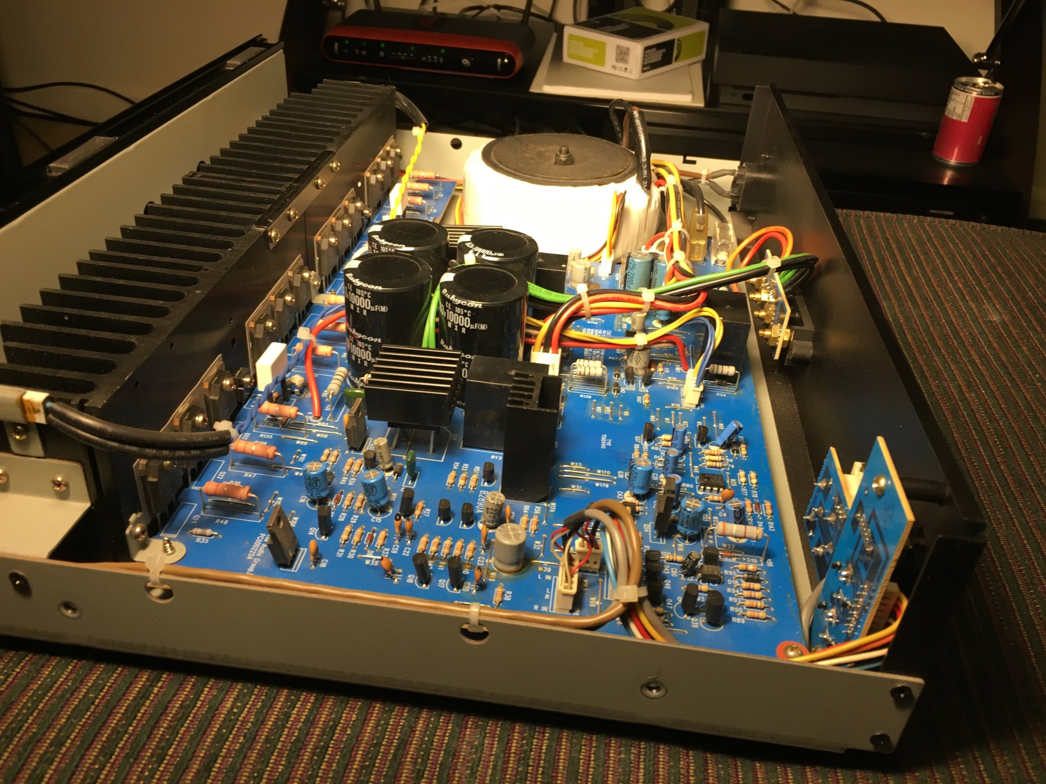

- Niles makes a plain ol' class AB 150W - the SI-275 - https://www.audiosciencereview.com/forum/index.php?threads/niles-si-275-amplifier-review.12055/

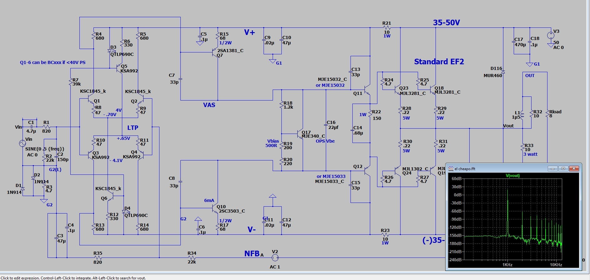

Yup . .01% with the same "Leach" front end (below 2/3). Just bought one for $50 broken !!
Easy to reverse engineer , get rid of the ceramic comp. caps , use 33-47pF silver ones. "Leach" can still be VERY stable @ 1+Mhz UG.
Nice to simulate it , works out a little better than spec (the review).
These amps are for commercial HT installations , built way better than typical public junk ! Yup - just bad caps after 30 years.
A couple sketchy solder connections and dirty boards - that's all.

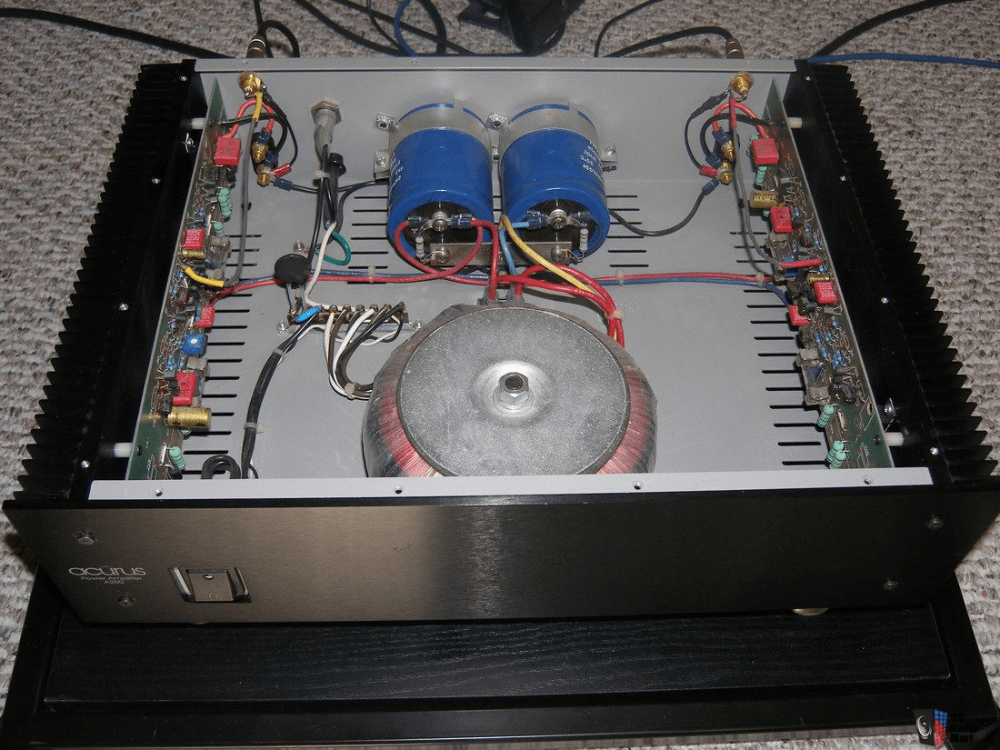

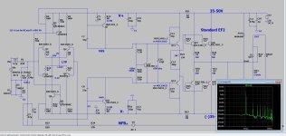

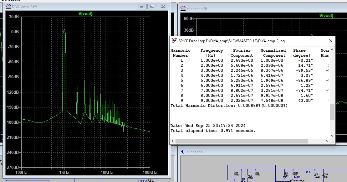

Here is another good one for the "Mod" - a Acurus A250. Reviewed and tested - https://www.audiosciencereview.com/...s-which-test-well-under-1-000-usd.6250/page-5
EBay - 2-300 broken or 5-600$ working.
LOOK how clean that one is !!! Almost a Wolverine.
It does fall short , being just a overbuilt EF2 (like the badger). But , 5-10 PPM will work.
Any of these amps are quite the jump from any marketed integrated offerings. Just get a E30 topping DAC
and maybe a preamp , good to go. Easier to fix , not "stuck' with anything obsolete.
Best thing , after re-capping and a few tweaks - you won't ever need to buy (more).
If you want to get "nerdy" , put a Wolverine in your case. 1-2 PPM amp to match your 1-2 PPM DAC !
Start building better speakers !!!

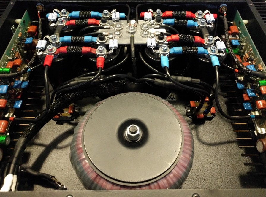

Edit - he modded that Acurus bada$$ !! last pix. quite the PS !! "Nerdy"....
