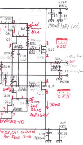

Q1 / R3 sets the current...remains at a fairly constant Vds
Q3 dissipates the power...may vary significantly (depends on rest of circuit)
More stable set point
IMHO
IMHO
Yes, too much missing really...I thought it was a current source but it does not have to be that.
