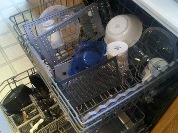

Water does work well to clean dirty boards. Many people put the boards in a dishwasher. I've used a pressure washer many times. Removing the potentiometers is best.
Dishwasher is a wonderful thing when you're repurposing HP test equipment -- this HP401C was in really rough shape, so will become a fan cooled dummy load avec wattmeter. Don't tell the wife:
I used to repair VCRs. If they had had a sandwich fed into them by a delightful toddler I regularly used to give them a bath in fresh water. As long as everything is dead and you dry everything before reapplying power, water will do no harm. Unless of couse it seeps into something that it shouldn't.
I powered up a PCB once that I had washed with water and thought had completely dried. Water stuck under the electrolytics quickly caused electrolysis and shorted the capacitor terminals. I had to remove the capacitors, scrub the crud off and solder them back. PCBs need to be dried thoroughly, and I don't see that happening sufficiently at 100F.
I would try mass airflow sensor cleaner in the spray can from auto parts stores, it dries super quickly and has no residue. I use alcohol on cotton swabs to clean boards, and it evaporates quickly to avoid damaging things. The dishwasher idea is great, just be sure to remove things that will hold water like the pots and leave them to dry thoroughly even after blowing any liquid from under the components with canned air.
