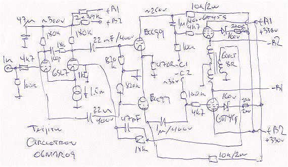

That ECC99 dual triode driver looks very good, even pin compatible with the 12BH7 but much beefier. The Monoblock schematic could even be similar to the original design for Sk8Ter's amp. Certainly the simpler approach to take and more likely to reach success under the limited facilities available.
Agree with you !
But just think that Sk8Ter 300 W Circlotron Amps run with much higher B1+/B2+ UBa , maybe even around 600V-700V , like it in this schematic simple solution for stabilization of output power tubes 160V Ubg2 suply over the two zener diodes .
:cheers:
The screen grid cross connection is a technique to keep the voltage from cathode to screen grid constant (for each output tube). Its actually connected indirectly to the same side cathode thru the floating supply. On the audio type tubes, this is usually just direct cross connected. For the Sweep type tubes, there is a voltage dropping zener to get the plate V down to the lower screen V. Although it's more common (than the Monobloc schematic setup shown above) to see a cross connected dropping resistor down to the screen with a zener from cathode to screen. If the floating plate supplies have a center tap voltage, then that could be used for the screen supplies instead.

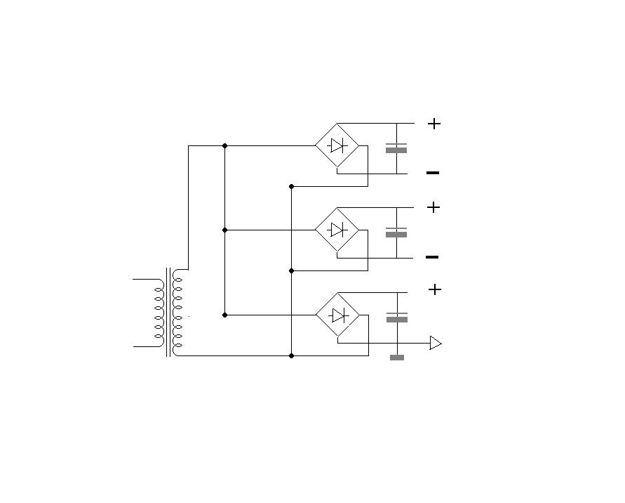

floating power supply
only having one trafo per stereo channel, I suppose its ok to use doube bridge and caps, one fore each output tube ?
I reckon input/driver should have their own seperate and grounded supply ?
being grounded, could that come from same trafo as above, but equally with own bridge/cap ?
btw, I have seperate heater trafo with CT, but unfortunately no CT on main B+ trafo

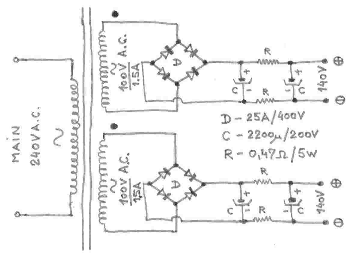

No , for each Circlotron channel you need two galavanic separate same value for main trafo secondary , so for stereo Circlotron Amp you need four galavanic separate same value trafo secondary , this PSU configuration it is for Circlotron Amp topology obligatory !
After rectification and smoothing capacitors Do Not connect both PSU B- on the main ground point , they have to be remain floathing ,same as for both B+ !
Important thing is to connect both main trafo secondary in the same manner to the SS rectifier ( in phase ) to get minimum hum ( PSRR issue ).
Not sure what kind of Circlotron Amp you want to made ?, OTL or OPT or ? ..., since for old style pentode Circlotron Amp you don`t need another separate PSU for input and driver stage , that come derived from the same output power stage Circlotron floathing PSU . Separate heater trafo with CT is OK !
Some schematic , or your start idea well be helpfull for future best PSU design .
Here is my old PSU schematic for Atmasphere M60 OTL Circlotron Amp ,attached here just for better Circlotron PSU understanding :
Best Regards

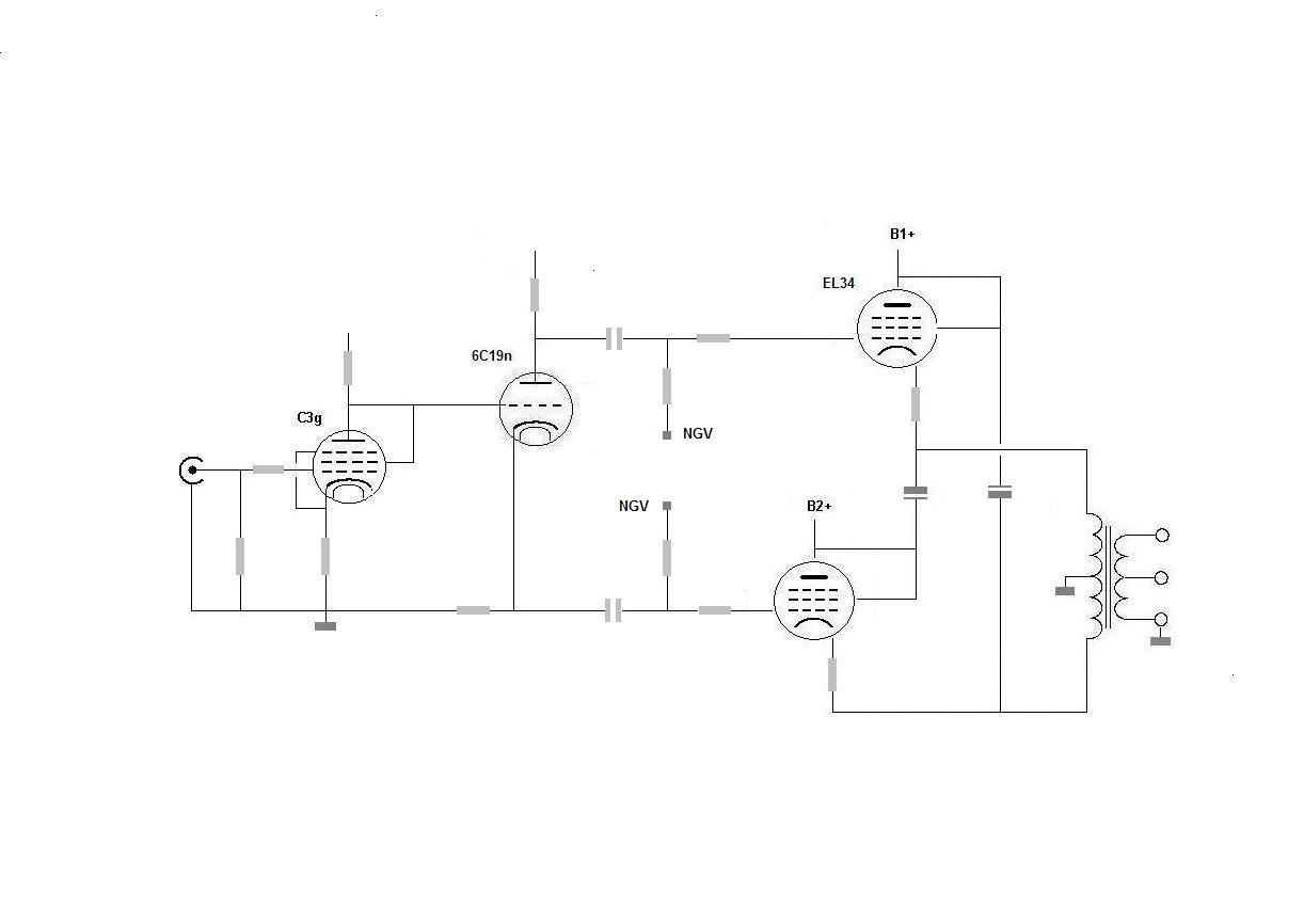

rough schematic of what I had in mind, (have the C3g and 6C19n)
OPT are 1.6Kohm PP
not small, and not exstremely big either
moderate output is my goal
obviously not the best way to start a project, with wrong parts
btw, we talked about the triode connected penthode, and I need to change that
Yeap, mandatory 😉
PSUs not only need to be galvanicallly insulated but also must be able to really "float" within the whole frequency range of interest.
Choose transformers having low capacitance between windings (this excludes toroïds).
Yves.
Tinitus if you insist on the Circlotron Amps with moderate output power and triode power tube for Circlotron output stage here is one schematic for you , unfortunately this amp need separate PSU for input and drive stage , but OPT it is just ordinary small 80-100w main power torus trafo 120v~/16v~ .
The whole article related to this schematic you can download from here : http://www.fonar.com.pl/download/circlotron6as7g.rar.
Best Regards
