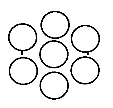

Hi!
Would it be possible to arrange the speakers round or hexagon, octagon, etc. instead of the classical line array arrangement?
Anyone done this before?
Greets:
Tyimo

As in on a flat baffle, or on multiple facates / baffles firing in multiple directions. Both can / have been done, though of course present different challenges in design terms.

Keele describes a 'spherical cap array' in one of his CBT papers. Please see page 55 and following in

Works great to make a huge convex, or even flat baffle, point source 'full-range' driver, but not a single driver circular array per se.

This design probably tries to have a very wide dispersion. The spherical cap array tries to create narrow dispersion.

What do you mean on "not a single driver circular array per se" ?Works great to make a huge convex, or even flat baffle, point source 'full-range' driver, but not a single driver circular array per se.
IOW, if you just use 'FR' drivers to create a big circle, it won't work well, at least not to my ears or the others who auditioned the one I cobbled together using cheap mobile audio 'FR' speakers long ago.

Six drivers around a seventh driver act as one big driver, so they will beam horribly. If the ring of drivers is arranged around a waveguide, you might be able to cross over before the array beams too much. But I doubt the waveguide can control it's pattern down to the crossover frequency.
True, but beaming can be a good thing to keep first reflections behind the listening position [LP] and if you focus them to mimic a point source driver you can get away with rolling the 'ring' off fairly high.
Still, the ones that worked best for me were four 15" [mid]bass woofers with a large horn in the middle XO'd @ 500 Hz.
