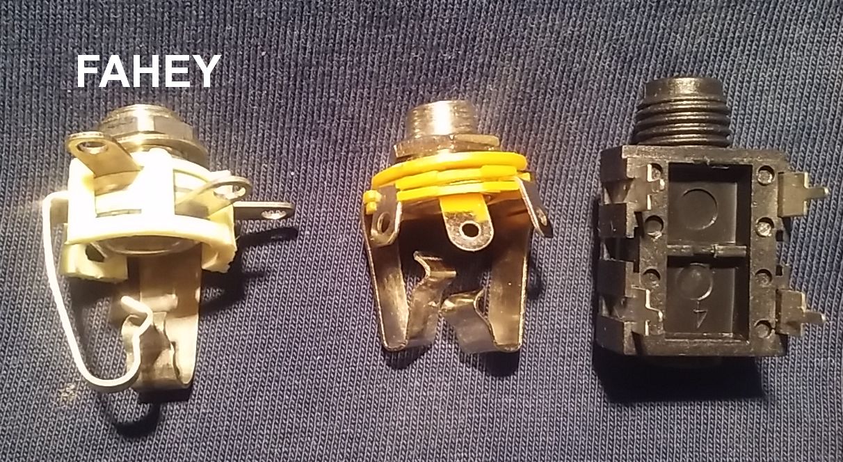

FWIW some used specially reinforced jacks to cope while maintaining the old standard.
I´ll show you my own
Center is the typical generic jack you can buy anywhere over the counter, I show a Stereo one because that was the inspiration for mine, notice thin metal used for contacts. And the cheap ones just use nickel plated iron
Right is the current most popular, the "Marshall/British/Cinch type" , again thin metal although good ones are made of plated phosphor bronze.
Left is mine.
Custom made (I had to order 1000), *double positive contact*, notice both are same length and grab tip from both sides, and to boot made out of triple thickness spring temper phosphor bronze.
I have to instruct users about them because it´s hard to insert plug and even harder to pull it away (I had a problem of high power Bass cabinets "spitting" the plug out )
Also notice enlarged terminal holes to admit thicker wire.
Left is mine.
The problem here is current...
The amp in *this* thread seems to be a UL84 team (same as EL84, say 18 Watts). Many thousands of 10W-50W amps of all impedances have run 1/4" jacks. Aside from dirt and cheap springing, they work fine.
The connections in a SwitchCraft 1/4" are really closer to a US type 15A plug than say a USB 0.5A rating. And even headbanger musicians do not hold FULL power ALL night long.
The 1/4" is the obvious change for an amp in this class.
EDIT.... Early Ampeg SVT (300W) have EXT SP at 150W 4 Ohms, so 6 Amps. The Fender 400ps has *three* 1/4" jacks at 145W 4r each (again 6A).
