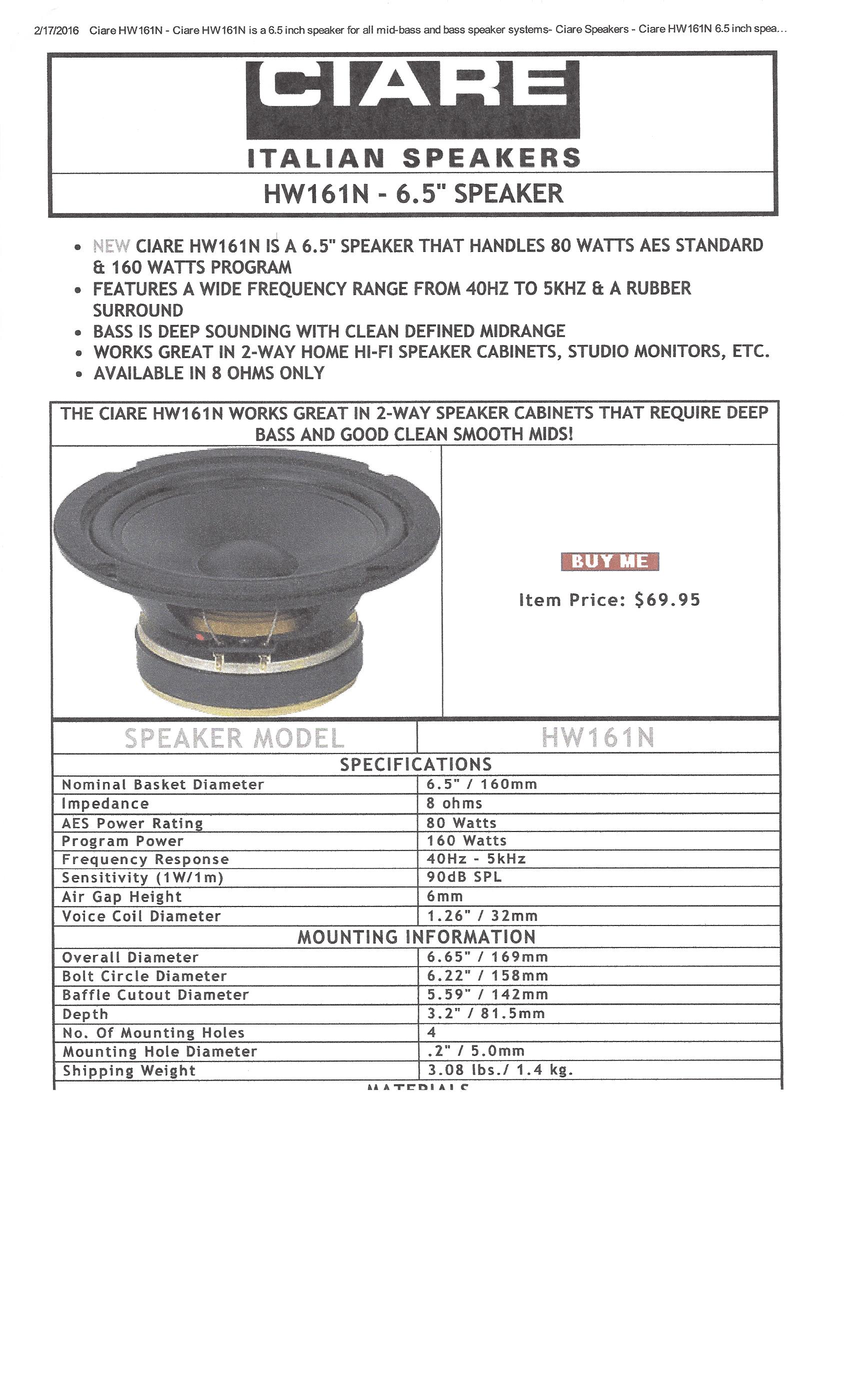

Hi to All,
I'm in the process of building 2 way floorstanders (approx. 24 L) and would like to get some feedback on this particular driver.
1. Is it biased toward midrange response?
2. How is overall build quality?
3. Is it a good choice for this size cabinet/ build type?
4. Any other impressions good or bad are welcome.

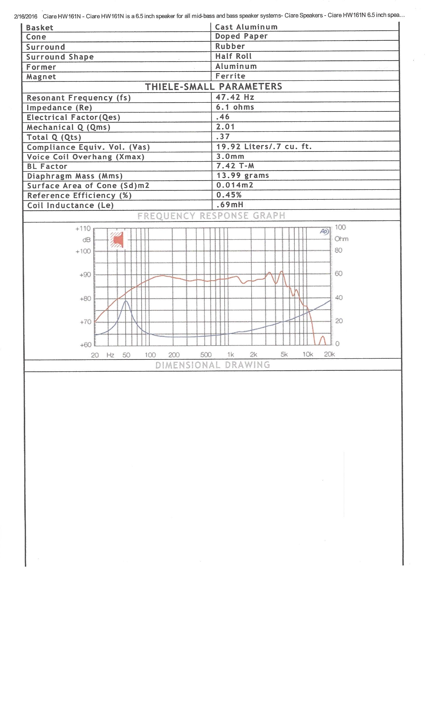

My initial thoughts are to pair this driver (or one similar) with the Seas 27TDFC tweeter and crossover around 2khz. So, looking at drivers with sensitivity (90db. SPL) that will mate well with that tweeter. Bass performance is important in this build but I will be adding 15 woofers in separate enclosures for phase 2 of project. Hopefully, I have provided enough information to get things rolling. If not, I will follow up with added info as requested. Attached is product information on this driver. Thanks in Advance!
Best Regards,
Rich
That ~5dB cone breakup dip around 1.4kHz will need special crossover work to hide in a 2-way. The T/S parameters for that driver aren't ideal for a 24Litre sealed enclosure. Fs is too high, Vas is too low for that size enclosure so you'll get a very lean bass response - F3 is at 95Hz. If you run a ported enclosure they do a bit better - 15Litres ported at 50Hz gets you can F3 of 51Hz, but I would shy away from running ported since they are harder to integrate well with a subwoofer. The impedance rising to 40ohms at 20kHz is a sign of a simpler motor design - thus, distortion may not be exceptional in the upper midrange where you want to use it in a 2-way.
I would recommend you look toward the Dayton Audio RS180-8. 24Litres happens to be the ideal sealed enclosure size, giving an F3 of 59Hz. Midrange distortion is known to be low, and the breakup that occurs >1kHz is well controlled enough to be managable for a 2-way. Sensitivity by TS parameters is quoted at 87dB but if you look at the actual frequency response measurement in the datasheet rather than the theoretical SPL calculated from the T/S parameters you find it is even more sensitive through the midrange than the Ciare driver - Dayton approx 89dB SPL, Ciare approx 87.5dB.

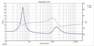

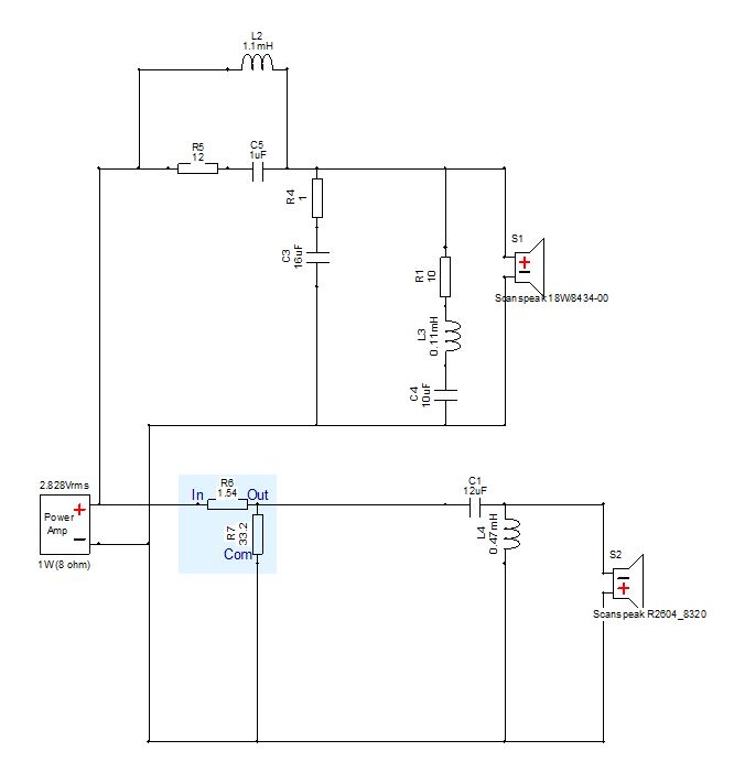

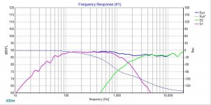

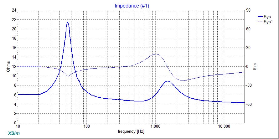

Here is my Xsim crossover attempt for the Discovery W18 using the drivers Troels listed in his build. I'm very new to this crossover schematic stuff. Am I on the right track? The files for Xsim were gathered using SplTrace. My goals are to design a crossover that on paper will yield very good listening results until I can acquire testing equipment to tweak the system. The crossovers will be housed outside the enclosures for ease in later tweaking as required. Any help given is very much appreciated! Attached is the before mentioned files from Xsim.
Best Regards,
Rich
