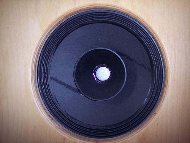

I use the CH's heavily modified in an open baffle.
The modifications are:
- dustcap removed
- neodym magnet 30x15 mm placed on top of the pole piece (that was tricky)
- damar on cone and whizzer
- two cuts in the cone (sealed with silicone rubber)
I might post some pictures later....

Interesting modifications! What do the two cuts sealed with silicon rubber actually do? :xeye:

The two cuts damp two resonances of the cone (inspired by scan speak). After cutting the cone the resonances were completly gone but the cone buzzed at lower frequencies. So I decided to seal them with a soft material.
I will post tomorrow some pictures and measurements....

On the picture you can see the two cuts and the neodym magnet placed on top of the pole piece.
More to come ( I'm a bit busy at the moment)...

I think Ciare also sells versions of the CH250 with 1 or 2 additional magnets (at the rear). Have you tried or listen to these. I am curious to know what the additional magnet on the pole piece brings to your speakers.
Also, if you compare the cuts, additional magnets, removal of dust cap and application of DAMAR (could you be more specific on where and how thick DAMAR is applied), can you please rank them in terms of improvements.

Here are my recommandations:
1. The CH250 sounds good without any modification (they are difficult/impossible to reverse!)
2. An additional magnet helps alot. Even when you apply it on backside I recommend an neodymium one ( since the basket is weak and ferrit magnets are heavier)...
3. Damar doesn't hurt. I applied it once (on cone and whizzer) just that it looks wet. Damar needs time to cure (several days to weeks)!
4. Use birch plywood for the baffle! My prototype was build out of 15mm birch ply, what i have now is build from 25mm beech ply, this should be more stable but it sounds worse.
I'm not sure with the two cuts, it measures better but I can't really tell you if the sound improved. So I don't recommend it.
The CH250 definitely doesn't need a supertweeter.
