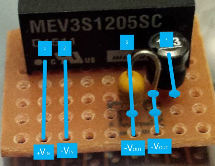

Hi barrymossel, I soldered the DC-DC converter, inductor and capacitor to a small piece of stripboard. I took the 12V DC in from my power supply and 5V DC out to a female USB socket, the used a short USB lead to the Chromecast Audio. I can take a photo of the converter arrangement tonight if you like?
For the 12V to 5v converter (MEV3S1205SC) the datasheet suggests a 10μH inductor (11R103C) and a 4.7μF ceramic capacitor.
The capacitor and inductor are for output ripple reduction.
Its all described at the top of page 4 of the datasheet.

Here is the DC to DC converter with its inductor an capacitor.

I'm a bit confused over the wiring of the capacitor and inductor. If I've read the data sheet correctly, for output ripple reduction (page 6), the capacitor should bridge the V+ out and V- out (pins 5 and 7), but from your image it "looks like" you have done this with the inductor. I don't suppose you have a pic of the underside?
I've tried running without the ripple reduction but I don't think the CCA likes it and keeps rebooting.

Sorry for the late reply, I was away on holiday last week. Does this help?

No worries, thank you for replying. That helps a lot thanks. I was about to return mine but I'll give it another shot.

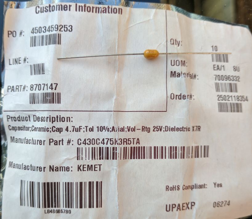

Did you get your capacitor from RS too? Do you mind me asking which one. The only one I can find has to be bought in a pack of 10.
C430C475K3R5TA | KEMET 4.7?F Multilayer Ceramic Capacitor MLCC 30 V dc ±10% X7R Dielectric Max. Op. Temp. +125°C | KEMET

Hi Mike, Sorry again for late reply. Yes that does look like the one. Here is the packaging for the ones I got.
I got the pack of 10. If you haven't bought them yet PM me your address and I'll stick a couple in the post to you.
