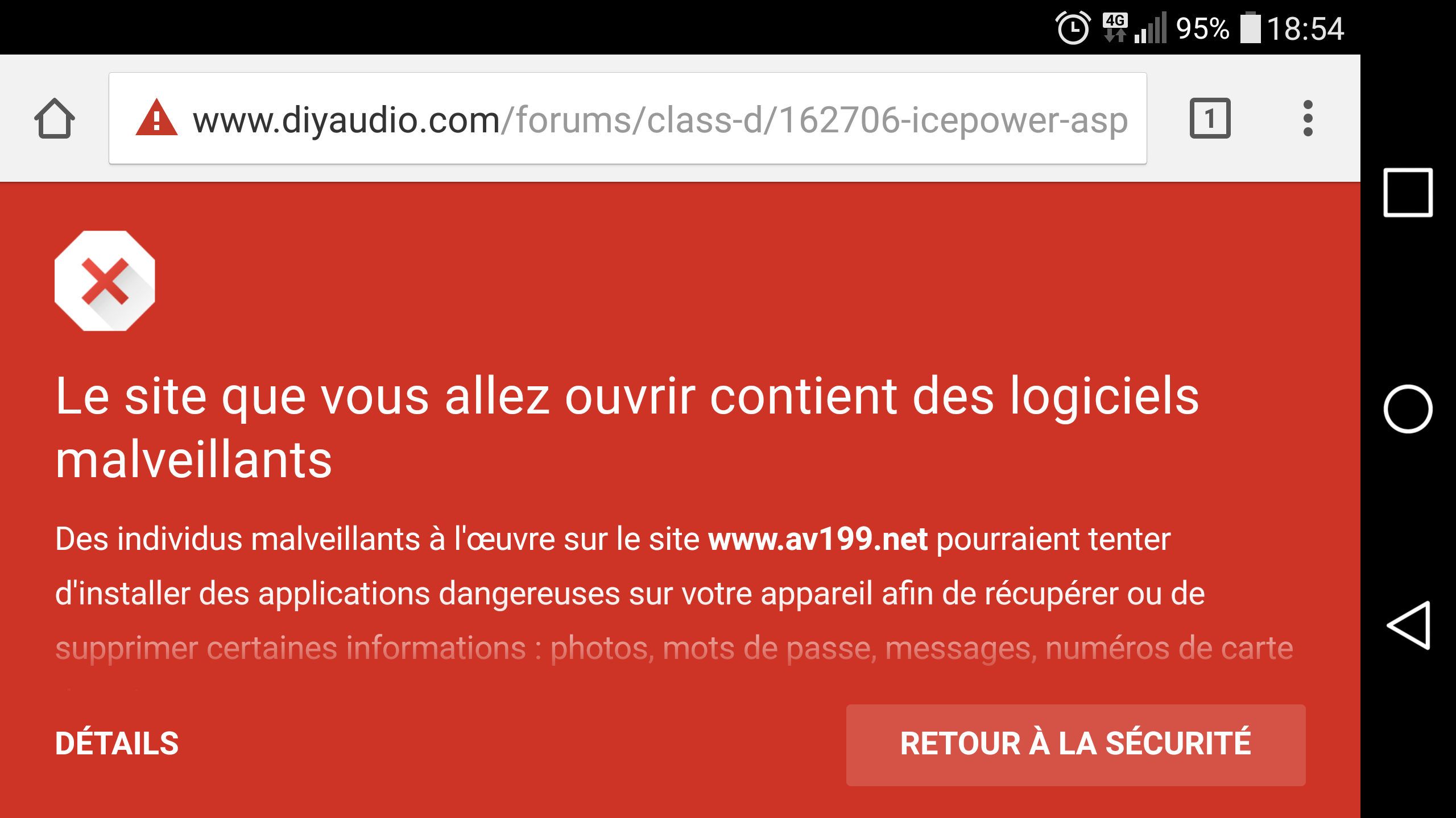

Hi, i was surprised to see yesterday evening while browsing the site constant warnings of malware from chrome on LG G4/ android. Has anybody experienced this?
Most likely this is because of a malicious ad. DIYA itself doesn't serve malicious content and that's why I have a picky adblocker. I block every ad that comes from a not-so-reputable ad provider. Ads about 'Sales' etc from webshops that usually get related to what I search for (eg if I were to shop alot on Bax-Shop it'd start giving me ads from bax and related) are allowed.
It's certainly a problem at a server, but neither DIYA or you are at fault. The server sends a querry to the google adsense provider servers and DIYA just receives an ad link that it then sends along, embedded, in the page. It's the provider server sending you a bad ad. It happens.
The warning is about www(dot)av199(dot)net, not this site...

And, yes, both Google safe browsing and Fortinet see this as a malware site.

I got mine from virustotal.com. 2 out of 54 report it. And those two are the most severe ones. So it's probably an ad on that site and not the site itself.
But if you add that they redirect from one domain to another, probably for SEO reasons, they're not the most careful...
