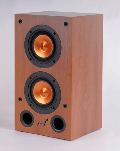

Talking of twinning Markaudio drivers:
Here's the anechoic chamber test results from work I did for an Australian company early last year. The frequency response is well balanced for 2 X CHR-70 (from memory) in a 9 litre BR with twin ports. There's no filtering of anykind on this set-up.
What's interesting to note is the relative near flat response that doesn't show any significant variations in output compared to a previous single driver anechoic tests.
This measurement was taken at 1 metre distance from the cabinet. No differential and combing issues were evident on this and other tests we ran at the time.
Cheers
Mark.
