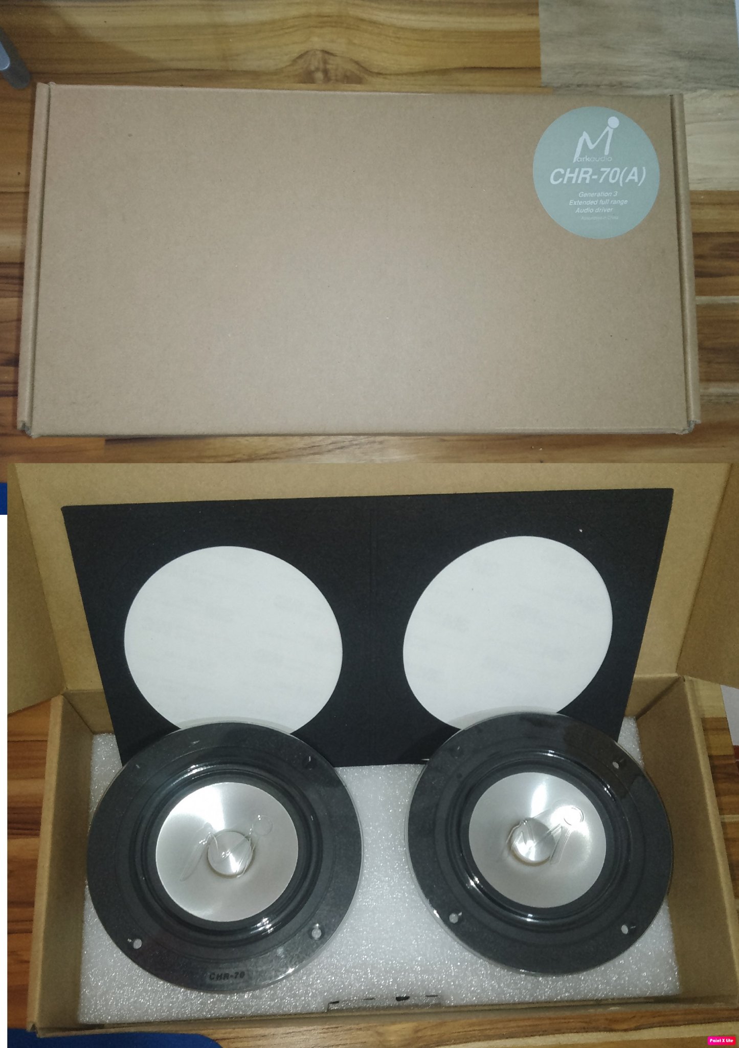

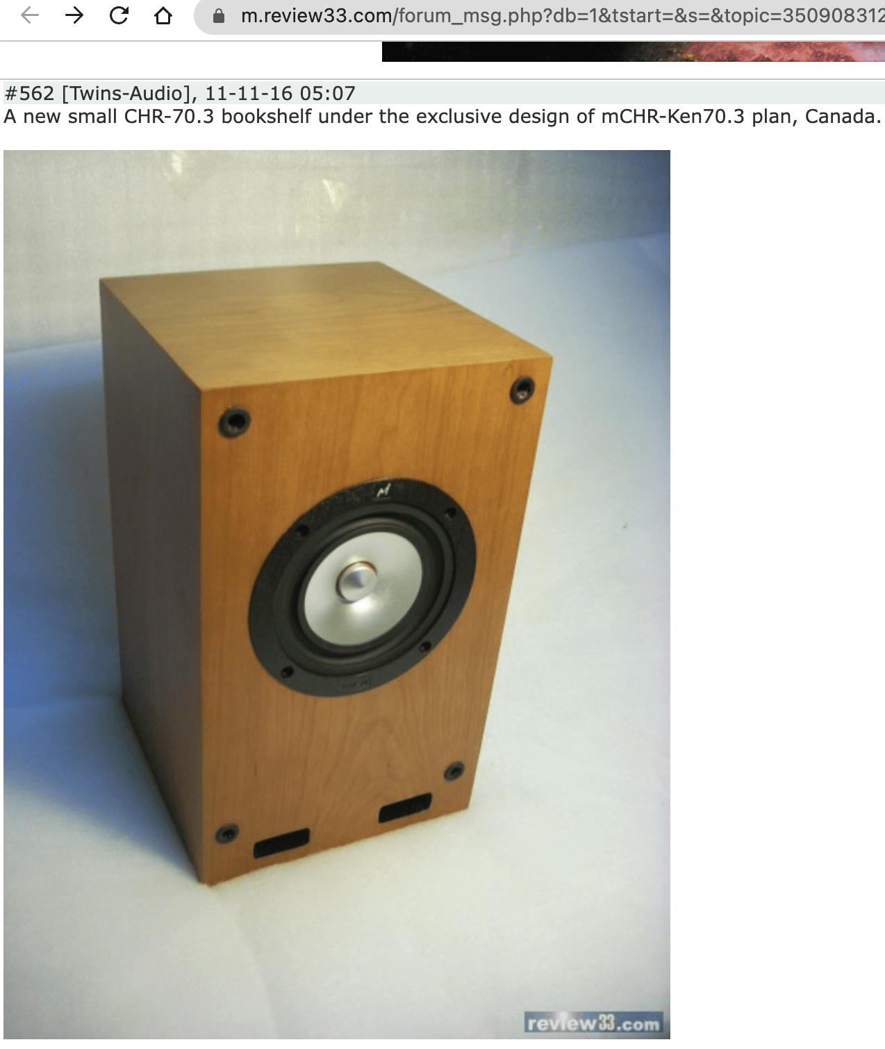

I also get a pair of CHR-70.3 , now im trying to choose the box. I would like to get a smaller/Bookshelft size box with the lowest F3 possible 🍰😏
Does any one know the FB/F3 of these box:
https://www.markaudio.com/wp-content/uploads/2021/08/Fenlon-70CHR.png
and
https://www.markaudio.com/wp-content/uploads/2022/09/CHR70.3-twin-vent.png
Also, in this second box..its smaller, i like it the most..but it could damage or change the design of the box response if i move the ports to the front wafle?
THANkS a lot
From Bogota 🇨🇴
No, it won't change the response itself if you move the vents to the front baffle so you should be fine from that POV. I'll need to double-check the other as that was Mark's design & I don't have any records of the tuning details off-hand -will try to have a look later when I'm on my main machine. Apologies in advance if it takes a little while as I've got to take the car in for its service in an hour or so, so probably won't have chance until I get back.

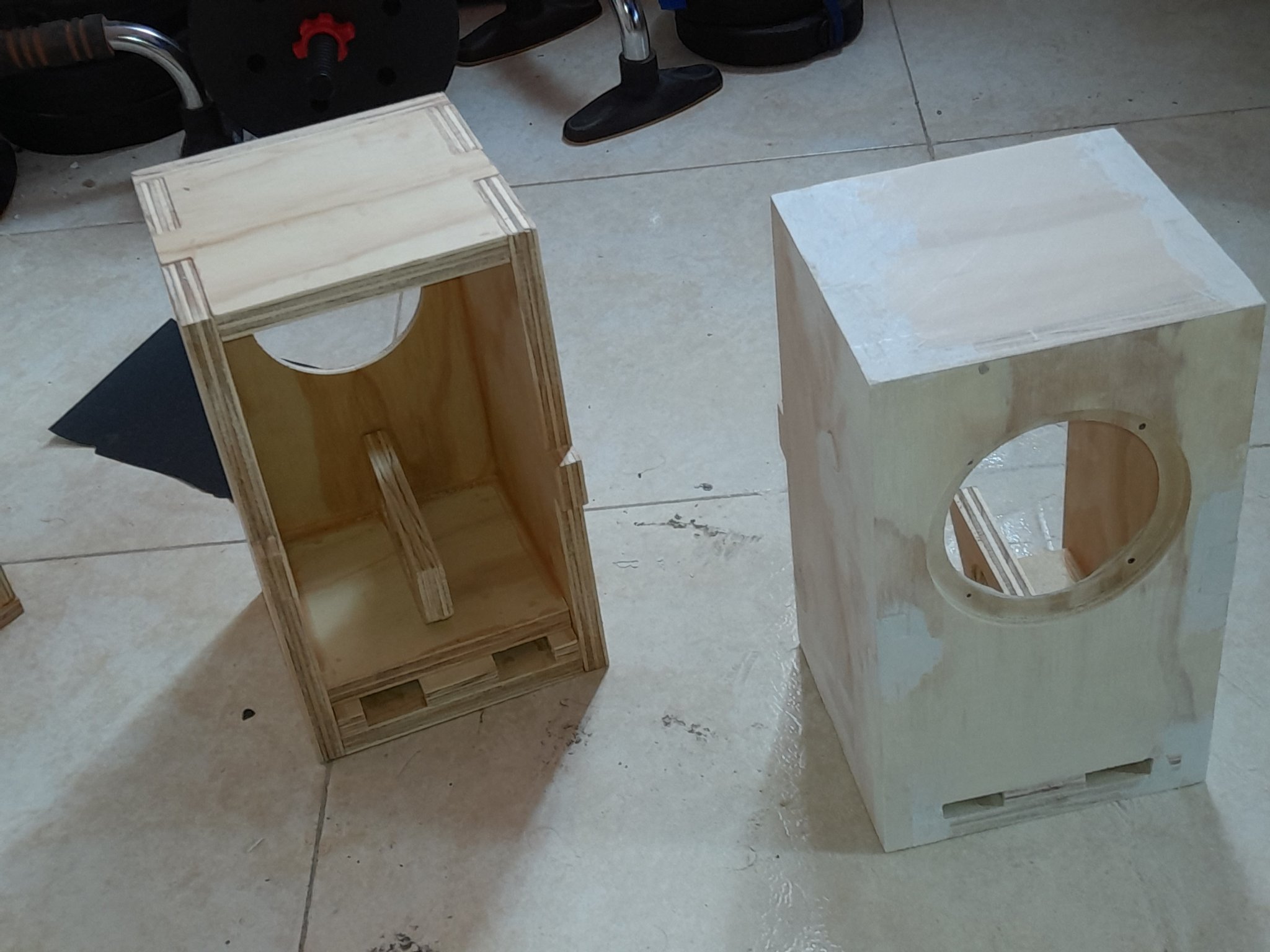

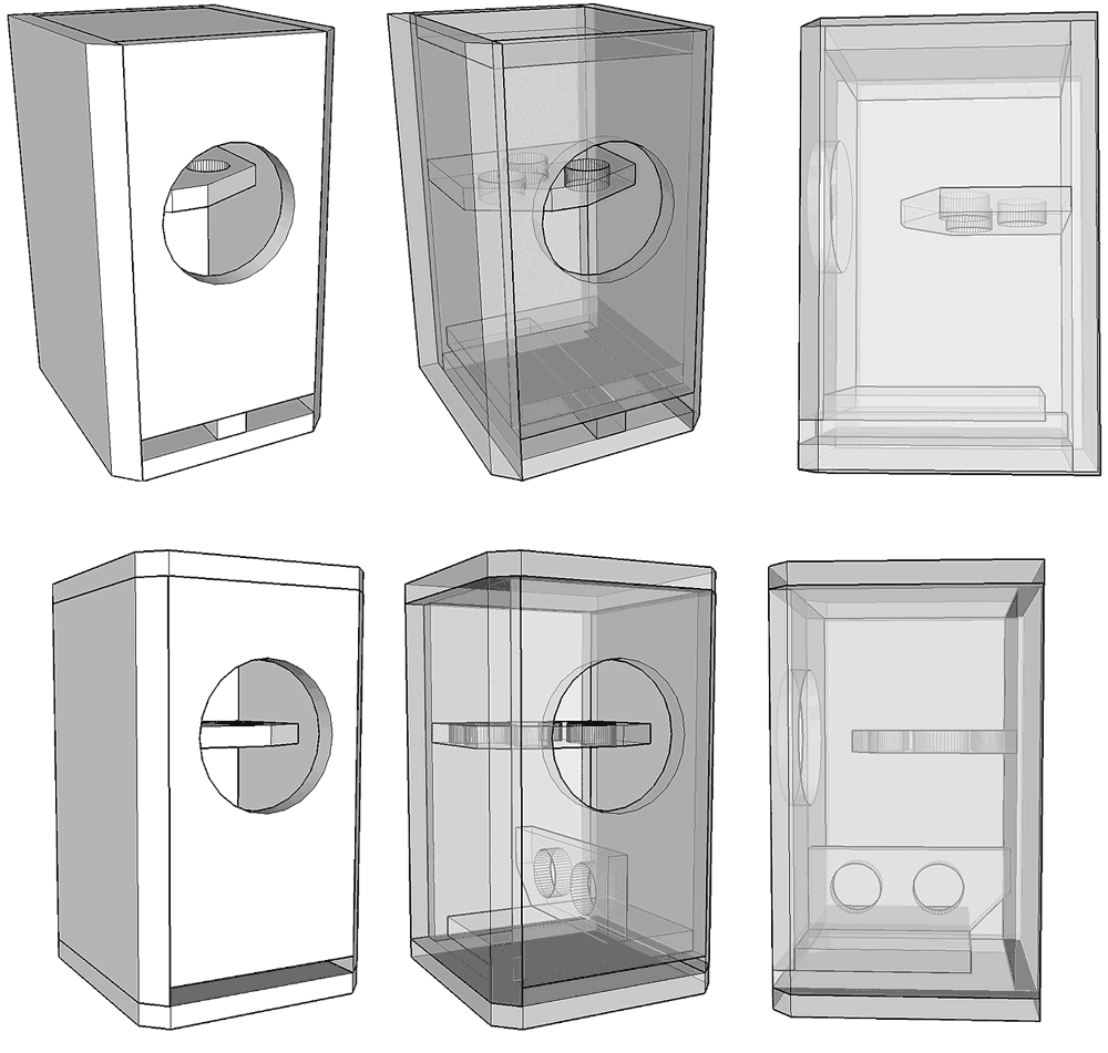

Just another question..taking advance of the famous british courtesy.. in the pdf for the twin vent box, talk about the bracing..i got the pensil 12 for the info..but that will not reduce the overall volumen of the box?..if i need to compensate, how can i do it? adding the same width as the brace itselft? 🤔

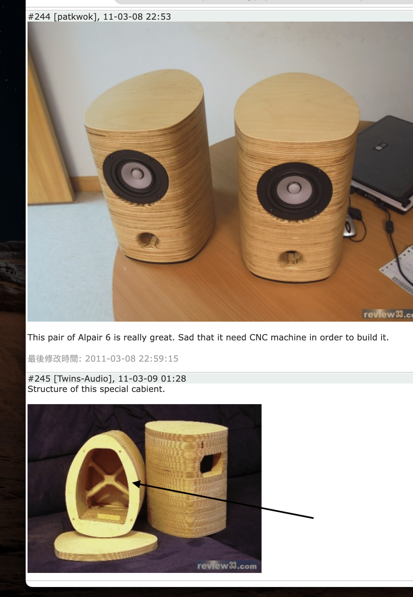

So even if I used the type of bracing in the following image, would I still have to adhere 2/3 of width? Also using this type of bracing, would it be advisable if I used a vertical one plus the horizontal behind the driver?
I just want to follow the plan in the most detailed way possible, to get the most out of it..as i dont have any way to messure the results.. that's why I bother so much with questions and details, to get the finished speakers as close as possible to the original design. Again thanks for the time.

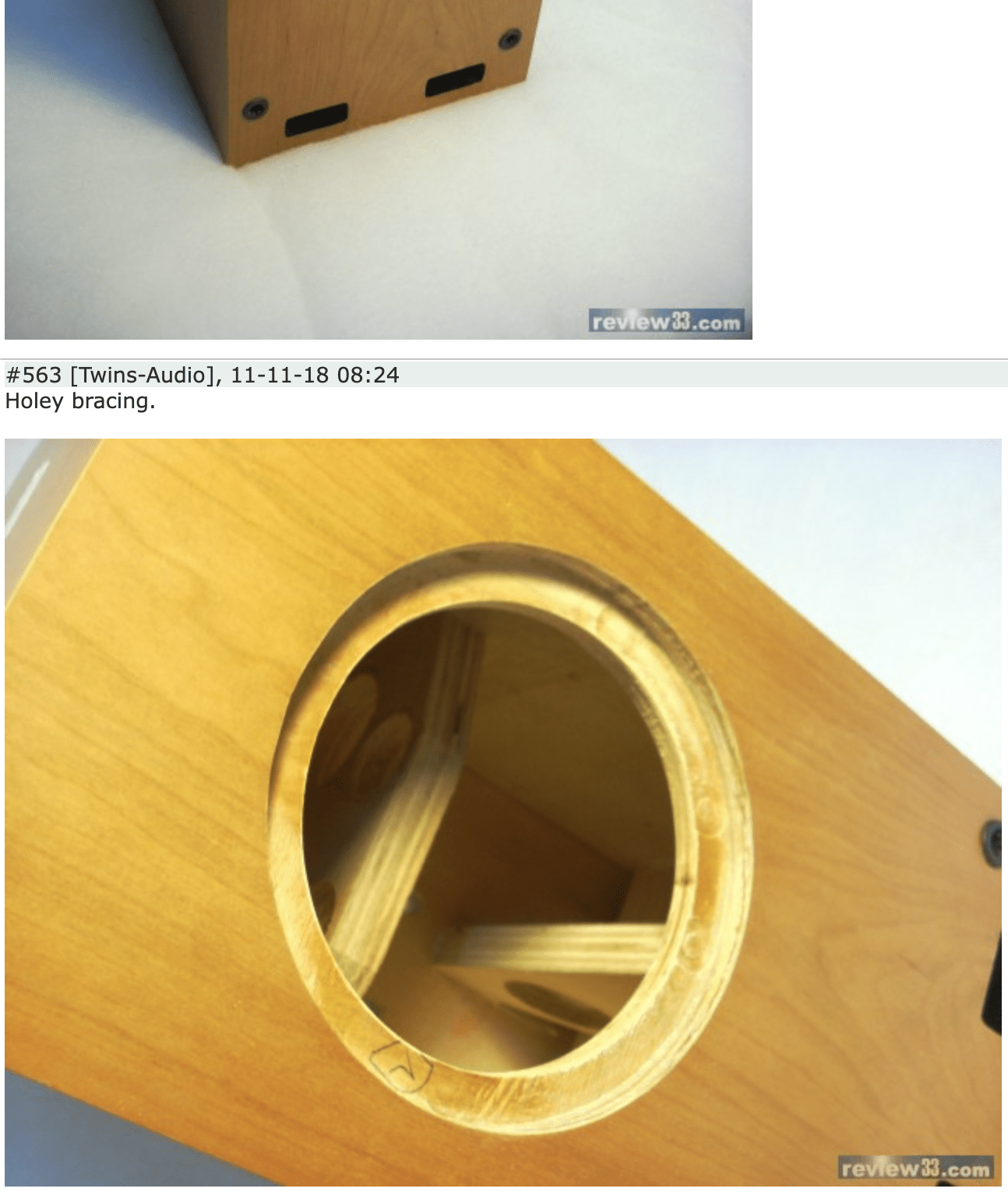

The bracing in the translam is totally ineffective, it only braces the lam that it is a part of. Translam is also very wasteful. I have yet to see anyone fit a proper brace to a translam.

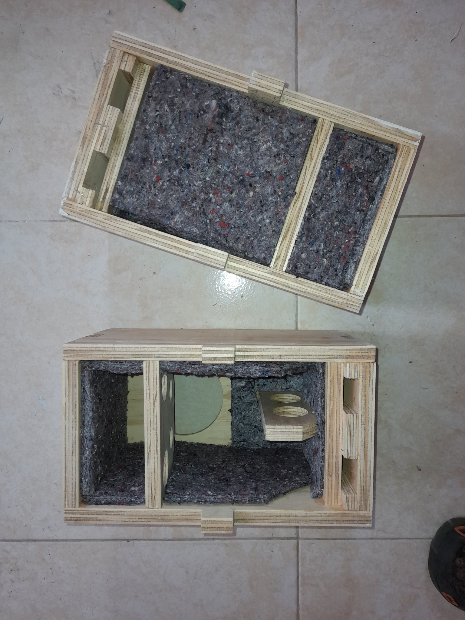

The 2nd is either mine or a copy of my bracing scheme for the milliSize box. Here is an early visualization on the top and the 1v1 version on the bottom. This brace breaks one of my primary bracing rule, but i really needed to brace the sides. The first builds showed this to be inadequate so we added the one from baffle to back just on top of the vent shelf.
Taking it to overkill one would do a vertical holey driver brace and then 4 stubs imitating a side to side one (open right behind the driver).
Rule 1 of bracing (and the one i broke): The subpanels created by a brace should have higher aspect ratios than the panel that is braced.
Rule 2: The subpanels should have dissimilar aspect ratios… don’t put it dead centre.
Rule 3: Tieing all 4 sides together is desirable (ceates an i-beam)
https://frugal-phile.com/boxlib/P10free/CGR-dCHR-Ken-301113.pdf
The wide one has good bracing, the narrow could really use some side to side stubs.
dave

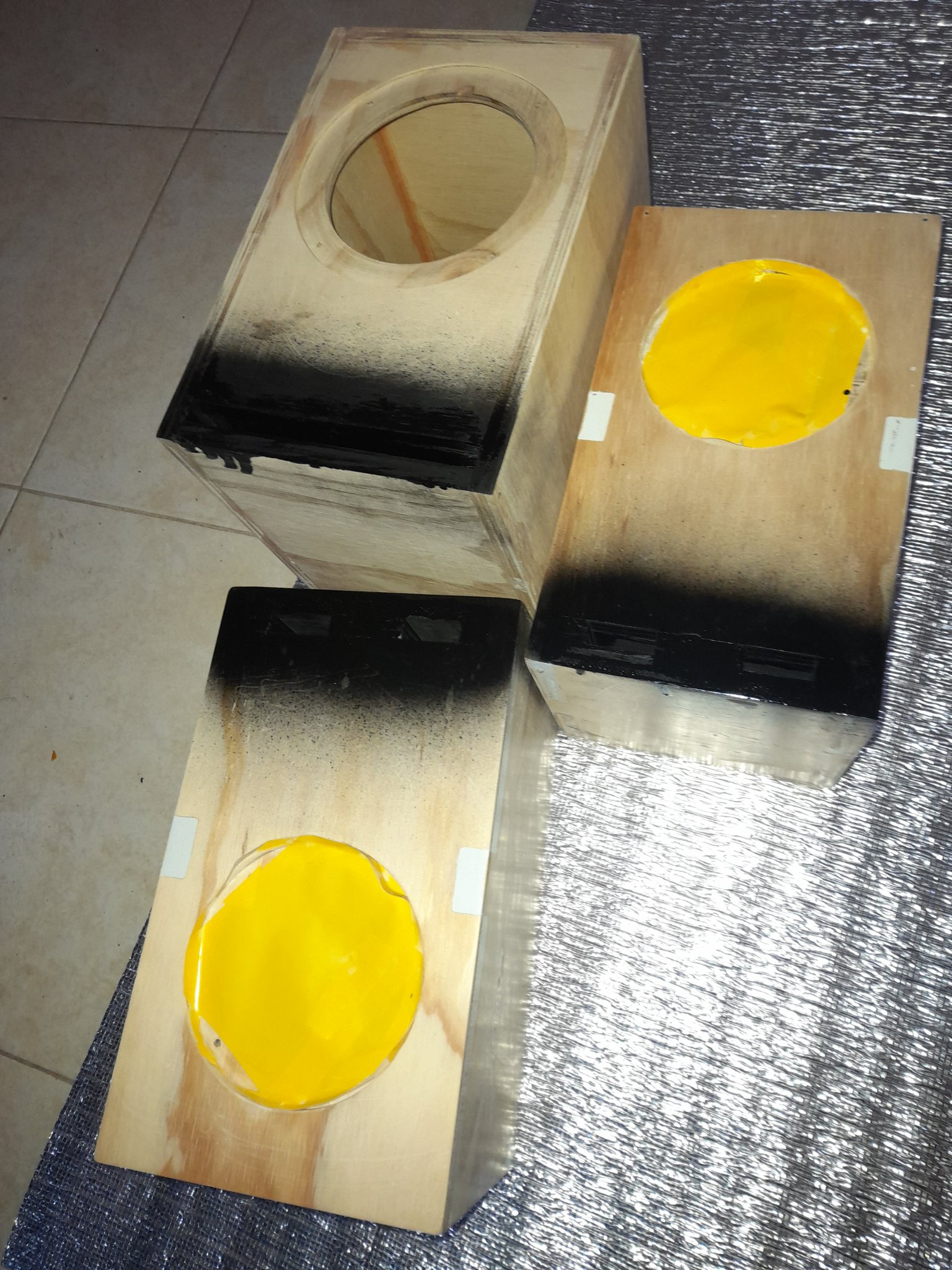

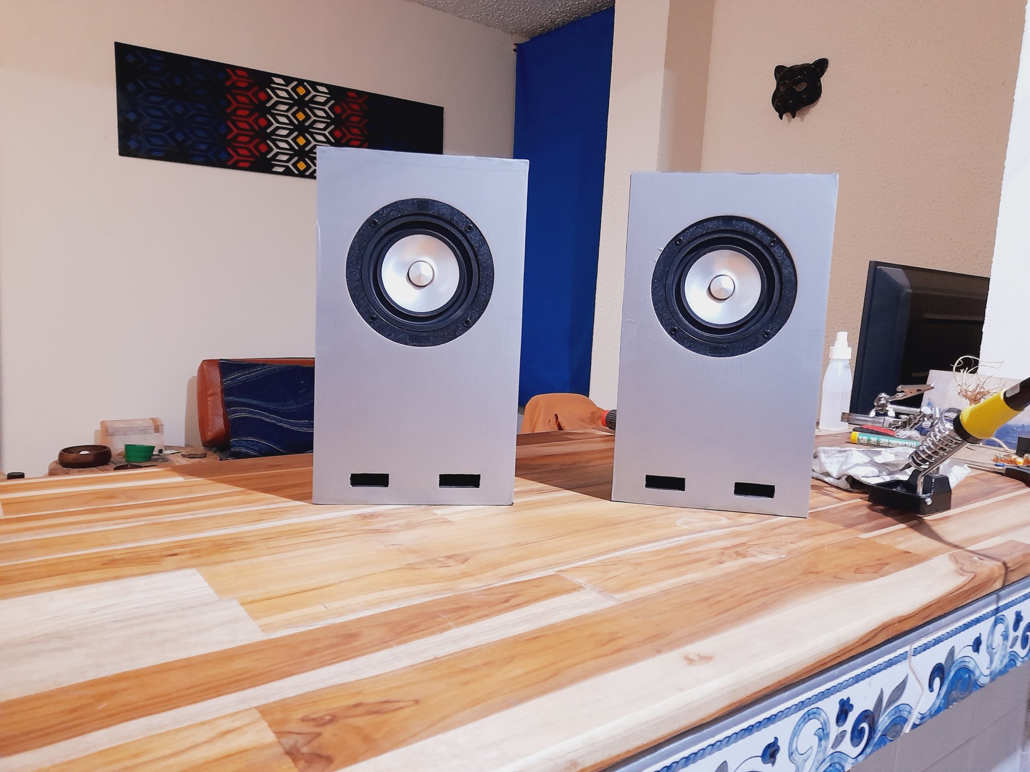

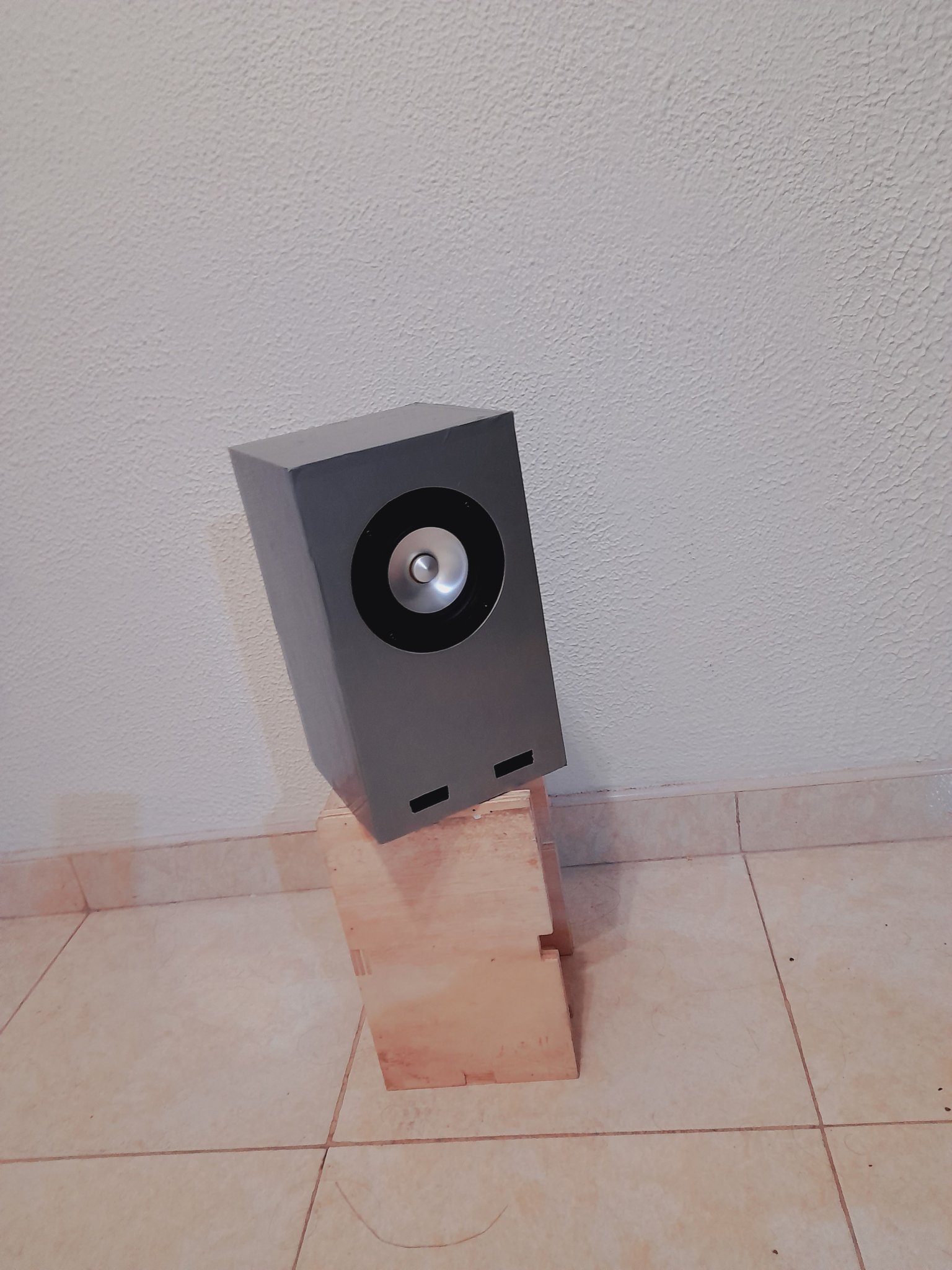

Took me some time but...🤓 done already.
Thanks to Scoot and Dave for the box design, next build will be some Okapis for 7ms.
