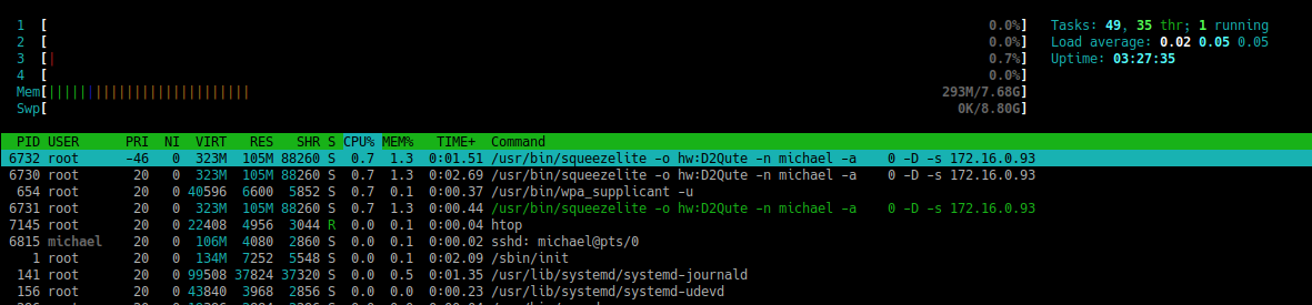

Also please look and post your CPU utilization for PCM and DoP. What CPU do you use?
Intel(R) Pentium(R) CPU 4405U @ 2.10GHz
https://www.cpubenchmark.net/cpu.php?cpu=Intel+Pentium+4405U+@+2.10GHz
I have an idle time of more than 99% , if I take a look into /proc/uptime
12254.66 48633.91
It gives me
((48633.91/4)/12254.66)*100 = 99.21 % idle time, so the system is sleeping and it does not matter if I play DOP or not..
This is my current htop.

CPU load on this laptop Pentium(R) CPU 4405U if always < 1% so idle is >99%.
