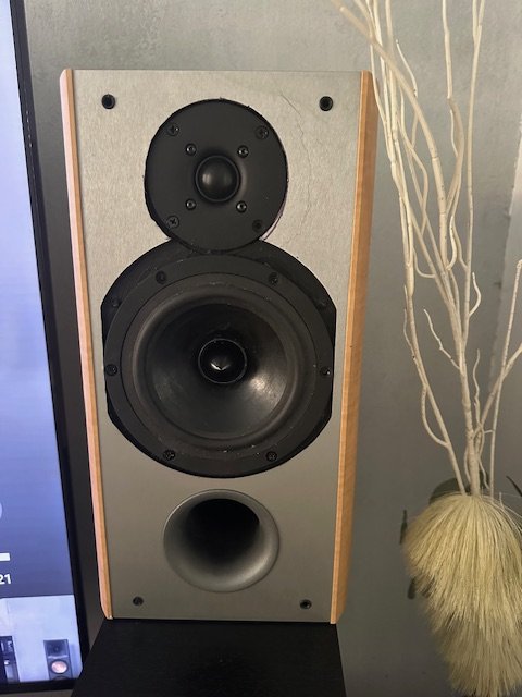

Thank you all for your advice, much appreciated. I have pretty much completed the Job and the SB Acoustic tweeter blends perfectly with the Dayton, though the Dayton woofer could use a little more volume, so I am not sure what to do there. I'm happy with the sound overall, especially the clarity. Would you guys recommend updating the woofer and tweeter capacitors?
I managed to find a neighbour that had a router, and he was kind enough to do it for me. However, it's not a perfect circle so it's not the best to look at, but the sound is a little better than i expected.

In the words of my woodwork teacher in Year 9, "fill it up with putty" (!) - but plasticine would be better.

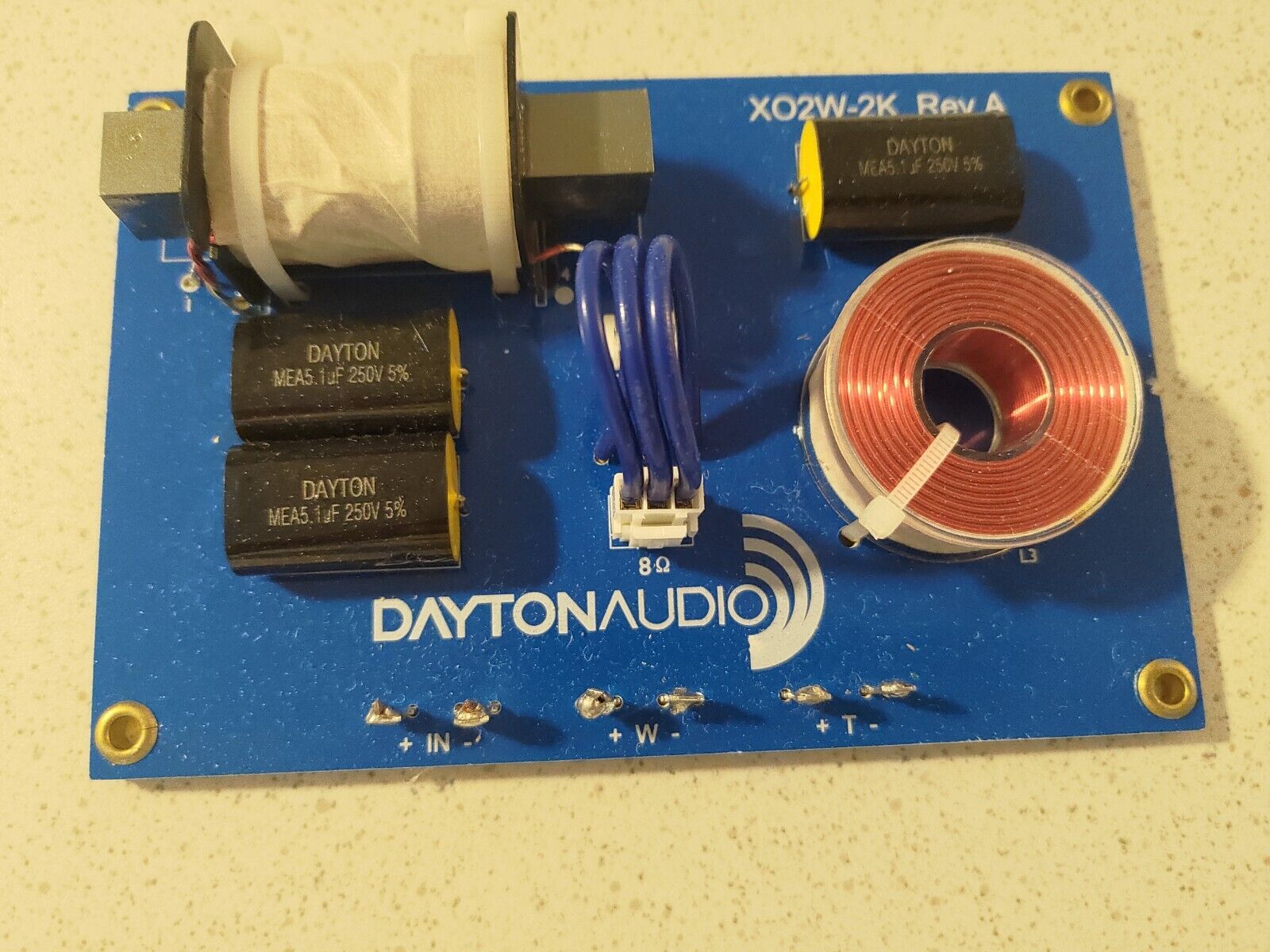

No point. The dayton woofer is lacking volume because the premade crossover has the wrong values to allow for baffle step compensation. So replacing like for like values with more expensive inductors or capacitors will only empty your wallet.
Your best options to move forward in sound quality are the ones I previously outlined.
I don't pretend to know what I'm doing, but I recently had reasonable success in designing a new crossover for a Peerless SDS160/Vifa BC25 build.
I don't have measuring equipment and didn't model baffle diffraction etc as described above by Dave B - who obviously knows much, much more about this stuff than I. I used Xsim and tried out a few different values - particularly the woofer inductor and tweeter resistors - from my parts stash.
I suspect that trial and error, plus luck, contributed to my project working better than expected, however, I'm sure it could be improved with Dave's methodology. I'll have to try and work out how to include baffle diffraction effects in my Xsim model.
It's not possible to see the parts values in your Dayton XO and they're n/a from Dayton/Parts Express. I had a schematic some time ago when I'd thought of using that same - lucky for me I didn't - but I recall that the parts values were the same for the tweeter and woofer, which simply won't work. Not just for Baffle Step Compensation, but the RS180P has some nasty peaks above about 3000 Hz which must be suppressed in the crossover or they will really bugger up the sound.

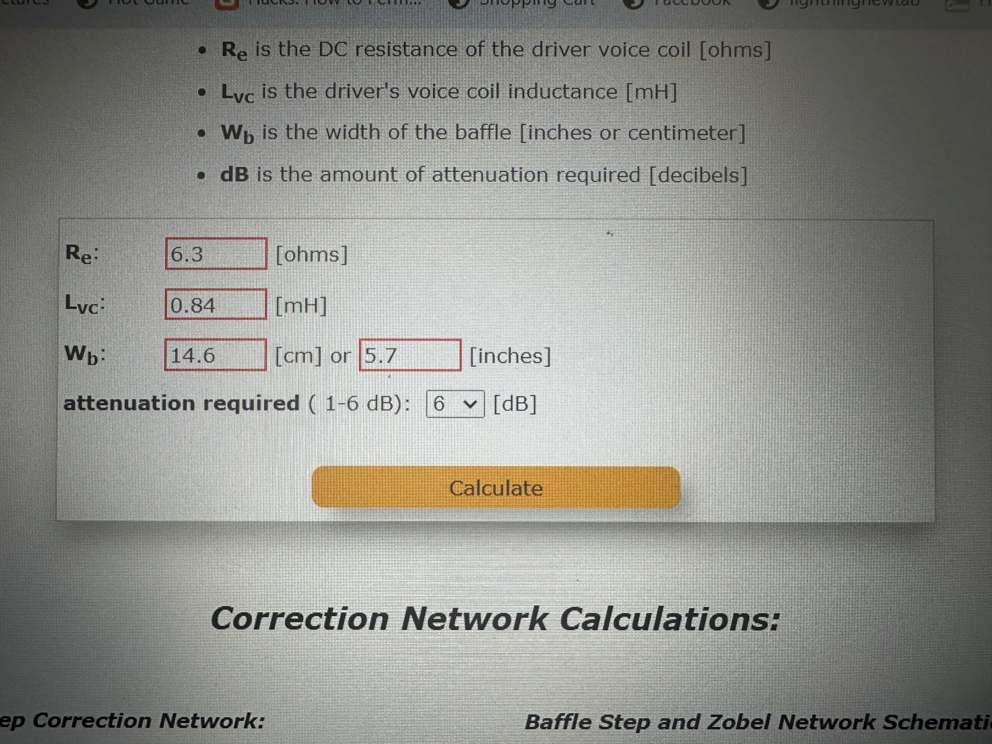

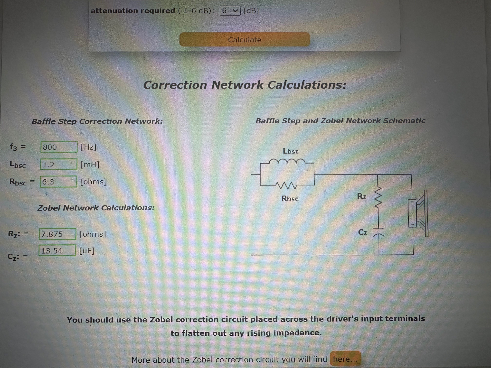

Ok - I don't recommend on-line calculators. A well designed custom crossover often avoids the need of a zobel circuit (because the other components make the changing impedance irrelevant). On line calculators "need" a flat impedance for the calculated crossover point to work. the other problem is each calculator only takes into account the single driver and not the other driver. I won't get into the discrepancies, other than when you put the 2 crossovers together (tweeter and woofer circuit) you may not get a nice "blend" around the crossover point.
How wide is your baffle? You've used a baffle step F3 of 800Hz. I estimate your baffle will be say 20mm wider than the RS180-P on each side. This results in a 220mm wide baffle (driver being 180mm) and therefore for a metres based calculation, F3 = 115/0.22 = 522Hz not 800Hz. You may not have enough baffle step compensation, meaning the lead inductor (1.2mH) is too small a value.
