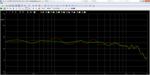

Duly noted, but check these two measurements of distorion for the same woofer:
PEERLESS HDS-P830869 (Woofer 8", 8 Ohm, 120 Wmax)
Peerless 830869 | HiFiCompass
The difference is too big. If measurements at Dibirama are off by 5 or 6% at 40Hz, then it doesn't look that bad - if we calculate that in.
It's CLIO THD.. I don't think it's that far off.
I do think that CLIO is a bit higher than reality though, just as I think Soundeasy (from a several generations ago) is bit lower than reality.
I'll take HiFiCompass's measurements any day over Dibirama - not THD, not Clio, while having also having varying level and segmented near-field and far-field results.
