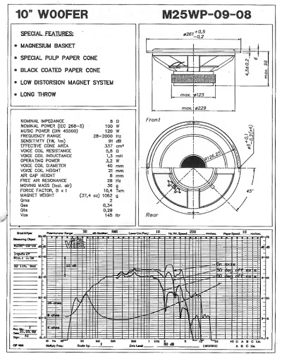

To answer BR or TL, I'd swing TL as I'm testing one currently. Properly designed the lower impedance peak is greatly reduced and without the sharp phase swing tht occurs in all BR designs below port frequency. The reason for this is that the length of a TL tunes the enclosure with very minor influence by the port whereas BR is tuned via Helmholtz Resonator.
An example would be the MLTL sub experiment I'm working on. Can change the port from none, which is a port e.g. 2.9" ID x 1.5" L (baffle thickness) to 2.5" ID x 4" to 2.5"ID x 6" and the Fb changed 1Hz lower, that's it. Actually the only thing that did change was the Q of the port, longer port higher Q, up to a point. For giggles slapped a 2.5"ID tube 42" long and took a few measurements, even stuffed some polyfill to see the effects it had. Hey you'll never truly know without cuttn some wood, build and measure. 😉
Dampening the line also affects tuning, getting this part right is very tricky and is integral to the design. The end result can be very impressive, tho not done by a long shot in my testing can say that being able to hit 18Hz with a little 6.5" is rather impressive without needing EQ. In fact the driver is so well dampened on the low end have decided that no low freq filter will be required to prevent over excursion. This is where a BR falls flat on it's face.
Sorry, I should bring in that this is the same speakers that I bought of fleabay for £200, there's a lot of work to do on them - see my other thread

Think you intended to say the red line is the port and the black line is the driver. 🙂Qts is not the only parameter of interest when picking the box type to be used.But Qts is an important one so to give some rule of thumb (that works most of the time but may have some few exeptions)
The classical Qts for bass reflex drivers are 0.35 so drivers in the 0.3 to 0.4 work well with classical bass reflex tuning. They also work well in pipe resonanators such as TLS and Voigt pipes. With higher Q than 0.4 bass refex boxes need to be larger fraction of Vas so exept for drivers with small Vas the drivers in the 0.4 to 0.6 range tends to be used in closed boxes.
With Q above 0.6 the drivers either is used in a box with a bass peak (there are ways to tame this) or in open baffles.
Well below a Q of 0.3 say 0.15 then the drivers are used as horn drivers or midbass drivers well above the Fr.
The Vifa drivers Qts of 0.29 will be nudged slighty higher by the serial resistance of the coil(s) of the crossover.

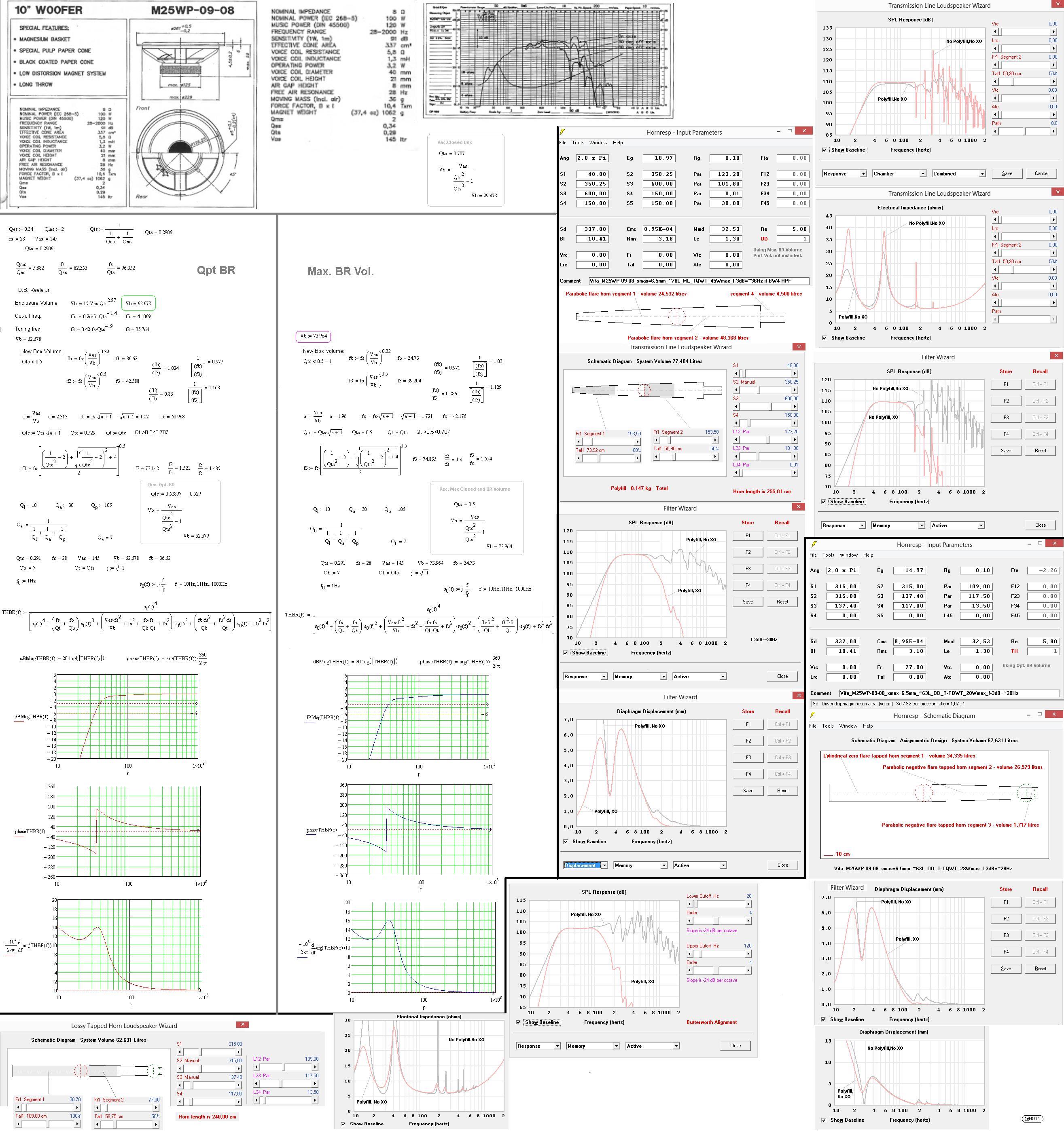

Below is the response of a low Q driver in a TLS. black is pipe output of a pipe with no damping material. Red is the driver at 35 Hz there is driver response dip, minimal output and pipe peak (black). A bass reflex has a similar thing with driver dip and port peak output. The trick is trying to keep the 35 Hz peak that is wanted and at the same time reduce the harmonics at 150, 270, 350 Hz by smart use of folds and placement of damping material.
Bass reflex and "transmission line" are really one and the same, just at opposite ends of a continuum in terms of port dimensions. A conventional BR can be designed and the port can be progressively lengthened and area expanded (to keep the same tuning). Small signal performance will hardly vary (or can be held constant with Bl changes). As the port gets longer/wider the large signal performance improves, so freedom from port noise is achieved but the port length resonances drop in frequency and become more problematic.
The fundamental resonance of a TL is determined by the mass of air in the port and not tied to length. All the upper resonances are length determined.
Finally, determining TL length to match woofer resonance, i.e. 1/4 wave tuning, is no more proper than tuning a vented box to match woofer resonance (the discredited method used before Thiele wrote his paper). Like a BR design a TL design must have the proper box volume and tuning to match the parameters of the woofer.

I get different results for the same type of changes
I was intrigued by your experiments in changing a port's length and wanted to see if I would have similar results. Modeling with a 10" woofer (Seas CA26RFX), I set up an ML-TL for reference. It's 60" long with the driver at the 1/3 mark and the port at 10" from the other end of the line. With a total line volume of 5.35 ft3 and 3"-diameter port 0.75" long (i.e. wall thickness), the system tuning frequency was 30 Hz, f3 was 28 Hz and the overall response is flat from just above the knee in the curve to 1 kHz, with a mild depression from 100 to 300 Hz. After increasing the port's length to 1.5", with no other changes, the system tuning frequency became 28 Hz, f3 was 27 Hz, and as would be expected, the overall response is starting to shelve down. Last, increasing the port's length to 3" shifted the system tuning frequency to 23 Hz, f3 to 33 Hz, and the response now looks much like an EBS alignment. Oh, I modeled with the first half of the line stuffed at a density of 0.75 lb/ft3.
This is entirely a modeling exercise with Martin King's worksheets, no actual building or measuring, and it may be somewhat of an apples and oranges comparison, but it does cause one to wonder. Not necessarily doubting your results, but I don't understand how what you describe could occur. Maybe I'm not understanding completely what you did and what you stated?

Heya Paul, that's the odd thing, models do show a change but measurements show no difference. I intentionally designed this shelved eg instead of Fb at Fs of 40Hz, set this to 35. Am trying to explain to myself the differences between reality and what Leonard Audio Transmission Line software. For one LATL shows no change in tuning regardless of dampening. This is an obvious error. With that said, upon corresponding with Peter showing the results vs model due to a mistuning. This lack of dampening correction lead to an Fb of 27Hz. Retested with less dampening, Fb shifted higher, finally reading through bjorno's posts used Ikea pillow stuffing and followed his suggestion. This resulted in an Fb of ~32. Much closer to the model.
The original design used a slot port with an area of ~25cm² with a 3.8:1 aspect ratio (was actually 3.8" x1") and a depth of 3.25". This caused a very high port noise level and was suggested by Peter to use a 3"ID port. Seemed a bit overkill for a 6mm Xmax 6.5" so went with a 2.5"ID port x 3.75" and added a 3" precision port as the port is not terminated to a baffle ie external and felt a little end correction wouldn't hurt. Same result, might have changed 1 Hz but within measurement error. Then decided to change port again as I made it be easily swapped out. This time to a 6"length w/ same ID, no change. Lastly I removed the port and left only the hole in the baffle. This is 2.9" ID x 1.5" (baffle thickness), again no change.
Once that was all done went on to test various dampenings, all of which showed a marked change in tuning. Far more so than expected quite honestly. Will say the microfiber towels are extremely effective without flow loss. Sadly far to much for my needs, am storing that away for future reference 😉
The highest Fb to date is with bjorno's method. Unstuffed it's ~34.5Hz and almost spot on to the model, albiet the model shows it stuffed like in the first test Fb27 and other oddities that are simply not there. Need more tests for sure, another test enclosure is on the drawing table. Perhaps this weekend early next week. Weather looks good 🙂
http://www.diyaudio.com/forums/subwoofers/250902-interpretation-results.html
What I've found about dampening, which I assume you mean the effects of stuffing, if the stuffing is confined to no more than the first half of the line, there is less effect on system tuning and f3 over a moderate range of stuffing density. But, stuffing added beyond the halfway point has significantly greater effect--a whiff of stuffing in a terminus, for instance, will really kill f3. For stuffing, I've used Acousta Stuf, Polyfil and bonded Dacron from Meniscus Audio. When weighed or cut correctly and installed correctly, I find the actual system tuning agrees well with that modeled, but frankly, if they differ by a couple of Hz, I probably wouldn't mind. I prefer to use round ports for an ML-TL, but have no problem using a rectangular terminus for a tapered TL as long as the aspect ratio is not more than 5:1.
