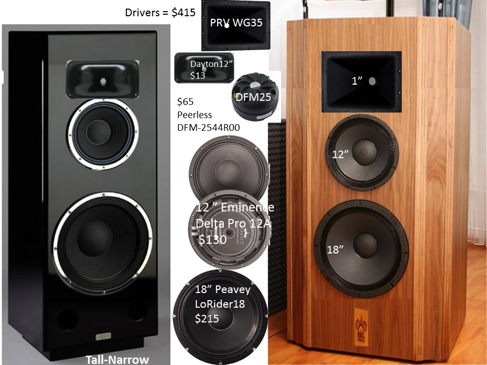

You can purchase excellent BIG, big room speakers for around $400/speaker. 18" woofer + 12" midrange + 1" compressions driver + 1" controlled directivity waveguide

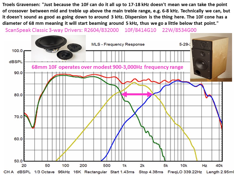

The ScanSpeak 10F/4424G has a 68mm cone diameter, 20W max power, and sealed box T/S parameters which favor a crossing over 500Hz. Not an ideal BIG room midrange.
Troels Gravensen: "Just because the 10F can do it all up to 17-18 kHz doesn't mean we can take the point of crossover between mid and treble up above the main treble range, e.g. 6-8 kHz. Technically we can, but it doesn't sound as good as going down to around 3 kHz. Dispersion is the thing here. The 10F cone has a diameter of 68 mm meaning it will start beaming around 5 kHz, thus we go a little below that point." Troels uses -3db @900Hz -to- 3,000Hz for the ScanSpeak 10F

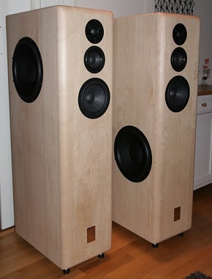

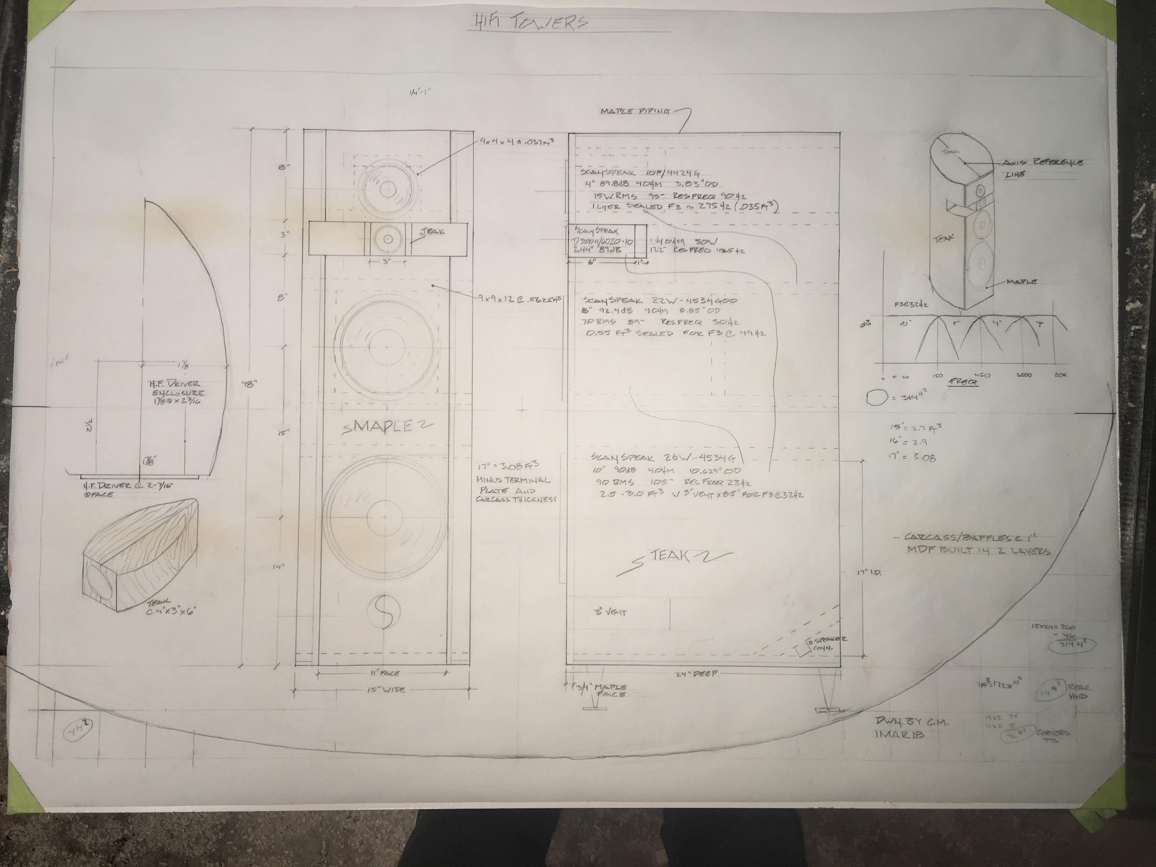

I designed a round sided cabinet to eliminate parallel sides but Ive never heard about cabinet edge defraction other than tweeters being treated with felt. I shall round the face as much as the drivers will allow. Easy to do. Its 1” Maple. I figured the mid was a bit under sized (SPL) and was considering the Audax 100dB but will look at this Satori people have mentioned. I simply cannot wrap my head around how 2 8” drivers could get the range that a 8” sealed and a 10” ported could, however. Although I will be using 8ohm on the 8 & 10 as a result of earlier discussions in this thread. Not sure why yet, but I will. I honestly think I will use the 10” to about 20-70hz. Almost never. I just see my existing (Sony) towers with double 8” xo’d too low and thought I’d give this 8” a little releif and, as a sealed driver, ability to punch a little when needed.

Well, from what I have read, the higher the frequency, the more one needs to consider diffraction when designing the faces and edges of a cabinet. I think, for my purposes, a few tweaks on my original cabinets will work just fine (I had yet to update the new drivers when this photo was taken). Basically beveling the 1" Maple face plinth, but notice there is very little flat surface anywhere to begin with as the cabinets are columns with a truncated ellipse cross section..
The HF drivers are in a teardrop shaped hardwood puck, the 6.5" MR sitting on top. Below is a sealed 8" for tight LF and below that is a 10" ported, for 100Hz and below.

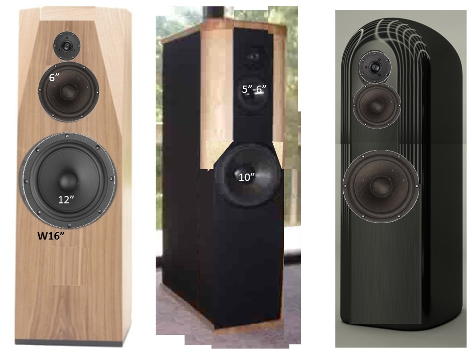

With your current study of a 5" - 6" midrange, your DSP multi-amp design could shift to two sealed volume 10" woofers. Have you completed any low diffraction 3-way cabinet sketches?
Proven Avalon style cabinets are well constructed rectangular boxes with a THICK baffle to support clever bevel cuts. Constrained layer dampening can even be used on the large flat panels. With DSP, no baffle slope is required. Some DIY'ers with limited wood shops have been bevel-successful with hand saws. The top truncated pyramid is well defined, but bottom edge bevels are optional and can reflect your style. Since the bevels are confined mainly to the top section, the cabinet can be small-radius narrow around the 10" woofers.
If you favor round radius edges, you can keep the bottom woofer section of a basic box cabinet narrow by tapering the top larger radius rounds into soft edges around the woofers. A temporary ramp on the side of the cabinet can taper the round-over router cut.

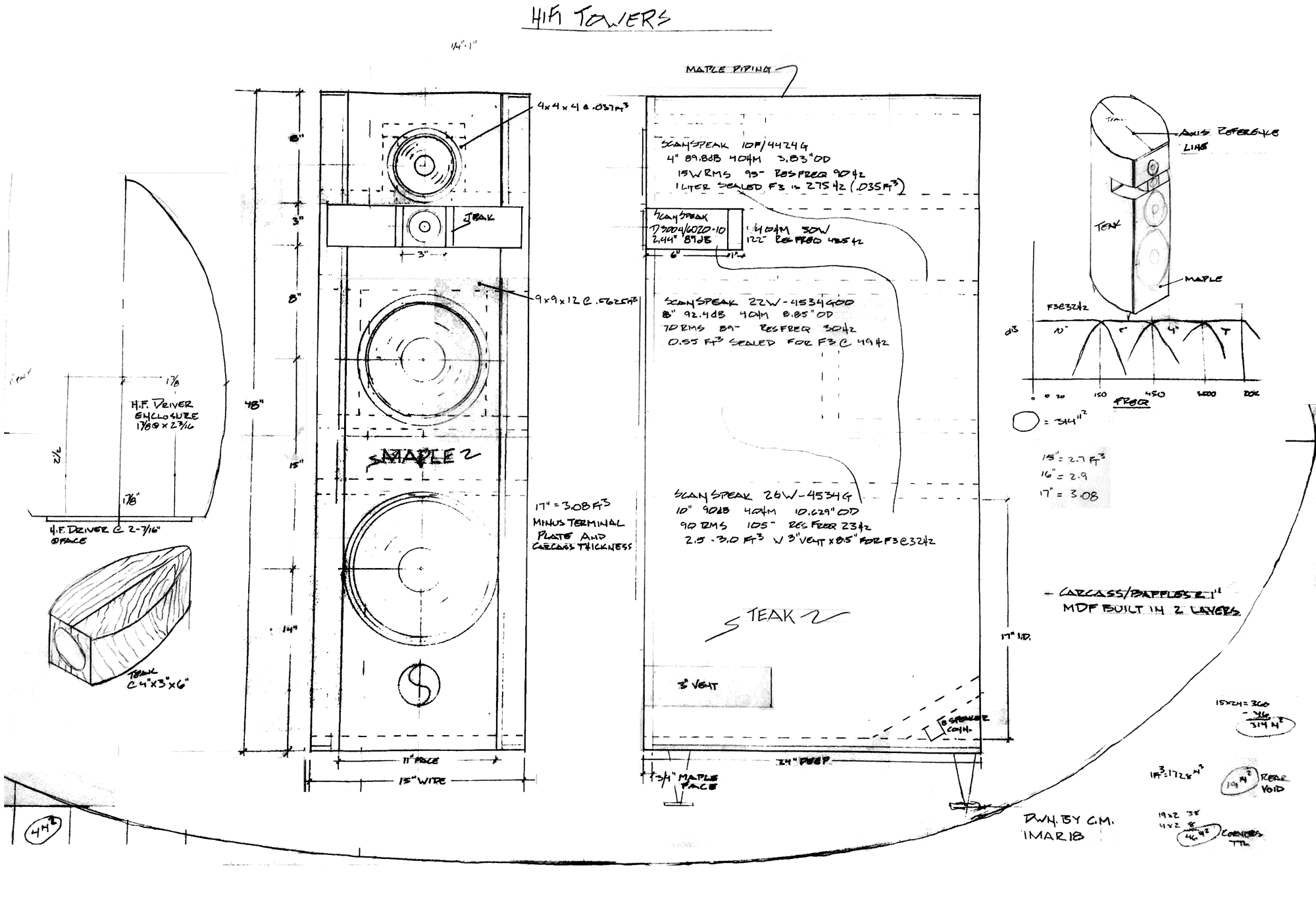

Well, from what I have read...
I have cleaned up your drawing a bit… hopefully more readable (certainly a dramatic reduction in file size).
One comment: you will be investing a significant amount in drivers, why compromise the build be using MDF?

Have you sketched any new low-diffraction cabinets which use the solid Maple you have collected? I agree with you that large-rounds just on the top-left-right edges around the tweet+midrange only above-the-woofer, and blending this into shallow-rounding the lower (plywood) edges next to the woofer is a worth a sketch-up. With good internal bracing, curving the side panels is more for appearance than for resonance performance. If you can accept flat side panels, you might also consider gluing MDF + Plywood for layer dampening. HEAVY.
American Icon. If I had a CNC I'd explore milling out the top rounds of the Juke-Box style cabinet, and use flat panels with large-to-small tapered edge rounds below.

"why compromise the build be using MDF"
The use of MDF is a compromise, but in acquiring the shape, "wrapping" a form with several layers of thin MDF seems easy, free of air voids, dense as lead. With an exotic wood veneer, the whole project would be averse to high humidity. I have access to Oak and Maple. Im just not to hip on rectangles. I may switch the build to laminated 3mm Lauan sheets with exterior adhesive.
