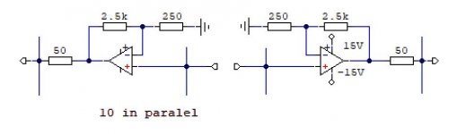

This is the measurement. The noise of the op-amps matches the datasheet spec. I haven't listened to these amplifiers. They were used for measuring purposes only. This gives me an idea to connect a pair of headphones and to take a listen.
BTW - the schematic used to measure the spectrum above is attached.
