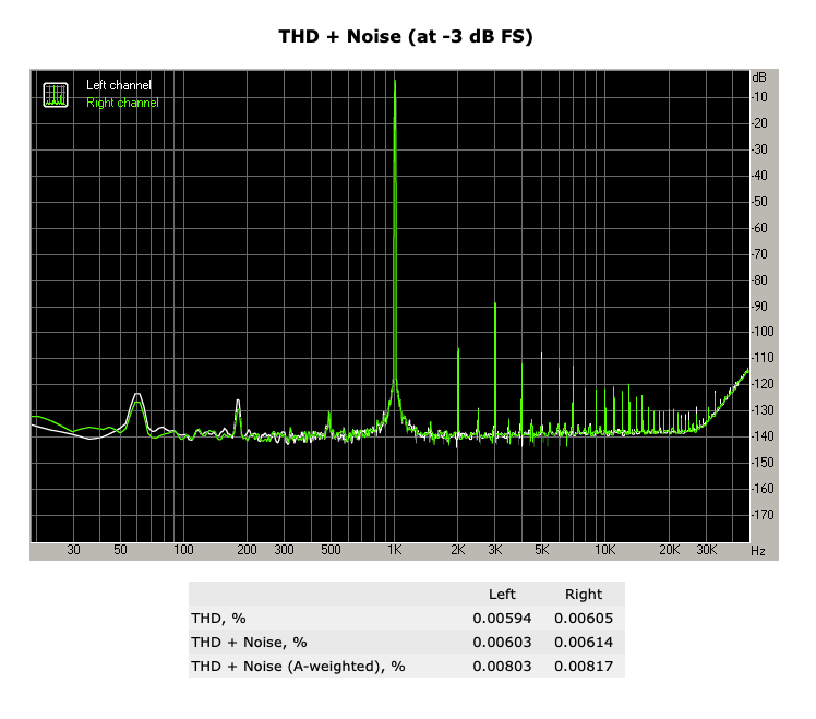

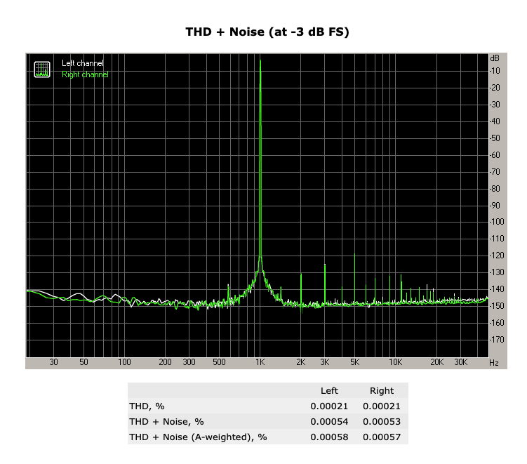

Here are the screen shots of RMAA THD+N.
Symphony ADDA Loop
TLE2074DA to SYmphony AD
OPA1644DA to Symphony AD
Symphony ADDA Loop

Sorry it took a few days to see that. Looks like the harmonic spectrums are different with the different opamps. That's despite computed THD coming out about the same. Makes it easy to see why THD and or THD+N are not considered to be very useful metrics. For one thing they don't say enough about the exact harmonic spectrum, which is something that matters for perceived SQ.
Of course what is shown in the pics is only one frequency and one signal level. Its a snapshot of differences at one operating point but that's about it.
Contributing factors are noise and PSRR. 164x is better in these respects, including a flatter input capacitance vs frequency. All affecting dynamic performance.

Thank you for taking your time to look at them. I'll measure them again at different levels.
PS: One question, can you guess what is the cause of above 30K noise?
Looks like it could be sigma-delta dac noise shaping. Such dacs generate a lot of switching noise. A DSP filter type of algorithm called a 'modulator' shifts the noise up above audio frequencies so it can be more practically filtered out. Sometimes it isn't filtered enough and then can cause problems in downstream equipment.
