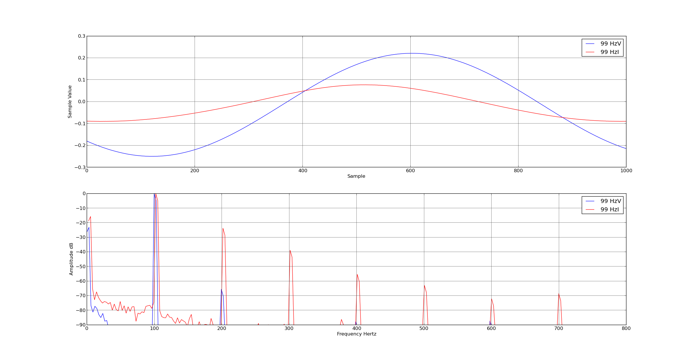

Stick a resistor in series with your speaker to measure current, play a sweep, measure THD on current using your favorite software. Attached is my desktop speakers at 100Hz, don't remember the amplitude:
THD on current drawn by woofers is ridiculously high. The harmonics of current drawn by the woofer will create a (distortion) voltage on the cable according to its impedance, and the whole loudspeaker will reproduce that distortion, since from the speaker's point of view, it's voltage on its terminals, therefore it is signal, and it is its job to reproduce it. If you use bi-wiring then at least the tweeter won't reproduce the harmonics created by woofer current over shared cable impedance...

interestsing point. Assume 8ohm speaker and 0.8Ohms cable resistance, inductance neglected and the added H2-distortion of 100Hz would be in the ballpark of 1%. The higher harmonics drop to 0.1%. Do you think this is something contributing to audible distortion produced by the tweeter?

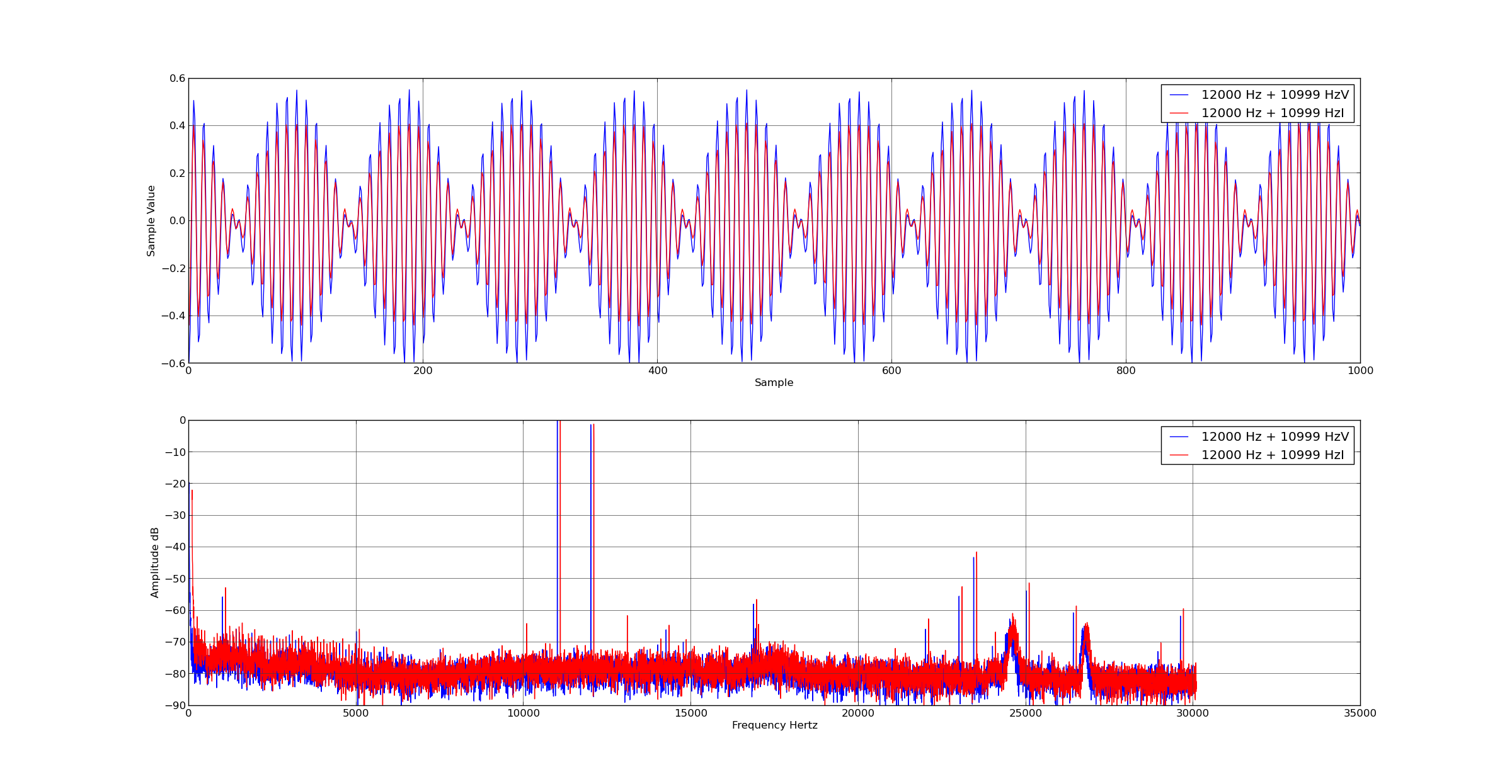

bucks bunny> It's possible...
It works both ways. 11+12kHz intermodulation in the tweeter and its crossover produces 1kHz distortion which will be reproduced by the woofer too.
If you would not always speak in mysteries then maybe we could learn something...
