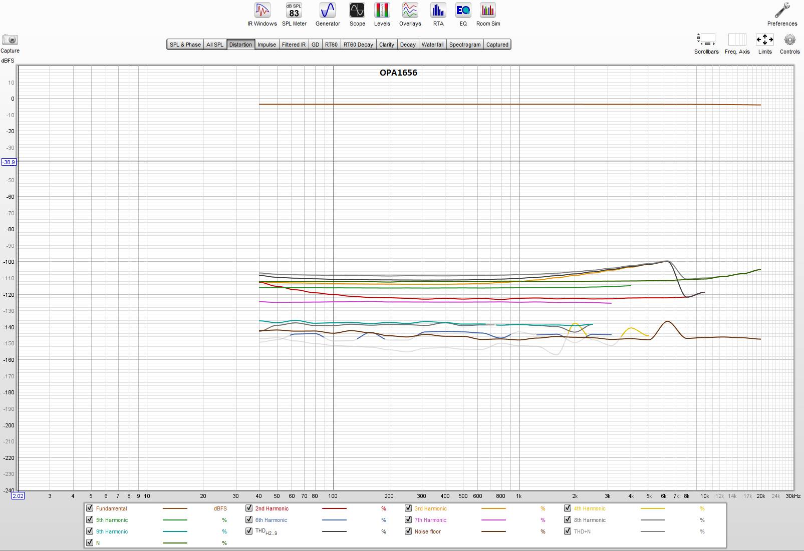

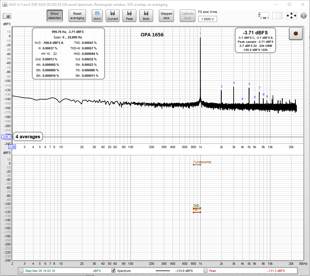

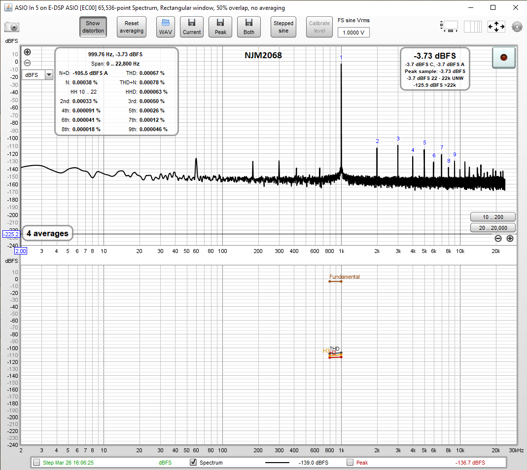

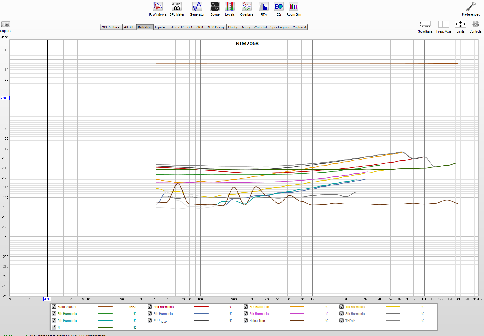

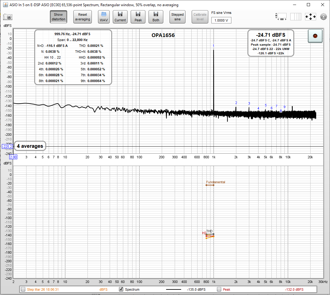

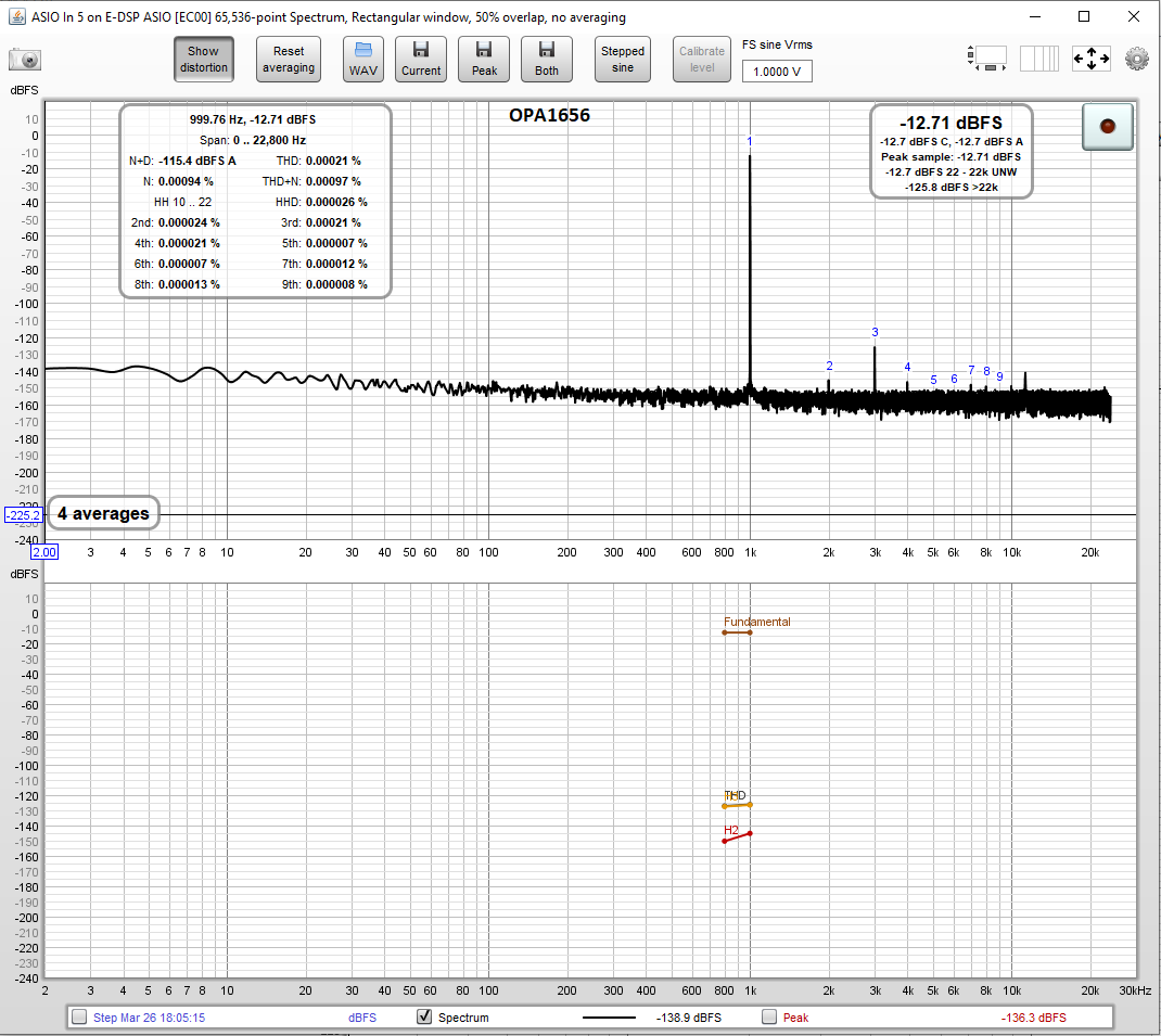

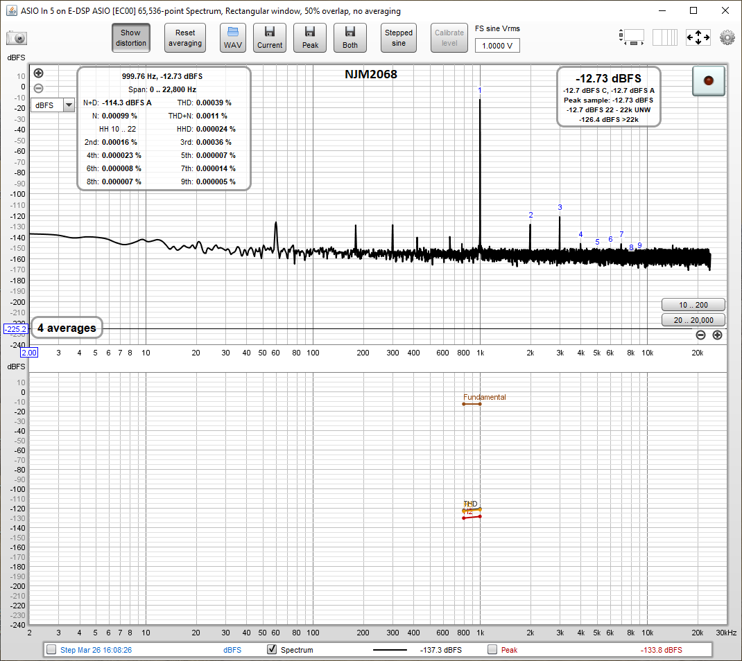

Here are charts of my newer 1820m for loopback test both before and after retrofit of NJM2068 with OPA1656 in both ADC and DAC. No other changes were made.
As expected OPA1656 is a definite upgrade objectively. Subjectively, I've not been a fan of trying to describe with adjectives the sound of something that is supposed to be 100% neutral, so I'll put it this way: as a musician I would have been willing to pay 50-60% more for the difference in SQ had there been two different products available at the time. I opened up an orchestral mix that I had been working on with my other 1820m with LM4562 in it, and I found trying to mix via the 2068 a bit tricky. No such problem via the OPA1656. Recording tests thru the ADC later....
Charts for full spectrum and for various output levels @1KHz. Note the distortion peaks below 1KHz on the NJM2068:
Those are mains related peaks (60Hz multiples). It would suggest that OPA1656 has much better PSRR. OTOH the THD numbers are quite close which in turn may suggest that ADC is the limiting factor.
What I have found annoying regarding AKM ADCs is the relatively high 3rd HD. This is especially pronounced at higher frequencies (10kHz or 20kHz). I wonder if there is a cure for this.
The 60Hz et.al. turned out to be coming from my headphone amp with internal PS that is sitting right on top the 1820m. It was on when I tested the 2068 and off for 1656.

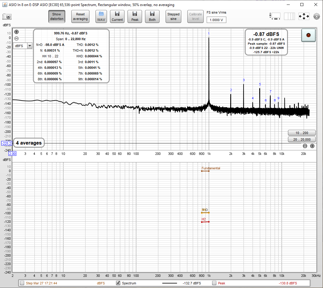

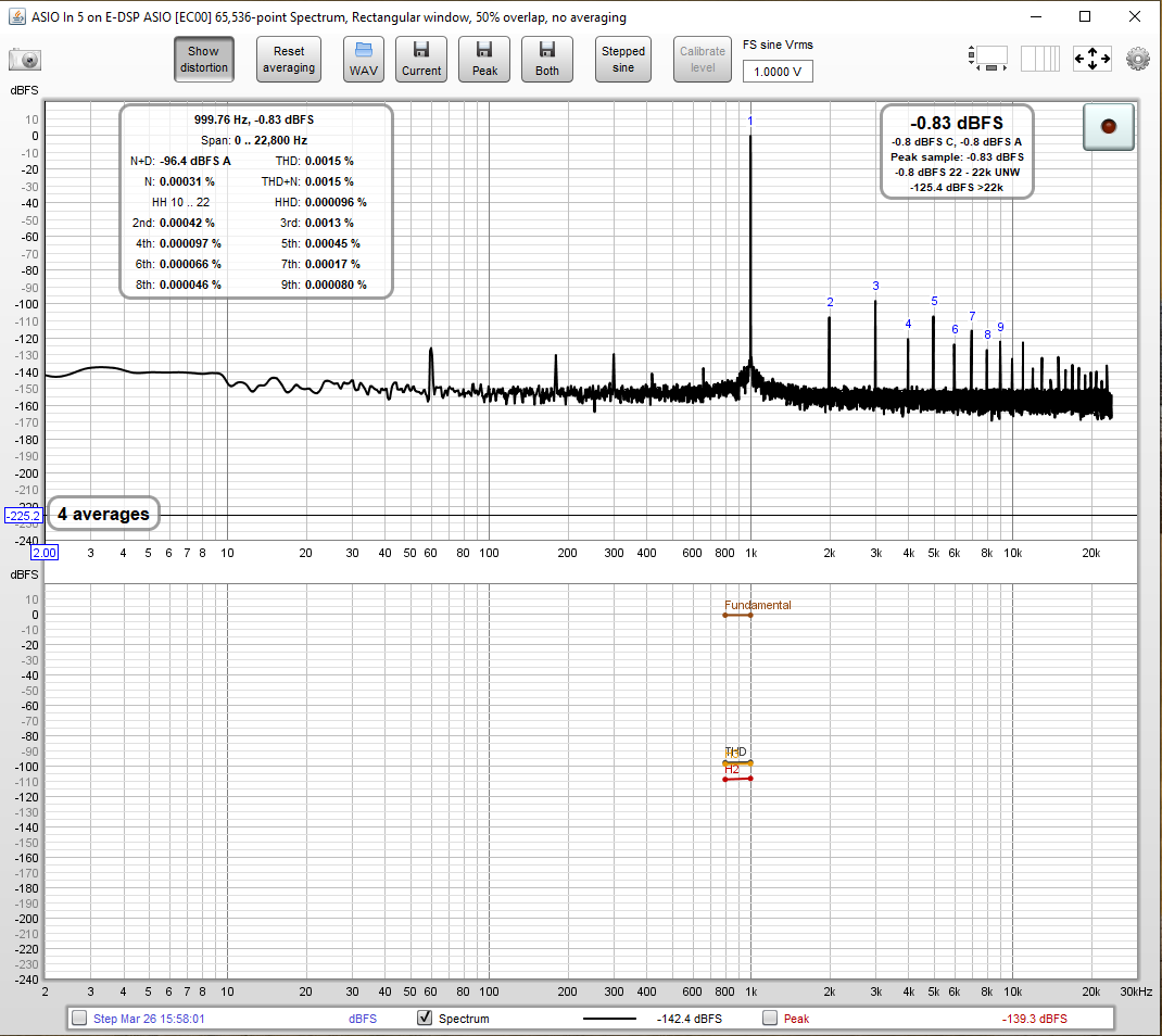

As for the AK5394, they seem to be the bottleneck in the loopback. The charts for -.1dBfs which is where a lot of rock and pop material spend considerable time, shows significant increase in distortion for both 2068 and 1656 though the latter is better. Given the 1820m is known to have at least 3dB headroom beyond 0dBfs in its DACs it seems the 5394 is the bottleneck. I'll try to rig a test to drive -.1 out and pad the input and confirm the theory. Hopefully its right since 5394 is known for great sounding recordings and nobody in their right mind is going to set up a session driving the inputs that hard no matter what the source/style.
First chart is 2068, second and third are 1656:
When I did my CS4398 filter op-amp experiment with NE5532P, LM4562NA and OPA2134 I found that I could improve the 2nd harmonic but the 3rd harmonic was basically fixed. That 3rd harmonic might be the AK5394 that was doing the measurements, not sure. All three measured very close for noise too.
