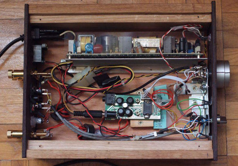

A couple of months ago I purchased my first T-amp (original Sonic Impact T-amp), and this site and its knowledgeable members have been a great help in modding it :)
I only replaced the input caps, and made a new case for it - adding 3 inputs (with selector switch), and replaced the stock plastic pot with an Alps 50K pot (all salvaged from a dead tape deck, purchased at the local flea market). I also added a PSU from an old external HD enclosure (12V, 3A) into the box, with a very small (and silent) fan. My mod can be seein in the attachment. Excuse the poor wiring, these are my first steps in "serious" soldering :D
I like how it sounds, but I'm still missing some bass... the sound is still too "hollow" for my taste. My modded t-amp is currently attached to a pair of Infinity SM85 speakers (8 Ohm, 98dB!). The speakers themselves have ample bass when attached to another amp, with bass tone control (more about that amp in another thread soon...).

PS: picture of my current modded SI t-amp attached...

I have a couple of pretty fully modded SI (2024) boards. You can definitely improve the bass by replacing the main reservoir cap (C10?), and by adding another couple thousand uf somewhere else on the board, preferably as close to the chip as possible. Use good low esr/low impedance caps as described elsewhere. Panasonic FM are often mentioned, but Nichicon, others have similar product lines. You can get about double the capacitance in the same footprint as the existing cap. Cheap, easy, and IMO well worth doing.
That said, the 2020 chip will give you more sound as well as a good deal more bass. If Arjen's board is anything like the Amp6, you'll be most pleased with the results. Give the SI to someone you love or use it eleswhere.
