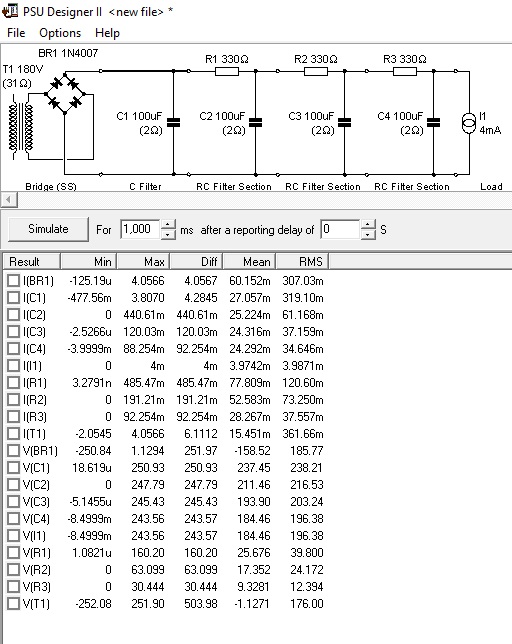

I managed to cobble something together, just been clicking on stuff! unfortunately there are a lot of parameters I just dont know, Ive looked at the data sheet for the caps and the bridge and I cant find things like internal R of caps. I tried to create my own bridge but again so much info is missing from the data sheet that i can see, so i left things as they are and ran a sim, I couldnt work out how to add bypass caps, kept telling me it was not allowed or words to the effect of... so ive uploaded the results, I cant see the ripple current because I have no clue what I am looking at sorry. I dont even have details for my transformer, I changed it to 180v which I did measure to be correct, im getting about 280 so probably a bit more than 5%. I couldnt really draw it correctly either, its drawn as one channel but I increased the load to allow for 2....
Bypass caps don't materially affect ripple current, so no need to include them in the model.
The ripple current figure you want is I(C1) RMS, so 319mA. However, this looks rather high for a DC draw of only 4mA. The reason is that PSUD2 has included the startup inrush current in the calculation. Put the 'reporting delay' up from 0 to 2 seconds and run it again.

16mA ripple for 4mA DC sounds more plausible.

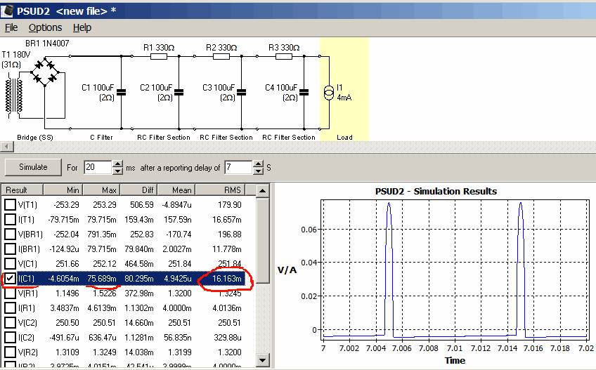

OK, you started PSUD fine. But plot the load voltage V(I1). It has only got to 200V at the end of one second, we expect like 250V. We really hardly care about the first second(*): a cap won't blow-up that fast, and the music hasn't started. Let the load voltage stabilize. "Many RC." 100u+330r is 0.03 seconds, but you have three of these, so several seconds.
BTW: this is why you have different current in R1 R2 R3, when they clearly must be the *same* current steady-state (operating). In the first few seconds the caps are still charging. I get about the same numbers as you, but this is not the running condition.
I found voltage still rising at 2 seconds, so I ran for 7 seconds (second image). The current has narrow 80mA peaks, the RMS is 16mA. This is what I would expect: cap ripple current "several times" load current. 4mA * several is 16mA.

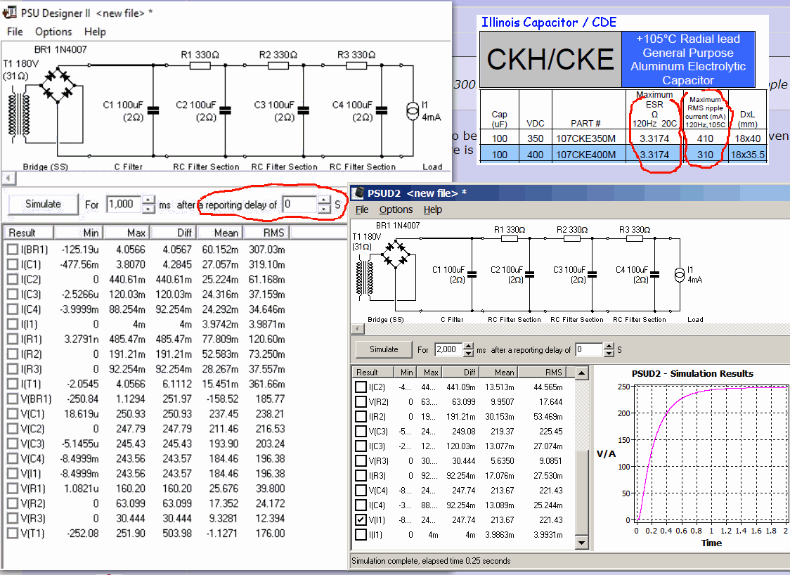

What can the cap stand? I have extracted a piece of a datasheet of a good $3 capacitor (1st image). We see the ESR is really more like 3.3r, not the 2r default; we could either claim that 3.3 is Max and Typ may be 2, or re-run the sim with 4 Ohms (because ESR rises with age) just to be sure nothing bad happens. (It won't.) Also we see that caps of this rating, size, and price can stand 300mA of ripple current, FAR more than you need. (Ripple goes mostly with size, to shed heat, but also with ESR but note that you can't buy much lower ESR in an aluminum electro cap.)
(*) We DO care about the first cycle when picking a diode. The turn-on current can approach V(T1)/R(source) or 250/30 or 8 Amps. PSUD figures 4A first halfwave, 1.6A next, declining to that 80mA peak noted steady-state. The 1Amp 1N400x will take the 4A one-time peak comfortably. (Pick your diode >2X the DC load and you will usually be OK. This says you need a >0.008A diode, which is no cheaper than a 1N4007.)
