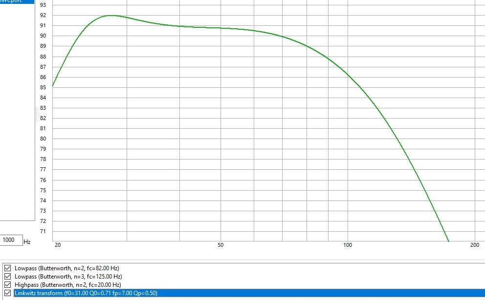

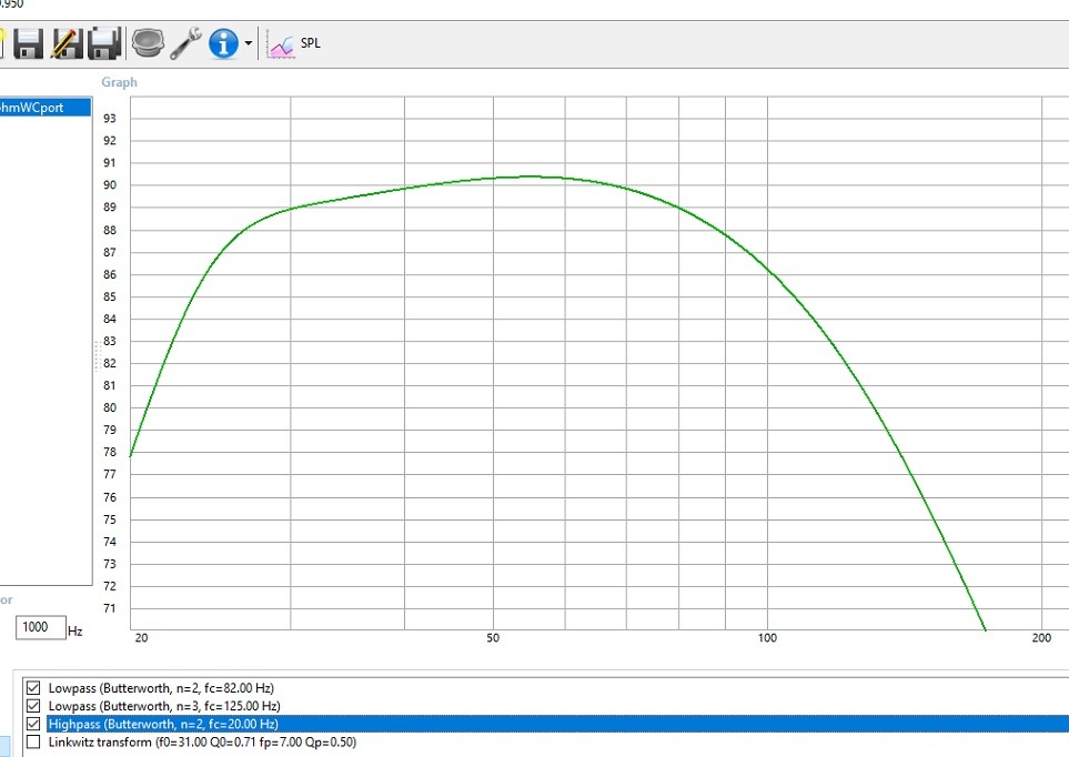

Attached is the Winisd design for that, with the (unadjustable) LPF that's in my amp in series with the LPF board I bought and would have added, AND a HPF for thumps, port noise, etc.
When you look into room effects, that can add quite a bit depending on size of the room, etc. So also a simulation of what that response might be like in my room attached. (At 17 watts into the 8 ohm driver, SPL @ 1.5M)

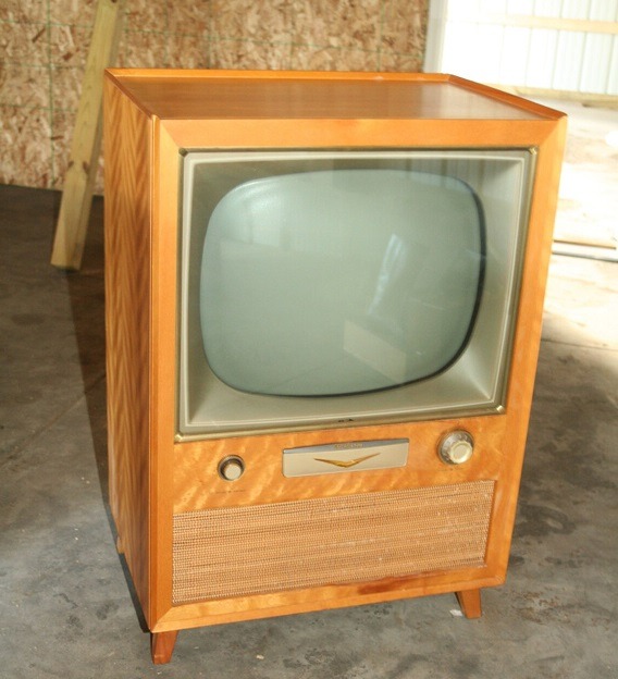

So, I got that far, had ordered parts to re-do the crossover and box on my S2000 speakers. Got set aside for a bit while I worked on some other projects this summer....and then this fall my wife changed her mind on our living room furniture setup. We have a little "bar" corner that she decided now will use the case of an old (1950s) TV we have to hold liquor bottles, etc. Very similar to this TV:
So that changed the scope of the sub project. If I have that (relatively) huge area under the screen hole where the speaker grille cloth is to work with, I could instead put the sub in that instead of under an end table. So that changes the available space I have to work with quite a bit. I haven't decided for sure on the exact design.... I'll likely use the 7" Wavecor as I already have it... (vs swapping to a larger driver now that I have more space.)

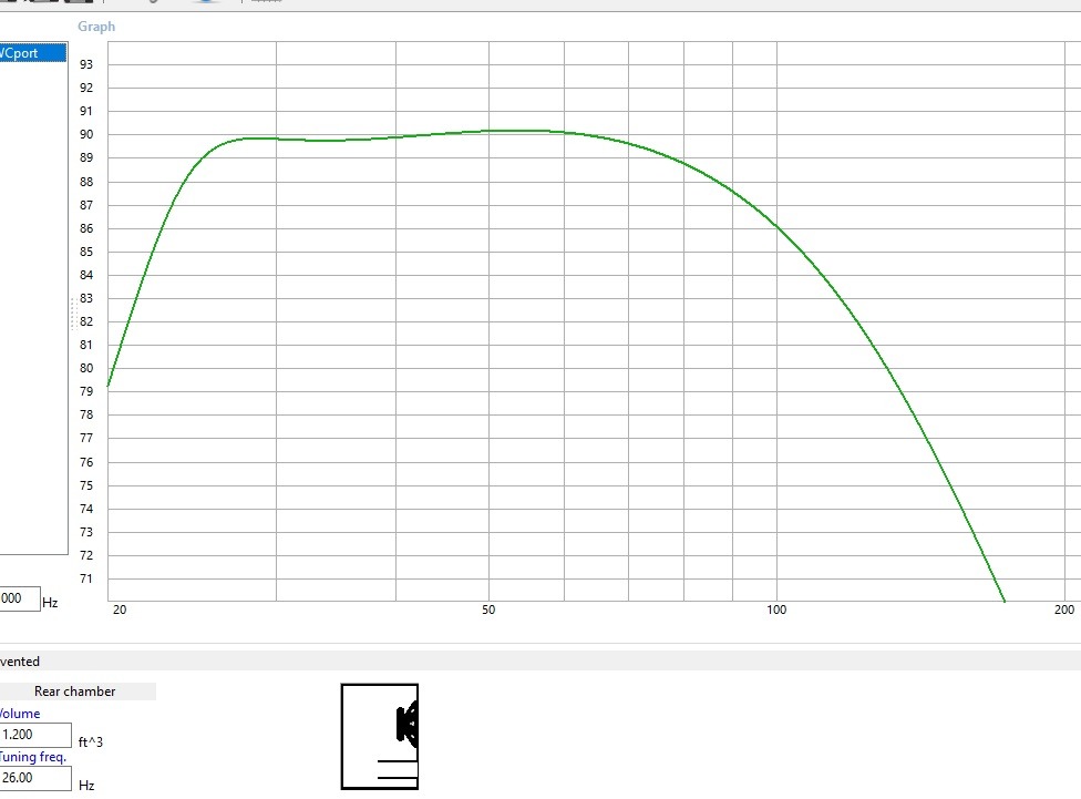

With the Wavecor driver in a 1.2 CF box, same filters, and a 3" port tuned for 26 hz, (no room response estimate added):
