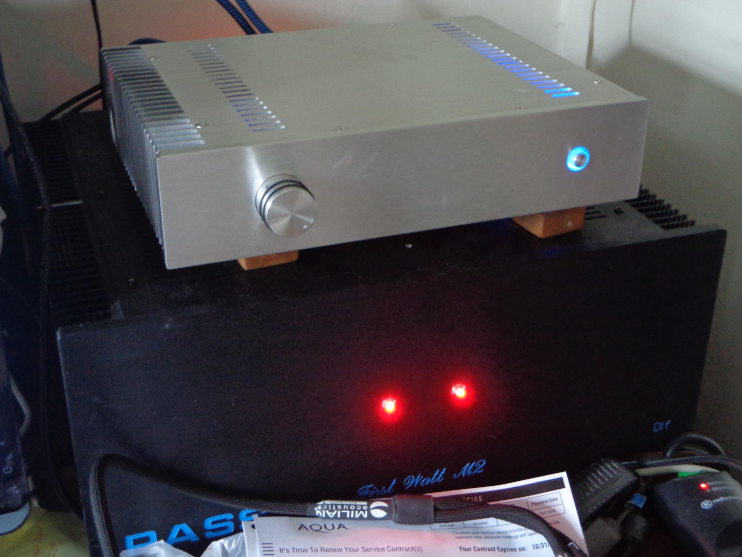

At +/-24V (actually a little less after the resistors) and after playing for 30 minutes or so my transistor pairs aren't much above ambient - about 38-39º, but the case is hot from the Salas shunt and it's sitting on an M2, which doubles as a sort of space heater, so I don't think dissipation will be a problem.

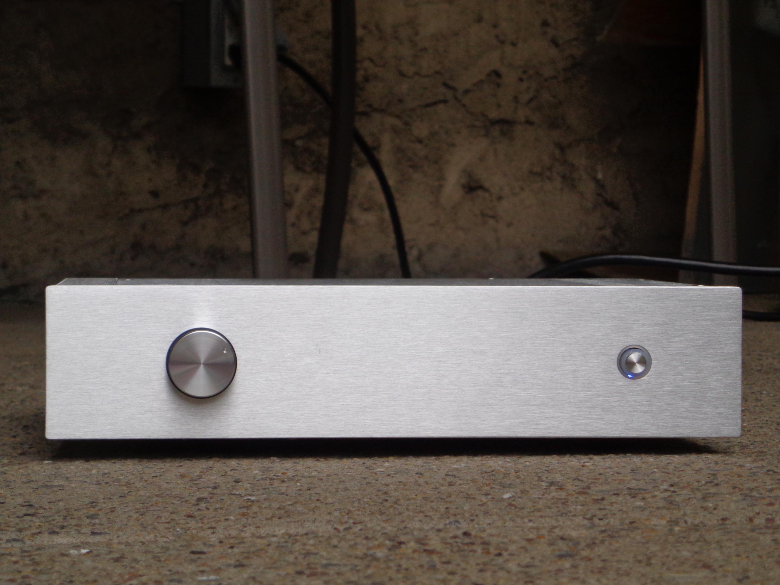

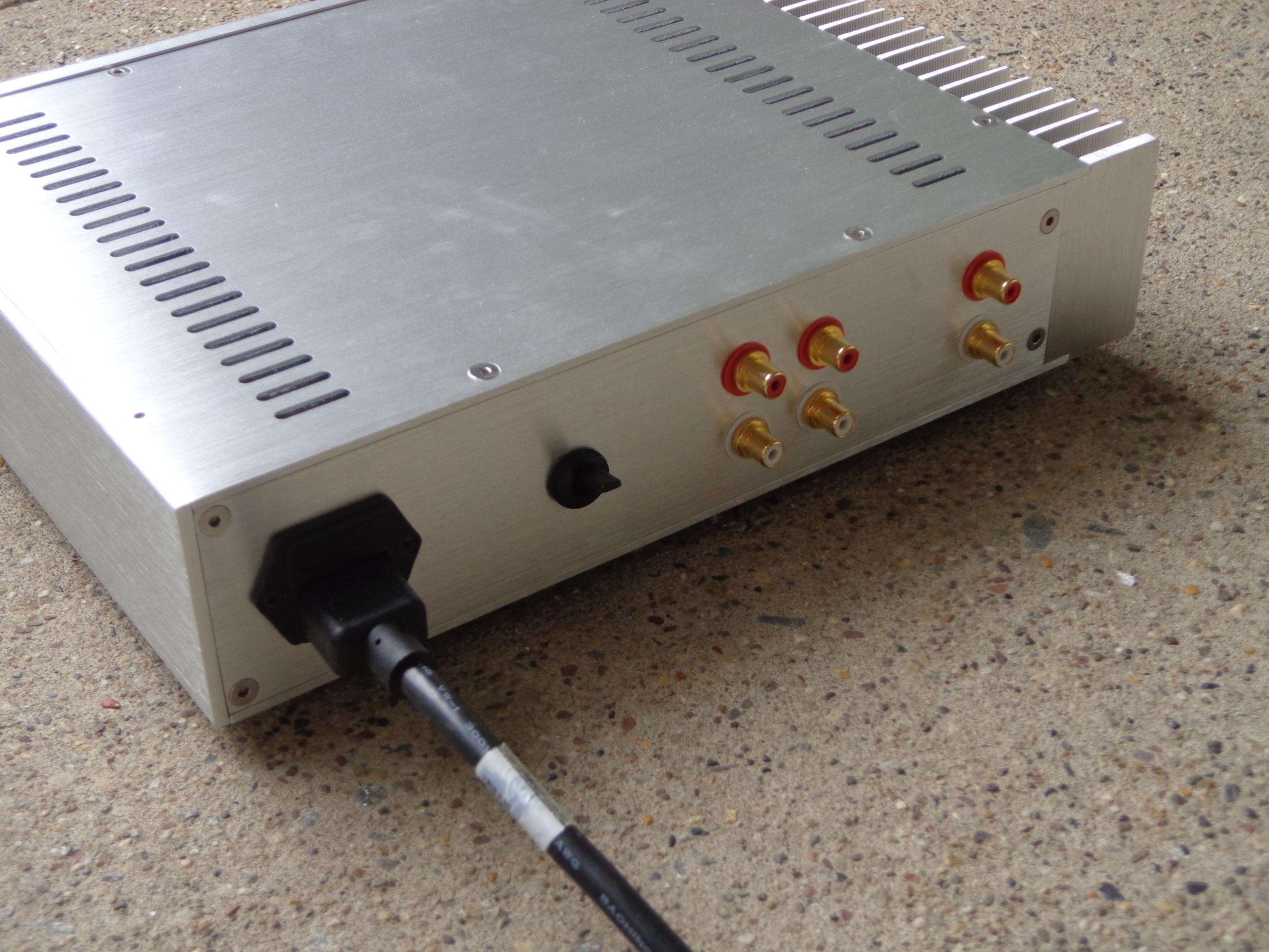

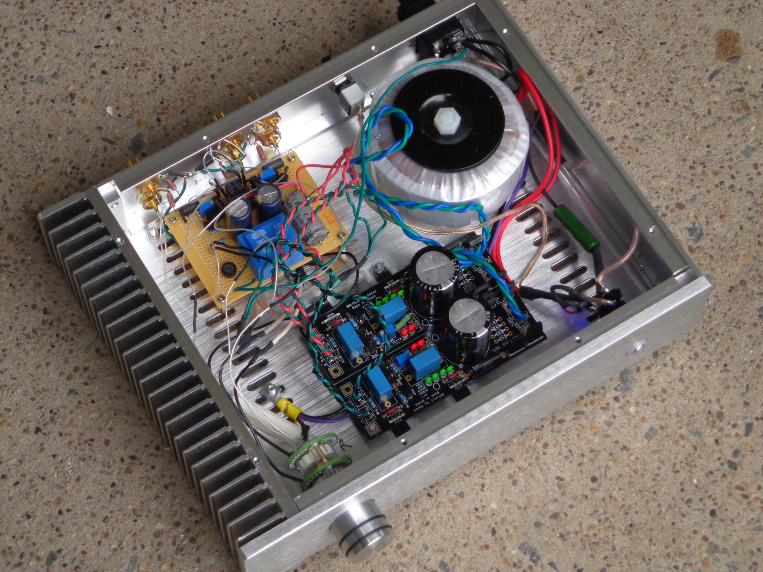

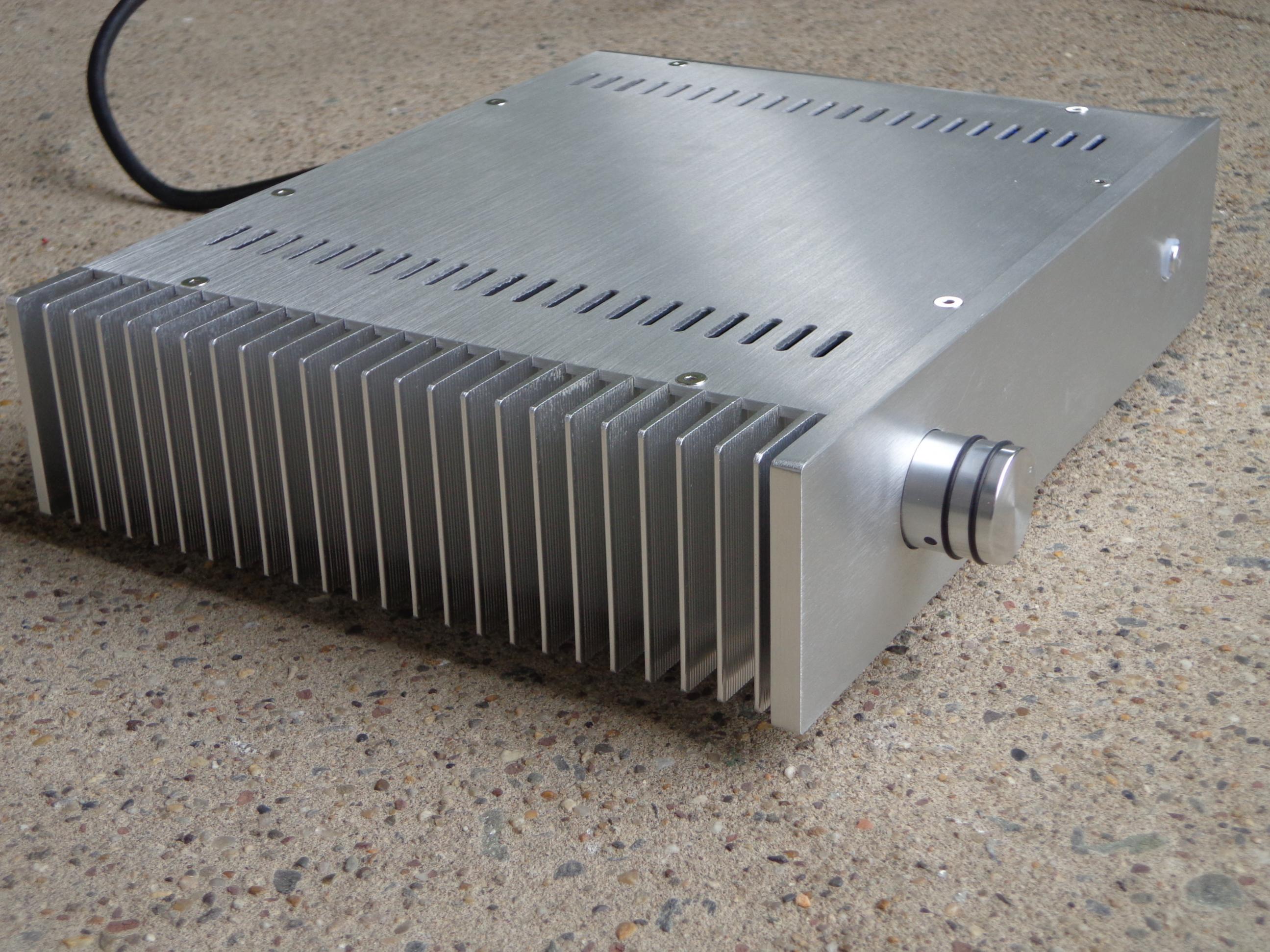

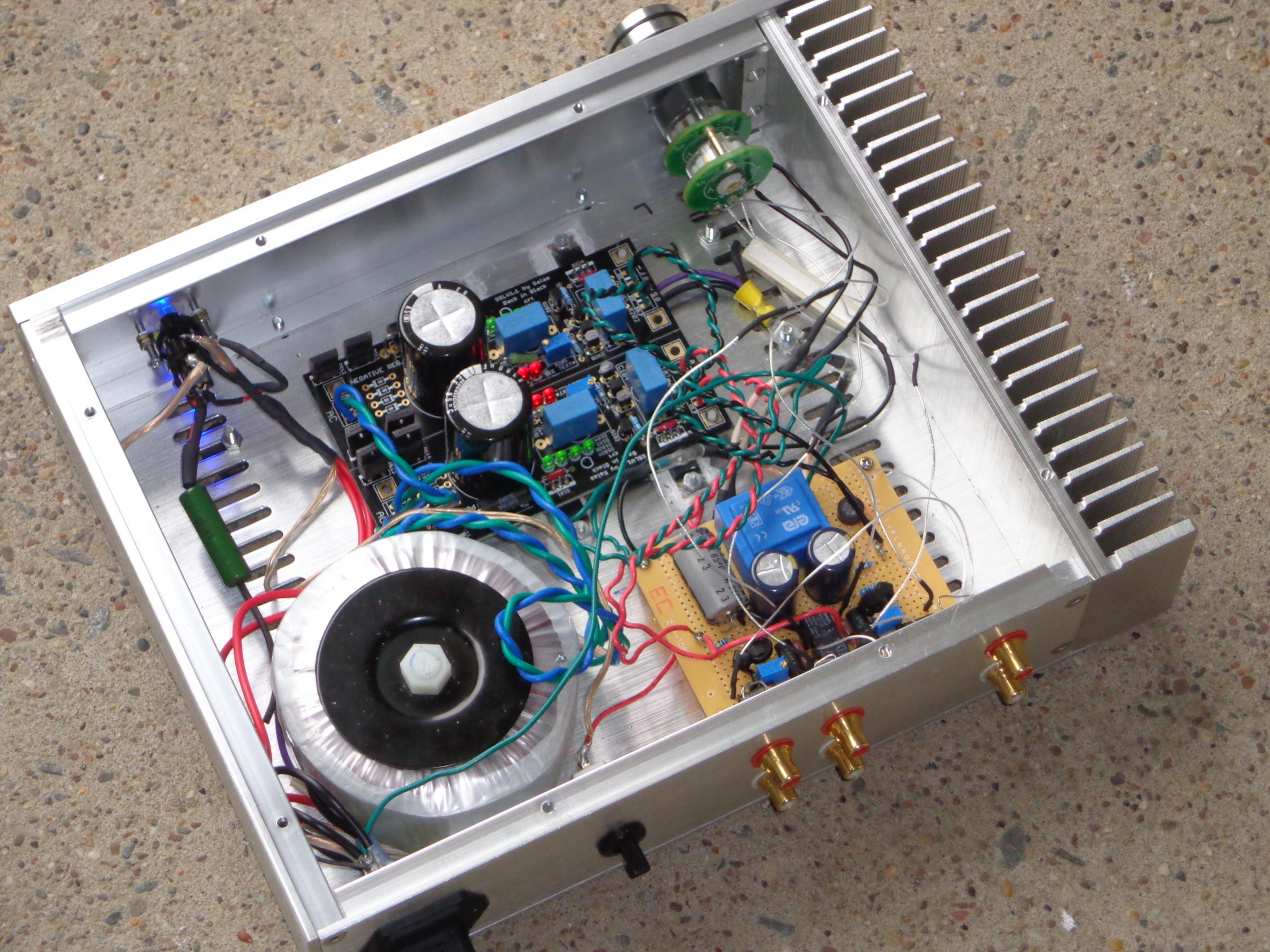

B1 R2 finished
The case is a cheap one I bought on ebay from some guy in Hong Kong - it fills the bill and looks pretty decent. I jerry-rigged some LEDs to make a lighted power switch. The relay input-switching works well, now that I have the coil wired right! It doesn't work if you wire it backwards, I found out to my surprise. I replaced the transformer bolt with a nylon one on the advice of Vince D, and also lifted the transformer off the case floor about a quarter inch. Don't know whether it made a difference - too long between before/after, and I also replaced the pot. In any case it's the cat's meow now.
