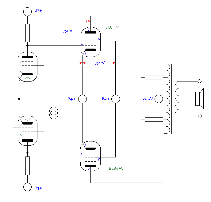

From looking at the tube specs, I am assuming your 900vdc is what you are adding together, from CT to plate on two tubes, in a push pull configuration, is this correct?
Roger Modjeski claims that the 7189 can be safely operated with a plate supply voltage of 700Vdc, if the screen grid is kept half of that. The DC coupling scheme I am considering would basically 'stack' this voltage on top of an approximately 150Vdc input stage plate voltage where I am planning to use a long tailed pair of high gm sharp cutoff pentodes as the input/drivers. This would give approx. 850Vdc at the transformer primary compared to the secondary. The peak voltage referenced to ground at clipping would probably be in the vicinity of 1500V. Roger claims that at 30mA per pair quiescent, fixed bias, the RM10 operates the 7189s cooler than a Dynaco Stereo 35 does.
This may sound overly optimistic, but a pair of the EL34 in PP can generate up to 100Wrms with 800V plate, 400V screen, so why not give it a try? Try biasing like an RM10 but with a little lower primary transformer impedance and a little positive grid drive. If I start blowing tubes, I'll just swap in a lower secondary voltage power transformer and/or AC couple the driver to the output stage.

Sorry if I left the impression that it might be SE. Planet 10 is right. It's definitely PP. I can work up a schematic diagram, but it'll look like a disaster waiting to happen, what with DC coupling and all. I plan to use protection features such as cutting the 7189 screen grid voltages to zero using series pass SS devices (mostly high voltage MOSFETS such as some TO220 'fullpack' 1000V N channel devices I have with integral gate clamp zeners) if the input stage hasn't warmed up or is missing, as well as using neon bulb 'clamps' to prevent excessive positive 7189 grid excursion. Also, there would be a circuit to maintain the correct grid bias for the output stage tubes by changing the long tailed pair current. Hopefully an 'auto balance' circuit could be implemented around an isolated op amp such as the TI/Burr Brown ISO124 controlling the input pentode screen grid voltages in a 'seesaw' manner by comparing the individual 7189 plate currents. The trick here would be keep the balance circuit sonically transparent as much as possible because without considerable LP time constant smoothing & maybe some non-linear shaping it would attempt to cancel the signal to be amplified! To keep SS grit from these protection/bias circuits from affecting the sound much, I'm thinking of bypassing all screen grids using RC networks with polypropylene capacitors.

I must admit to being concerned about our skill set with plate voltages above 700 vdc. This will be a fairly large transformer any way, what with 76 henries required for -3 dB operation and 212 henrries required for - 0.5 dB so there will be enough room to build in the extra dielectric creepage and clearance requirements.

Wow! That's quick. That's pretty close to what I was thinking of, except the 7189 cathodes will be referenced to ~+150Vdc (B3+) instead of ground to allow biasing of the input stage. I have a few options that I'll look at/try, regarding sourcing the input stage plate supply - I was thinking that a R divider between the UL taps or possibly the output plates and ground could provide a way to get some local feedback while leaving a little gain for any loop feedback desired. There is also the option of taking balanced loop feedback, of course, with the 4 ohm tap grounded and fb being taken from the ground and 16 ohm taps, but I really haven't thought that part through very much. I'm sure some combination of the above should be useful though. What do you think?
I originally had them tied to ground, but put the resistors/black boxes back in as i new you'f need to chewup that 150 V somewhere.
