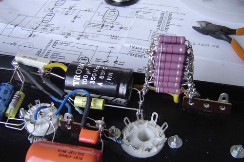

Salomonic solution
While I try to find that resistor, I have decided to parallel 25 resistors 9k1, 5W each. :tongue:
