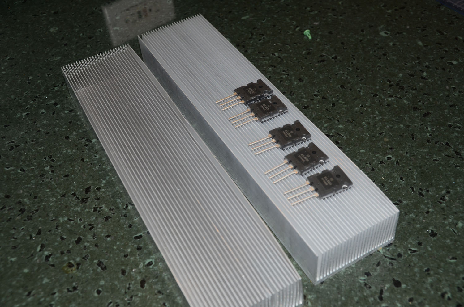

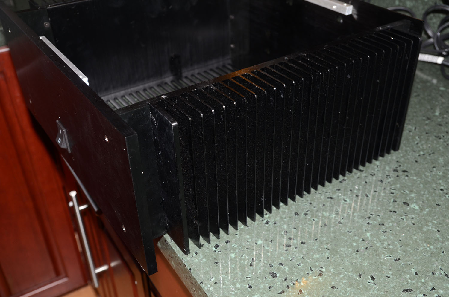

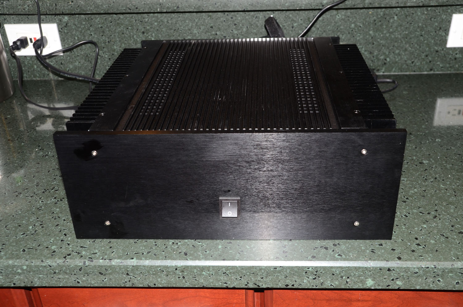

Attached are two pictures of my chassis and the heat sink. It's a big chassis with huge heat sink. I paid $280 between the chassis and shipping. Also, I include the picture of the heat sink used in my test platform. It's a smaller heat sink, but I am sure it's going to dissipate 100W from looking at the size respect to the big power transistors.
In fact, I think I am overkill with these heat sinks particularly when I put in the real chassis.
Yes, the link I showed is a 22V-22V 500VA transformer. I still have the option of using my other 30V-30V 625VA transformer also. But I have to lower the bias to 200mA per pair instead of 300mA.
The company also sell a 20V-20V and an 18V-18V 500VA transformer also. Then I can increase to 350mA and get Class A with 8ohm.
That sink looks to be about 0.2C/W to 0.3C/W
It is too small for 100W and deltaT of <20Cdegrees.

You mean the smaller silver color aluminum one? Yes, I expect it to run hotter, but I think it's going to be ok for 100W. It's still a 12" X 2.75" X 1.4" big. It's not exactly a wimpy heat sink.
Regarding to the big chassis, I kind of remember when I bought the chassis, it said the heat sink was 200W per side. That one is a lot bigger. It's a 12" X 5.75" X 2", thick metal.

No, I am referring to the black sinks attached to the chassisYou mean the smaller silver color aluminum one? ..................
It is a big sinkIt's still a 12" X 2.75" X 1.4" big. It's not exactly a wimpy heat sink.
200W into a Rth s-a of 0.25C/W gives a deltaT of 50Cdegrees. That would be below the industry standard of 70C to 80C used by the heatsink manufacturers for rating their heatsinks. Rth s-a of 0.375C/W would hit deltaT=75Cdegrees exactly. Clearly that big heatsink has a far lower Rth s-a than 0.375C/W............it said the heat sink was 200W per side. ............It's a 12" X 5.75" X 2", thick metal.
But you must de-rate the standard deltaT=75C value of Rth s-a to your actual Ts-Ta heatsink temperature rise (deltaT)

Let me give the calculation a try. Please verify for me.
So if the heat sink is rated 200W, that is rated for rising to 75 deg C?
Let Ta=25 deg C, so the rise of temperature ( Tc-Ta)=50 deg C. therefore the thermal resistance of the heatsink is 200W/50deg=4W/deg or 0.25deg/W.
Let's not trust this and make it 0.3deg/W here.
If I dissipate 75W, the rise in temperature is Delta T= 75W X 0.3deg/W= 22.5deg. If Ta=30deg C, then the temperature of the heatsink = 52.5deg C. That's not bad at all.
Let's say the temperature from internal of the transistor to the heatsink is 10deg, then the internal temperature of the transistors are 62.5 deg C. which is way in the safe area.
This calculation should be very conservative using 0.3deg/W. I am using 5 pairs, so 10deg difference between die and heatsink is realistic.
Am I right?
