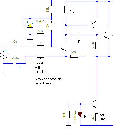

That mjr input is best for linearity, just replace BC560C with fast bjt like 2sa1206, then replace that 1k Rbe with best value when the cascode has highest gain (depend on Vbe characteristic @ Ic(mA))
If need best simplest try this one and compare the result by listening, it may better, or may not offcourse.

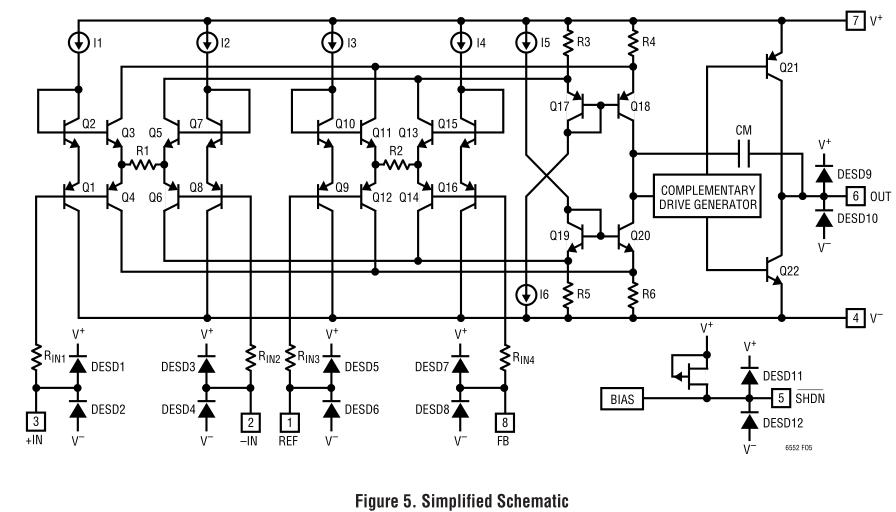

Have you tried listening to any amps based on Barrie Gilbert's AFA? They're my current favourites subjectively. So far I've only found one schematic which shows the input stage of a current design, that's in the DS for the LT6552. Here's what it looks like. Note there are two matched error amps, not one.
