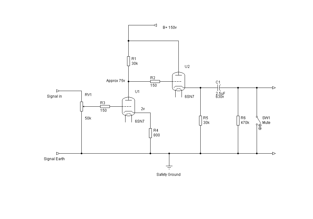

BTW here is the preamp circuit. Pretty simple and to the point. I kept the voltages low so that I did not need to use a seperate filament winding for each stage. I can bias the filaments to 80v or so and still be within the 6SN7s specs for heater above cathode voltage.

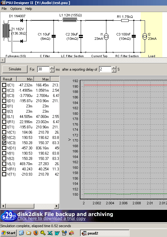

Here's what I came up with. In order to get some control of the amount of distortion on the secondary voltage, I reduced the VR current to 13mA, which is still a good number.
How's that look to you? It's tight, but it works.

G said:What are the specs of the power tranformer? Is it still the 396BX? The results certainly look good.
The 369BX, yes. Things are tight, but it should work. In my experience, Hammonds are marginally rated, but you should be fine. Ideally, you want to measure the xfmr parameters before buying the capacitors, in case slight tweaks are necessary. Fortunately, the sizes of the capacitors are small enough that you could afford metallized film throughout (or maybe use one of those 40uF motor runs).

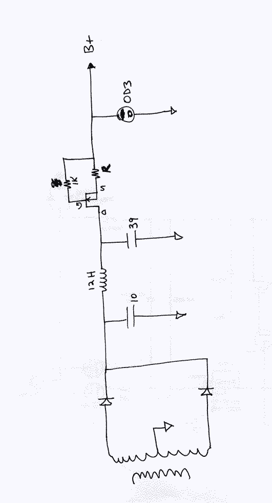

I don't suppose you could draw out a shematic of the proposed supply could you? I'm not quite sure how to utilize the IXYS current regulator. Do I put it in series with the OD3 or in parralel with it?
Not sure if I understand. Are you talking about the resistor in my latest schematic, tucked up against the source of the FET? This is chosen based on the total current I want to provide (23mA). I select it as an approximation based on the datasheet:
http://ixdev.ixys.com/DataSheet/98704.pdf
This gets you close, but you would really want to test for the optimal value.
There's a few threads on this and the DN2540 you could check out. They really do work well.
