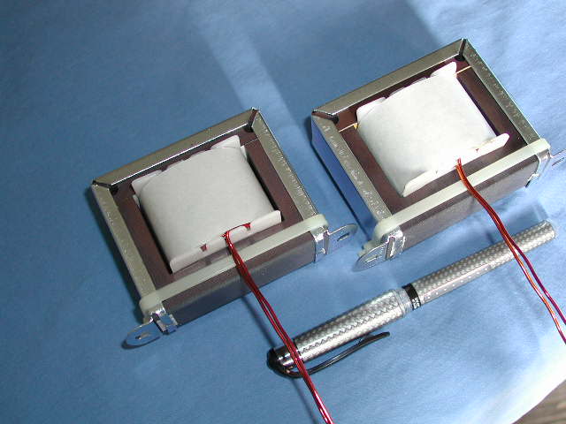

I use a choke input PSU on an Aleph 4 Amp that runs beautiful.
Originally I had no Pi filter with 240K uf but that produced hum so I added some reistors between caps, that cured the problem but then decided to do a LCRC type of filter which I used for some time with very good results.
Later I decided to test only LC with the whole lot of capacitance at the end and the amp clicked in very nicely and no hum whatsoever, very clean and quiet.
What called my attention was the excellent votage regulation I now get at the PSU, very stable.
The only penalty I pay is a lower Rail voltage that falled from 50V to 31V but dindn't care much up to the moment since I have more than enough power for the speakers I use and I'm running the output stage at a lower current I guess since did not change resistors. Soundwise is very good though.
BTW the chokes are gapped home made, 15mH.
Joe, when you say you steal toroids from computer PSUs do you mean for choked linear power suplies, or do you mean for switching PSUs? If you use them for linear suplies, don't they saturate from the DC curent? I never considered toroidal chokes for this aplication, maybe you could tell me how it worked for you?
As for apassgear, those look amazing. If you wouldn't mind me asking, how did you go about constructing them? I'd absolutely LOVE to build my own chokes, I know they wouldn't look as good as yours but I'd care only about functionality. One thing that I don't know is where to obtain a core and how best to wind it, also, where do you place tha "air gap"?
I have posted some information and pics at "E/I Transformer Laminations; Why?" on Pass Forum that you may want to read.
As for lamination you may ask Carpenter for the source. I don't think you would want to buy from my sources in Mexico.
Once you get started is very easy and you get full control over what you want... Let me know if you decide to roll your own.
