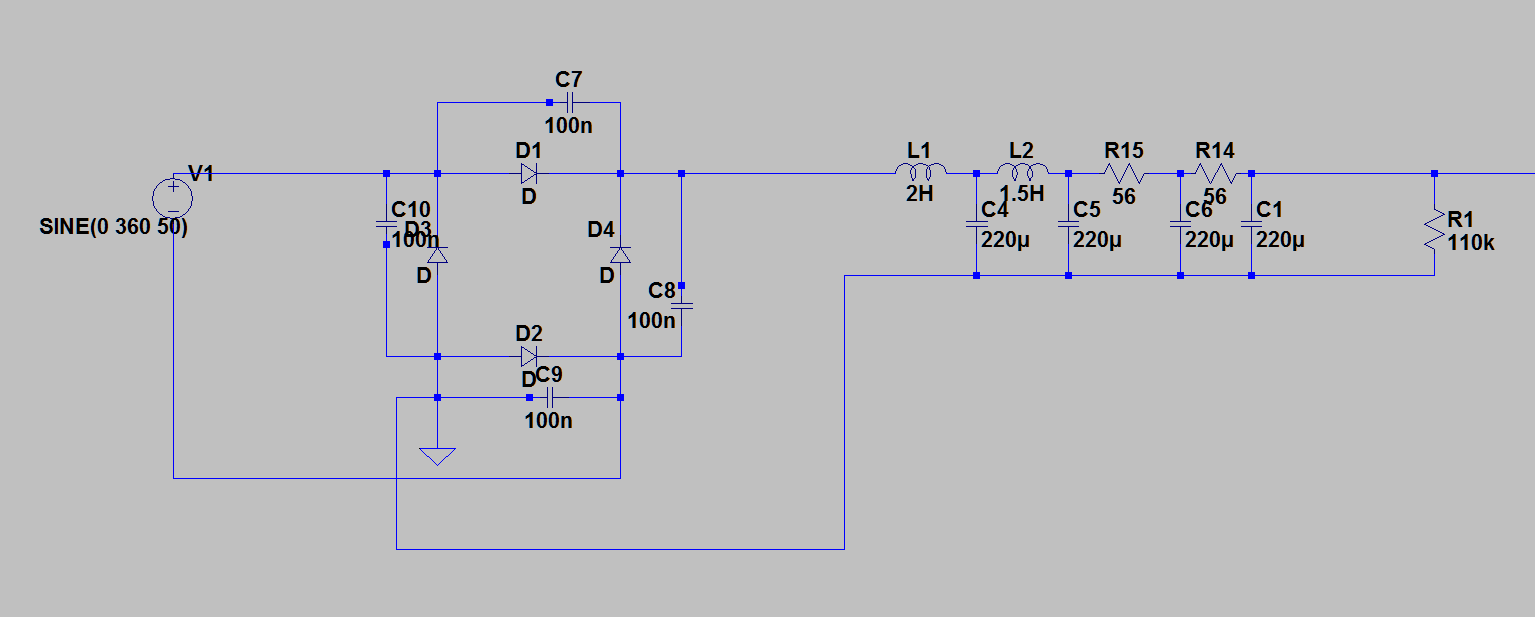

I have same issue as what you have mentioned. It looks like I have underestimated the rectifier in the case.
I have used one 50Amp bridge block rectifier ( i had them in stock ) with 100nF across each pins of the bridge block and used the following way
LCLCRCRC
a 2H - 220uF - 1.5H - 220uF-56ohm - 1.2kohm
I had that buzzing issue my load is 110k bleeder and tube pre mufollower 6sn7 with bias of about 6ma so technically the load is 6ma and would be using for stereo for 12ma or 16ma for max 2 channel so I had the same strange issue of noise and hum very low level but audible through speakers.
Can the above arrangement of using snubber of 0.03uF with 120ohm resistor across each diode and 100nF across the bridge before the choke solves the problem?
I have thought another way is to use a flyback diode across the choke? how about that one? can we use it? Or any arrangement if anyone could suggest.

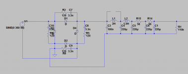

The current PSU that I have and what Im planning to do now.
6-12 mA load? Doesn't it looks like it will be better with RC-filter, not LC? We can even start with R after diode bridge. Because small load really needs a lot of Henrys (I'm silent about active filters ets).
I mean not one RC, but two-three (just change L to R in existant rectifier). It have to be totally not resonant and may be even smaller phisically.
RC-snubber before the bridge (don't know exact, may be 0.1 uF and 120 Ohm is a good point) may be much useful and effective, then four C parallel to bridge diodes. Four parallel C isn't best way to get rid of hum-noise.
Hi Vovk can you please explain that do we need to have a RC network shunt before the bridge? I never saw this alignment.
Secondly 4 x C parallel across each diode in the bridge rectifier? or after the bridge rectifier?
There are several topics here about RC-snubbers, I'm afraid I can't add more. I just can approve that they are really useful.
4xC - I'm talking about parallel to four diodes, first schematics (C7-C10).
Snubbers on the second schematics could be good, but it seem to me that they four can be replaced by one.
