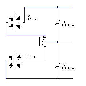

Yes, full-wave with two secondaries and two bridges, balanced powersupply with +23V and -23 V, therefore two chokes and a capacitance of 100000uF behind the choke.
I have started to debug the power supply for high-frquency ringin with the osci, I first wanted to get rid of the buzzing (sound like high-frequency though) of the chokes.
A small cap (100-470uF) before the choke brings the buzzing you can hear from the chokes down from high-frequent to the more normal 100Hz
On the high-frequency filtering: As we have 6A current drawn , I would loose 3V when attaching a 0,5R into the rail...so the resistor should be smaller like 0,25R. How much additional filtering will this give compared to the DC-resistance of the choke which is already 2,2 Ohm ? And where to place it: Making it RLC, RCLC or LCRC ?

Hmmmm, 2. 2 ohms with a DC current of 6A is a little higher resistance than I'd prefer. Power dissipation is I^2 X R, which is around 72 watts average in your case- this is why you have a 60 degree rise over ambient. But magnet wire is rated to ~200-250 C, in most cases, so you should be fine, apart from the power loss.
Another thought to ponder, and somthing you can measure- the copper winding has a temperature coefficient, and as the inductor heats up, the resistance increases. There may be some combined affects when you amp has been on and running for some time, that is reducing slightly the overall current through the choke, maybe less than 10%. But this could be taking you a little further away from the saturation point of the core, and quieting it down. Is your core rated at 6A max? The thing is, one usually wouldn't use the core at the full rated DC, because there is an AC ripple current which rides on top of the DC value (which is a function of the lines frequency and inductance); the actual working current will be then higher than the 6A rating. Is this happening in your case? You may be better off with an 8A rated inductor, for example, carrying 6A average DC current. The only drawback, of course, is that it's more expensive. But, you were saying something about being a perfectionist? 😉
As long as you're doing a true choke input supply, ie. rectifiers to the choke, and it smoothing the current draw into the first primary filter bank by operating in continuous conduction mode, (which greatly lowers the peak rectifier on the AC mains and almost doubles the transformer utilization factor), you can have some potential for mechanical hum in the transformer, because the current isn't flat, at best, but has a sinisoidal ripple current which is a function of the AC frequency and the inductance.
What it sounds like you're looking at on the input side to the inductor to prevent interruption of the current path when the diodes are all in blocking is like the bypass capacitor used in a primary side active PFC circuit; this is usually one to two microfarads film capacitor connected across the output of the diodes. In this case the "switching" frequency is much lower, and the current higher- you might want to take that up to 10 uF or so. This should be a low ESR, high quality film cap. If the supply is singled ended, then wiring it to the diode outputs and to ground should do the trick.
If you could post a schematic of your basic supply configuration, it would be easier to comment.

Steven, very cool link, thanks a lot. When I calculated right, I can get away with a ten times smaller choke in inductance using a RESONANT CHOKE POWER SUPPLY. Wow !
I will make now some experiments. 72 Watts is a lot...fortunately the chokes are center-tapped, so I can use as well only half of the winding, bringing DC-resistance and inductance down. Let's see how this is. And I will test definitely the RESONANT CHOKE POWER SUPPLY...I could do this even with some coils I have from building some cross-overs ! Very cool.
Maybe you can separate the two windings that use the common center tap. Then use one for the positive supply and one for the negative supply. Make sure that the current direction is the same in both, so the magnetic fields should NOT cancel. In this way you double the inductance of each coil, just because there is current in the other one and they are magnetically coupled.
Actually, now I think about it, maybe you don't have to separate the windings. Use one in the negative rail of the positive supply and one in the positive rail of the negative supply. The center tap is the new ground where the supply capacitors are connected to.

  • Use a resistor in parallel with each choke as damper, guideline 10..100 Ohm. This allows for smaller snubber capacitors across the bridges.
  • Connect a big 4.7u foil capacitor across each bridge, from plus to minus (more effective than across AC terminals). Normally such a capacitor needs a series R to dampen the LCR with the secondary of the transformer, but the optimum value of the resistor in series with the C is approx sqrt(L/C) with L is the secondary inductance and C the value of the C. The 4.7uF seems big enough to allow for a value of R that is close to the series resistance of the secondary, so effectively the LCR is dampened already.
Steven
Steven, thanks again, these are very helpful hints. So, I experimented a bit:
- When I use two chokes with 40mH and 2,2 ohms with the two bridges, one in the + and one on the minus rail, I have a DC after the capacitor bank of 100000uF of approx. 22,5V. My ripple is down to 25mV. The choke is buzzing a little bit with 6A (being specified for 6A).
- When I use both choke in the same configuration, but taking the voltage out already at the center-tap instead of the whole winding, the voltage increases by 1,5V and ripple is now 33mV. The chokes are buzzing louder than before.
- When use the last configuration you showed in the picture, Steven: I have now 23,4V, so one volt more than originally, a ripple of 55mV and the choke is absolutely dead-quiet. It may be the case that the transformer is now buzzing a bit, but that may be an illusion as well.
Do you have any explanation ofr these observations ? I would prefe to go with the last option, but is this than longer a choke input-PSU ? How nuch bigger are the current-spikes asked from the transformer now in comparison to the original setting ? Is there any RF-filtering as there are now no series-elements in the + and - rails ?
