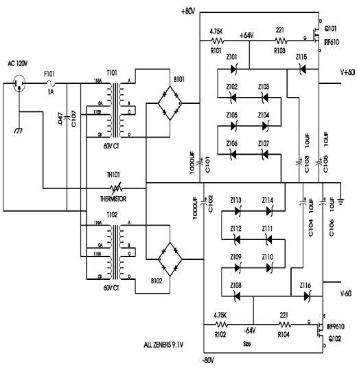

I'd been wondering that myself for my planned Aleph 30 build as I have two 200VA toroids, each with two 18VAC secondaries, that would be easy to use and better power-wise than my alternative of a single 300VA toroid. I've been running the 18VAC secondaries in series (but in dual mono configuration) in my F3 clone which has an F1 style PSU (0V / 50VDC). The Alephs as you know require an "F5 style" PSU to deliver +/- 25VDC.
The schematic below shows an example of a +/- 60V PSU that uses two toroids. The two trafos look to me to be in series on the DC side of their bridge rectifiers, with the midpoint of that series connection serving as the 0V / ground pole for DC. What bothers me is that tying the secondaries of two trafos together in AC space would seem to require them to be perfectly in phase? I don't know if tying them together in DC after rectification as is shown in this schematic gets around this or not, and I'm a little too chicken to try.

Well, I've talked myself out of this, for the time beng at least. When I started thinking about it, it was hoping it wouldn't cost much extra, as I'd save the cost of buying a xformer. But when I do the sums, it doesn't really add up the way I hoped! I'll go with the usual CRC for the moment, and maybe try chokes in the future, depending on funds.
