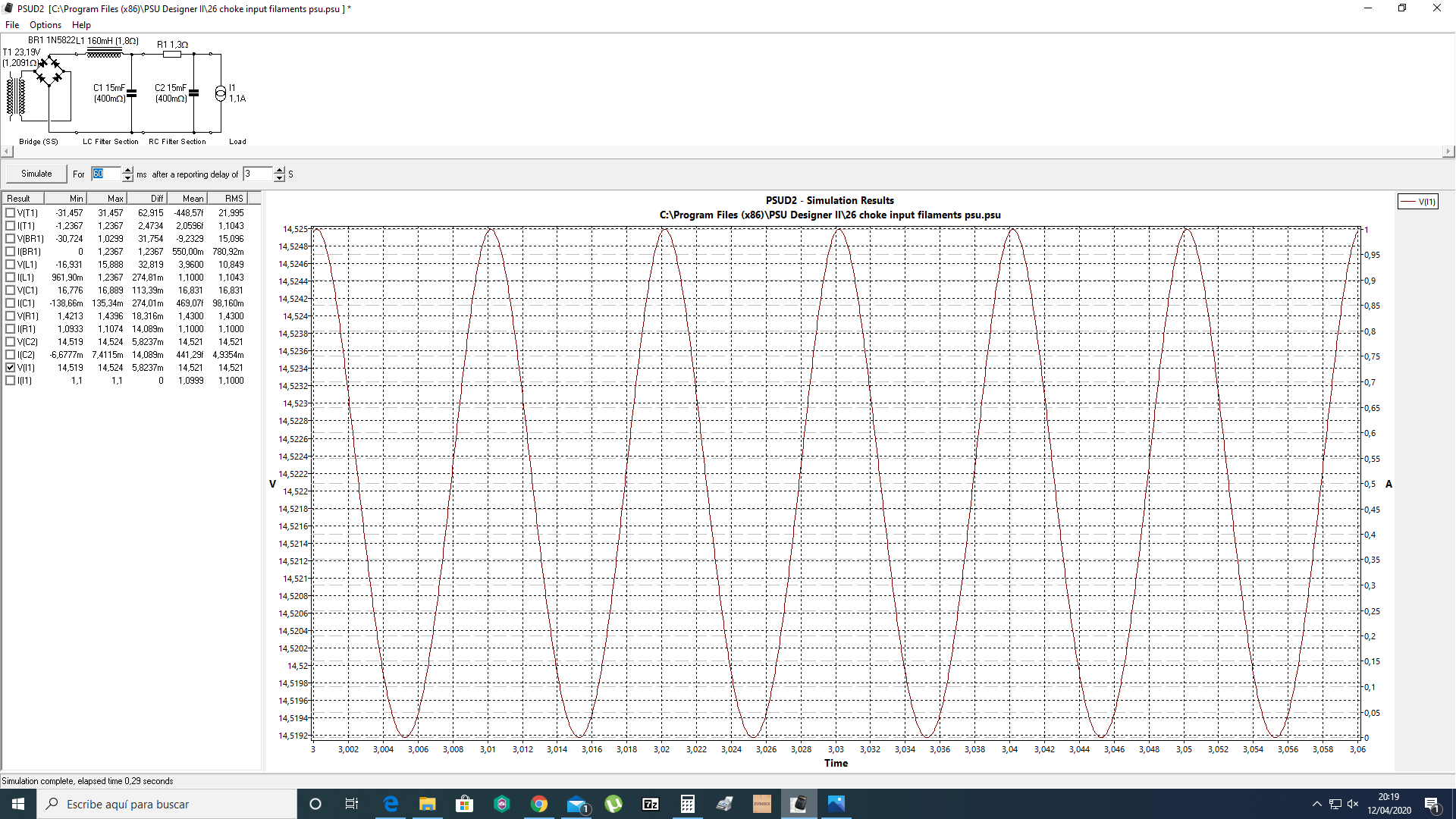

Using PSUDII to simulate the PSU I get an open window, I guess I need more PIV rated diodes but used all availables and always the same error.

Try using a choke like the LL1694 or LL2733 from Lundahl. You probably need more mH and/or dcr otherwise there will still be charging peaks where with a true choke input the current running through the choke will be equal to the current taken by the load.
Greetings, Eduard

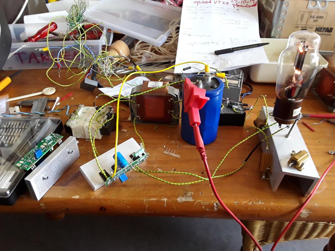

You need some extra DCR and what you really need is more mH LL1694 is 160 mH and LL2733 can be made for about 500 mH. Lundahl allows you to order their chokes with different aircap. The standard LL2733 is 1,7A so if you tell them 1,2 A is enough you will get more mH which is a very good thing. greetings, eduard
Hello Felip,
Just a short answer. Yes, 1,2 A will be enough.
I am using LL2733 1,25A as choke input for my VT25A ( 7,5 volt 1,25A ) Rod Coleman supply. I am using LCRC ( R gives extra filtering and allows extra voltage adjustment)
Using Triad split bobbin transformer.
Greetings, Eduard
P.s always have some current running through a bleeder so it will always work as choke input even without any tube.

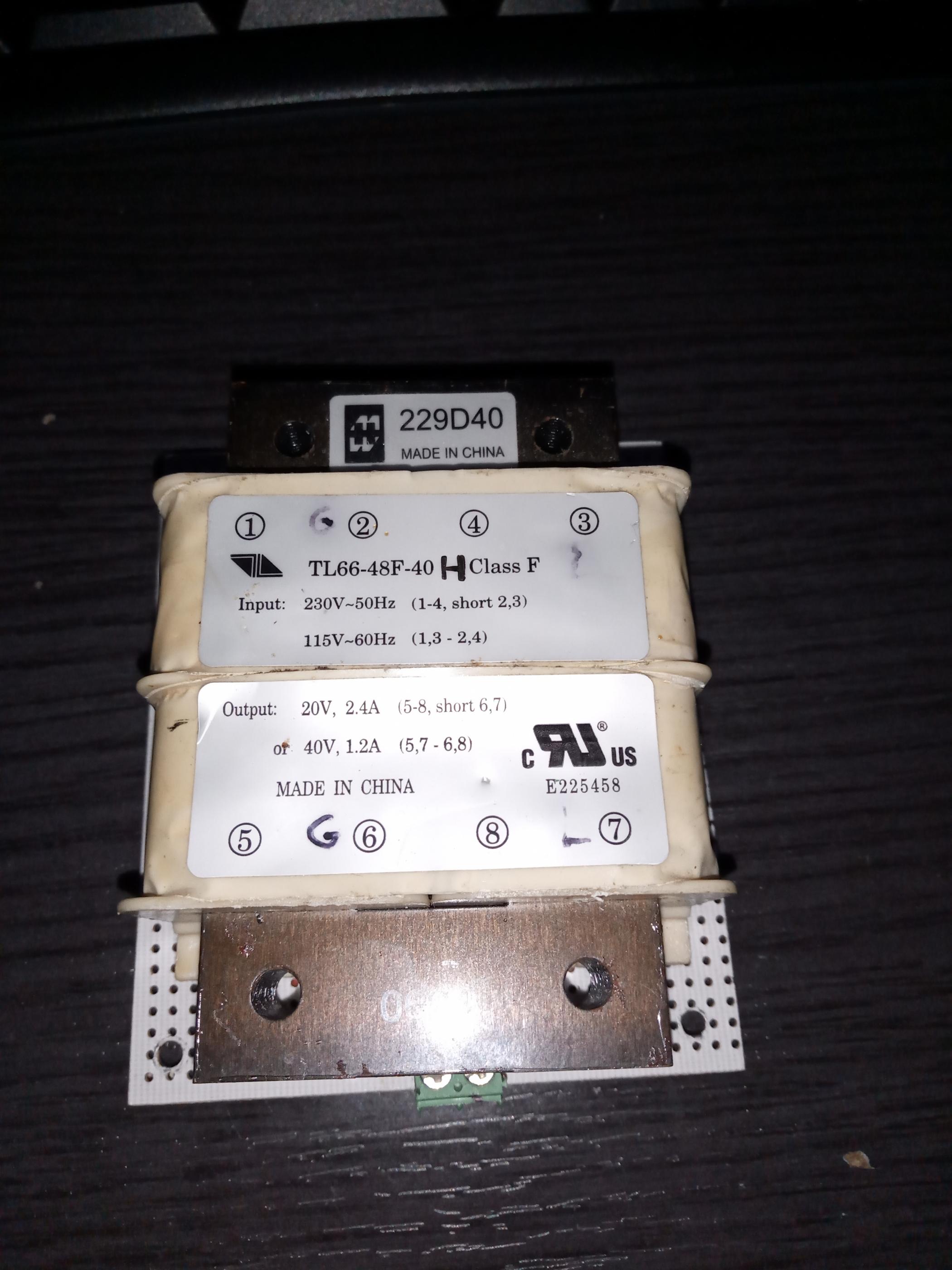

Hello Felipe,
Yes, they are split bobbin too made in China.
The triads i have some made in China and some in Philippines.
I dont think there will be differences. Didnt know that Hammonds also made them. I bought the Triads because i also use them for 5 volt heater of 5r4gyb which is rectifying very high voltage so i want a 5 volt transformer that has high insulation.
If you use the right transformer, split bobbin, you only need to take care it can supply enough current 2A will be enough with choke input and then you get a Lundahl choke with 1,2 A current rating and lots of mH. Greetings, Eduard

Hello Felipe,
I read at the Rod Coleman document that the 26 tube is 1,5 volt 1,05A. The minimum voltage you must give to Coleman supply is 6 volt and the maximum is 8,2 volt ( this CAN be higher if you use a bigger heatsink)
And your simulation shows 14,5 volt output. I dont understand.
Greetings, Eduard.
