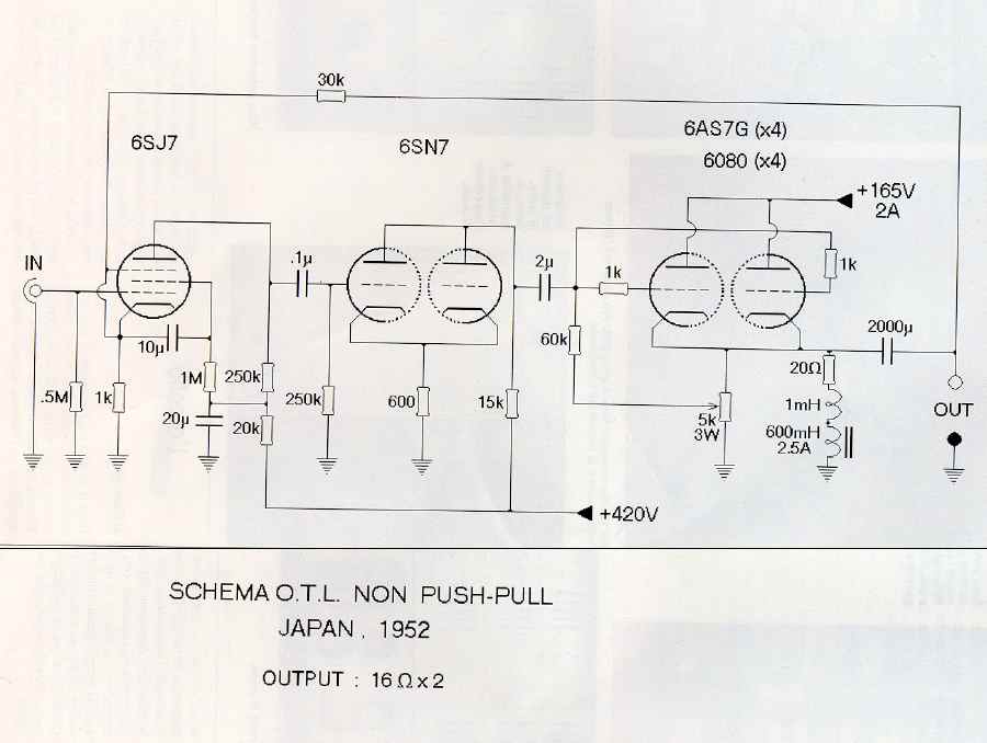

John Broskie of the Tube Cad Journal mentions a trick of using
a iron core choke in seriese with an air core choke sort of like
using a good bypass cap with that electrolitic cap. I saw this
used in an OTL amp that used a choke loaded cathode fowler
and always wondered why they did this. So in the case of a
power amp maby a 10mh high current iron core and a .5mh
air core might be an idea?
