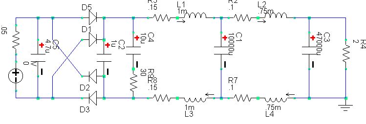

HELP !!!
I'm now in the process of building the cct below that I posted earlier.
What I am stuck on is getting my head round where to start with the chokes.
I don't really have any idea how large the cores need to be to avoid saturation and what size gap I will need.
They need to be able to deal with 6A DC.
The pairs of chokes in each leg are inductively linked therefore total inductance is doubled. i.e. 4mH & 3mH
Should I try 200VA cores as a starting point ? or do I really need to be looking at 1000VA cores to realise this design without compromise ?
Air cores I think would be too big and probably unecessary in this PSU.
God how much are these things going to weigh ?

Just for comparison, look at http://www.mundorf.com/english/bauteile/frspule.htm and from there to the transformer shape section in the menu. These coils are wound on the E-section only, without the I-section. They will not easily saturate and the size is given for different inductance versus resistance values.
If you use the additional I-section with air gap the inductance will become higher, but saturation might occur.
