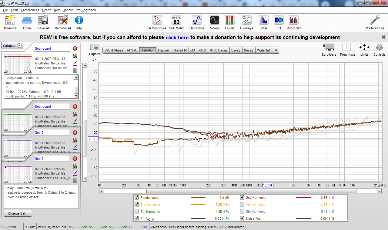

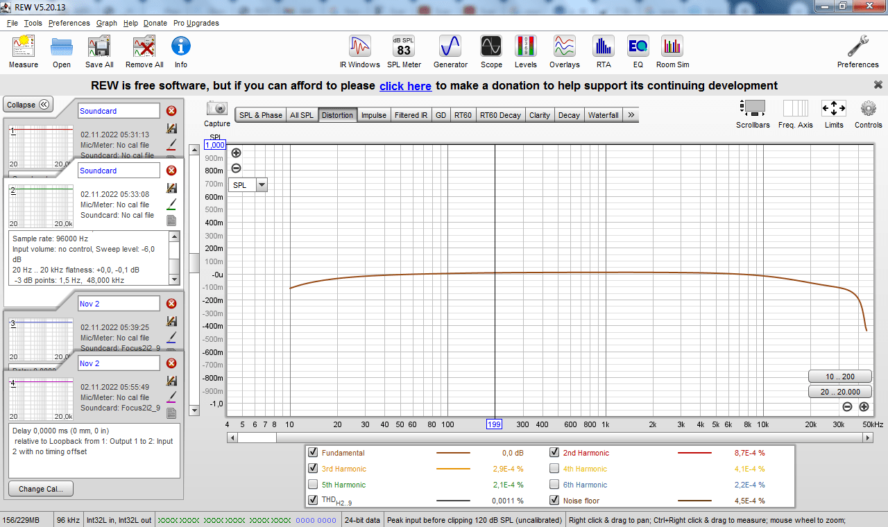

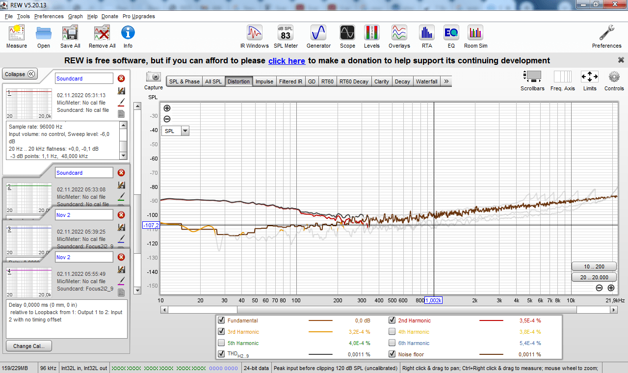

I may add, this was the first measurement when I hooked up the interface to my old Lifebook S Win7 32 Laptop.
This is without any fine tuning or compensation.
