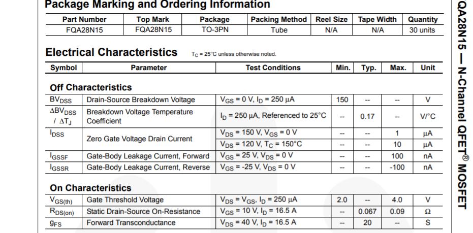

The low cost IRFZ44 is identical to IRFP150 except Vds max 60v . I advise you although I didn't tried out FQA28N15 . It has higher transconductance for lower Cgd 1200p & it is much cheaper .
I can't see gm in the DS for FQA28N15 - how did you calculate it at <2A?
Toshiba TK13E25D has gm = 6S @2A, its cheap enough on Taobao ($0.23), very low Cgd.

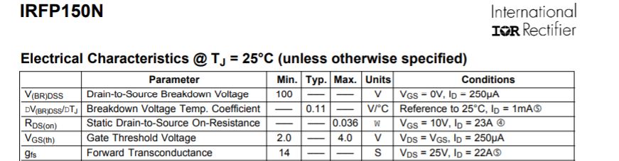

The IRFP150 needs 22A to reach minimum 14S . The FQA at16A has typical 20S . Ok , min and typ values are not comparable but it gives an idea. I couldn't find the datasheet of TK13 but in general catalog.
Yeah I saw that 'headline' figure but down at currents below 2A gm is going to be quite a lot lower. How much lower I couldn't determine from the DS. The Toshiba part I mentioned gives a graph of gm beginning at 1A, very few MOSFETs have such information.
FQA has also a log graph starting 100ma . I don't have what to measure , but it is clear it requires less than half volt to pass from 1A to 3A. If TK is 6s at 2A no doubt it is best choice.

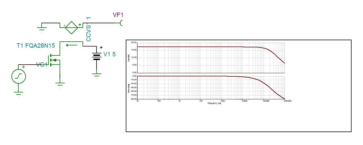

I tried on Tina , it works. you need to assign 20,10, 30 as D, G , S . At 2A it measures 7.42S.

i dont know how using CCVS i have made the mease with this asc
I have 31.108592DB so 35S at 22A and 25V VDS
and 10.7 S at 2A
