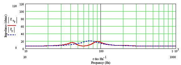

If one was to run these with a sub, would it be detrimental to the sound to use a cap to protect the CHN? I use a Voxel sub and would like to protect my pair of CHNs and still like to hear the lows.
Mike
Mike
Never a bad idea - the C value required to filter below 200 Hz or so at speaker level would be quite high - better off if possible to HP at line level - could be a single cap, but much lower value and cost
Thanks Chris. I'm not clear on the difference between speaker level and line level. I'm guessing speaker level means putting the cap effectively at the speaker terminal. Since there's nothing between the amp and the speaker, I can't figure out line level.
Thanks again. Mike
Thanks again. Mike

Filter goes between the source / preamp and power amp stage(s). All sub plate amps I've ever used have included an inline filter - some with full range feed through for daisy-chaining to additional plate amps or to the main.
Think of the device (amp or speaker) as a load the filter (XO) "sees" - the math to calculate values for any order of filter function includes the load impedance as one of the variables, and as any of numerous on-line calculators will show, the lower that load, the higher the value of C required for the same XO turnover point. I happen to like using simple 1st order slopes for this type of line-level HP, as you can use the amp's input impedance as the R, and require only a single value of C. In fact, for a fixed XO, the cap can be installed at the RCA input jack with a bypass switch, eliminating a couple of external jacks and keeping the signal path short.

So... are you saying that the sub amps you've seen have a built in filter to protect the non-sub driver??? I'm going to be playing these at the DIY Iowa show this weekend and I don't want to over-drive them. I have a sub with this amp (Dayton Audio SA25 25W Subwoofer Plate Amplifier) to use with the CHNs. If I can find a store in Des Moines, Iowa that sells electronic components, I'll pick up the components I need. My only issue is that I don't believe I'll be able to go with a line level highpass. My source will be either a computer, an iPhone/Android, or a CD player and My amp will be a Dayton Audio APA 150(Dayton Audio APA150 150W Power Amplifier).
Thanks for the advice. You guys are a very valuable source for those of us who enjoy single driver units but don't have the know-how of guys like you and Dave. I for one truly appreciate your willingness to share and your patience.
Mike
Mike - to clarify the point on plate amps - of the few that I've used with feed through line outputs, none had HP filter, but as there are literally scores of makes and models, there could be some that do - I just wouldn't count on it.
Mike,
If you are thinking of using a single cap on the speaker wire input to the CHN-70, you need to remember that the result may be different than a simple cal using cap value & static resistance of the driver. You need to know the impedance vs freq. Below is an impedance graph for the CHN-70 in the Met cabinet (which was designed for the FE108eS) from an MJK MathCAD sim. Note that it doesn't look like the graph for the driver on the MA web site, since that one is based on the baffle used in the anechoic testing. What your cabinet will do is unknown to me. As impedance increases, the effect of the cap decreases. Bottom line: you may not get the protection you think you will & you could mess up the bass response.
I second Chrisb's rec of PLLXO. One possible solution would be to buy one those cheap line level filters from Parts Express.
The Dayton 25W unit does not, it is a simple pass through. Unlike Chris' experience, this is the only plate amp I have that does not have a cap on the speaker level outs.
Thanks for the info Jim and Cal. I'll run an impede nice sweep before I do anything permanent. I'll post the graph once I run it. I have my CHNs in a vented box approximately 150 cubic inches. Until I get a filter in place I'll just go easy on them 😉.
