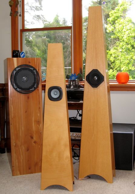

Recently received a pair of the new Mark Audio CHN-70 drivers. Eager to get my ears on them and short on time to build a new enclosure, I ran a quick sim of the CHN-70 in a Metronome designed for the FE108eSigma. Not half bad! Just stuffed BlueTack into the old screw holes, and Voila!
So they are now softly playing classical music curtesy of WMHT. Sounds nice so far, but with peek levels of 60 dB at 1 meter, who can tell for sure? We shall see what they sound like in a few weeks when it’s OK to play music at reasonable listening levels.
The CHN-70 is the blue driver, sitting between the F120A Met (right) and FF225wk Pappa’s TL (left).

Early listening impressions of the CHN-70 in the Metronome (as shown above) after 90 hrs of break-in—can’t wait any longer. NOTE: Further break-in may result in improvements! It takes much longer to break-in the MA drivers following Mark’s guidelines— only able to do 10 to 12 hrs per day (in two stretches), as opposed to my practice with Fostex drivers, where I run them 24/7 until I get to 300 hrs or so.
Playing with peak levels reaching 70 dB— higher levels will come later after I get more hrs on the drivers. Pretty obvious at this stage that the some BSC is needed: tried 0.5 mH & 1.5 ohms, but moved up to 0.5 mH & 3 ohms.
Source was my 15 yr old Denon CD player; driven by my vintage Yamaha CR-1000 receiver (direct coupled SS).
Test tracks:
— Ode to a Butterfly, performed by Nickel Creek
— Urgent Desir, performed by Lara Fabian
— Crazy Faith; performed by Alison Krauss
— Blue Rondo a la Turk, performed by Dave Brubeck
— Nevermind; performed by Airto Moreira
Comparing with FE108eSigma Mets; note that the CHN-70 cost $27 each, while the 108 cost $112.50 each. My wife & I agree that the CHN-70 sounds quite good; we would be happy listening to them for long periods of time. No issues with sibilance; no harshness. Because I have a particular fondness for the 108, I may suffer from expectation bias; my wife is a disinterested party and only knew that I was switching between speaker A and speaker B. In my wife’s words: the CHN-70 sounds more smoothed over; piano notes are not as clear & bright; cymbals are also a bit dull by comparison to the 108. The 108 also has a bit more depth of sound stage than the CHN-70. Other differences are even more subtle; suffice it to say that the two drivers do sound different in the mid-range, but I think it’s a matter of preference rather than one being more correct than the other. And with sub-par recordings, the CHN-70 may help conceal warts that would otherwise make the recording unlistenable for some. I think in particular of classical recordings where the massed violins are particularly harsh. (Which begs the question: is it better to use fewer mics, further from the instruments so that the sound from individual stringed instruments have time to blend, as they would in a live concert; or place many, many mics close to the strings and assume that the blending at the recording console approximates what you hear live in your favorite concert hall seat? Inquiring minds want to know!))
As with the 108, I would use the CHN-70 with a sub. The bottom end may be sufficient for casual listening, but adding another octave on the low end takes it up to another level.
Since they aren’t fully broken in yet, I can’t crack up the volume to see how they do at louder levels, but I am expecting them to do well there too.
Bottom line: I think the CHN-70 is already looking like a real bargain! (However, for those who have wondered: yes, there _is_ a reason why Mark produces the more expensive Alpair 7 series drivers.) When they have a few hundred more hours on them, they may be even better!
