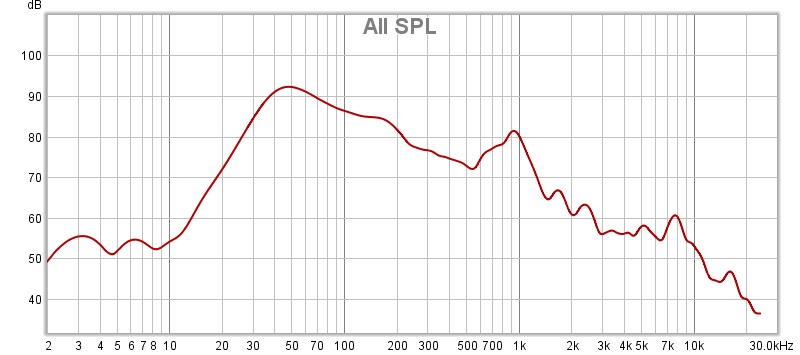

In the spirit of wanting to understand more around MLTL designs, and also tuning the speaker to my room, I've been tweaking the stuffing placement and density.
The attached image represents a sweep measurement taken 1cm from the vent output. Overall I am fairly happy with the general balance of bass output. I am however curious about the peak at around 940hz. I understand this part of the 'ripple' response of these designs.
My questions - Is there a way to reduce this peak without reducing the low end output? Is this peak a standing wave? Would there be a most effective point to place the stuffing to effect this peak in particular?
FYI - cabinet is currently stuffed to the advised density (around 1lb/cuft), but only in the top half. I found when I had the duration stuffed it reduced low end output too much for my room/preference. Obviously more stuffing would likely reduce the higher peak (and this was supported by my earlier measurements) but also served to reduce overall bass output too much.

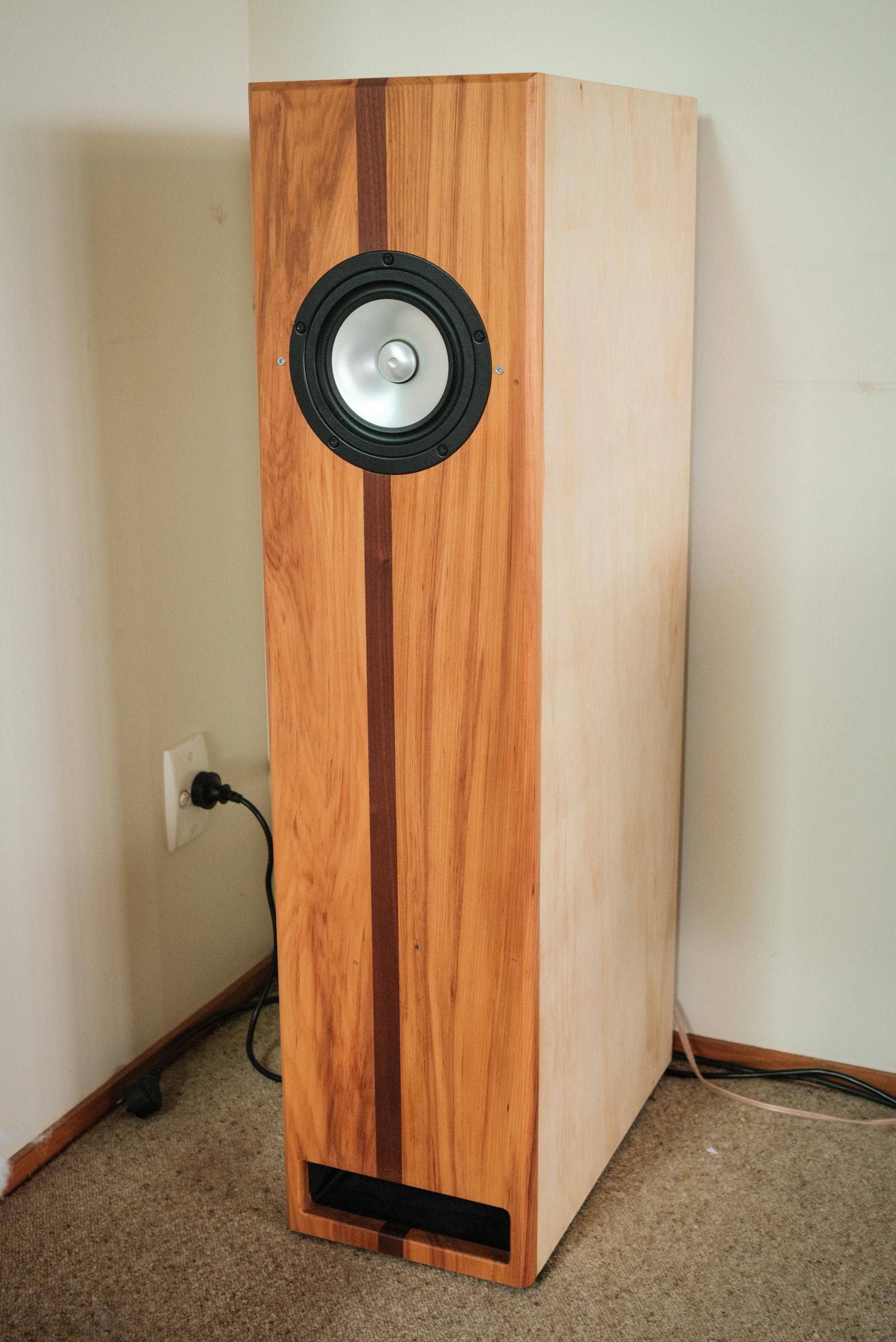

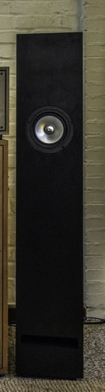

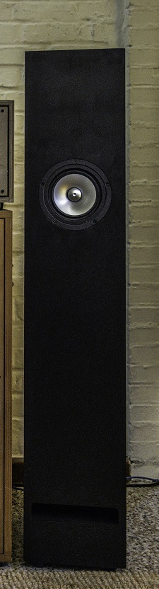

Thanks for the responses.

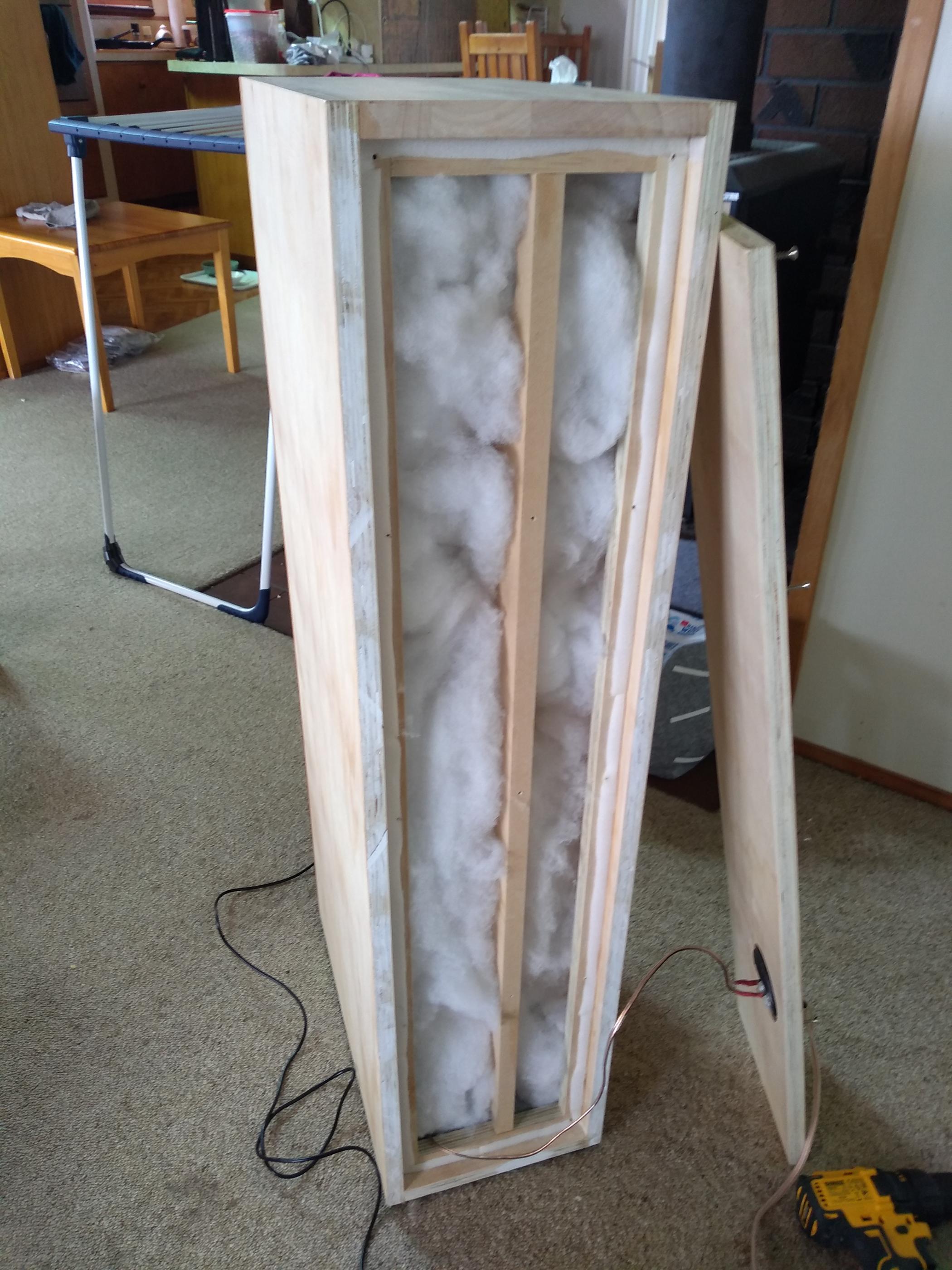

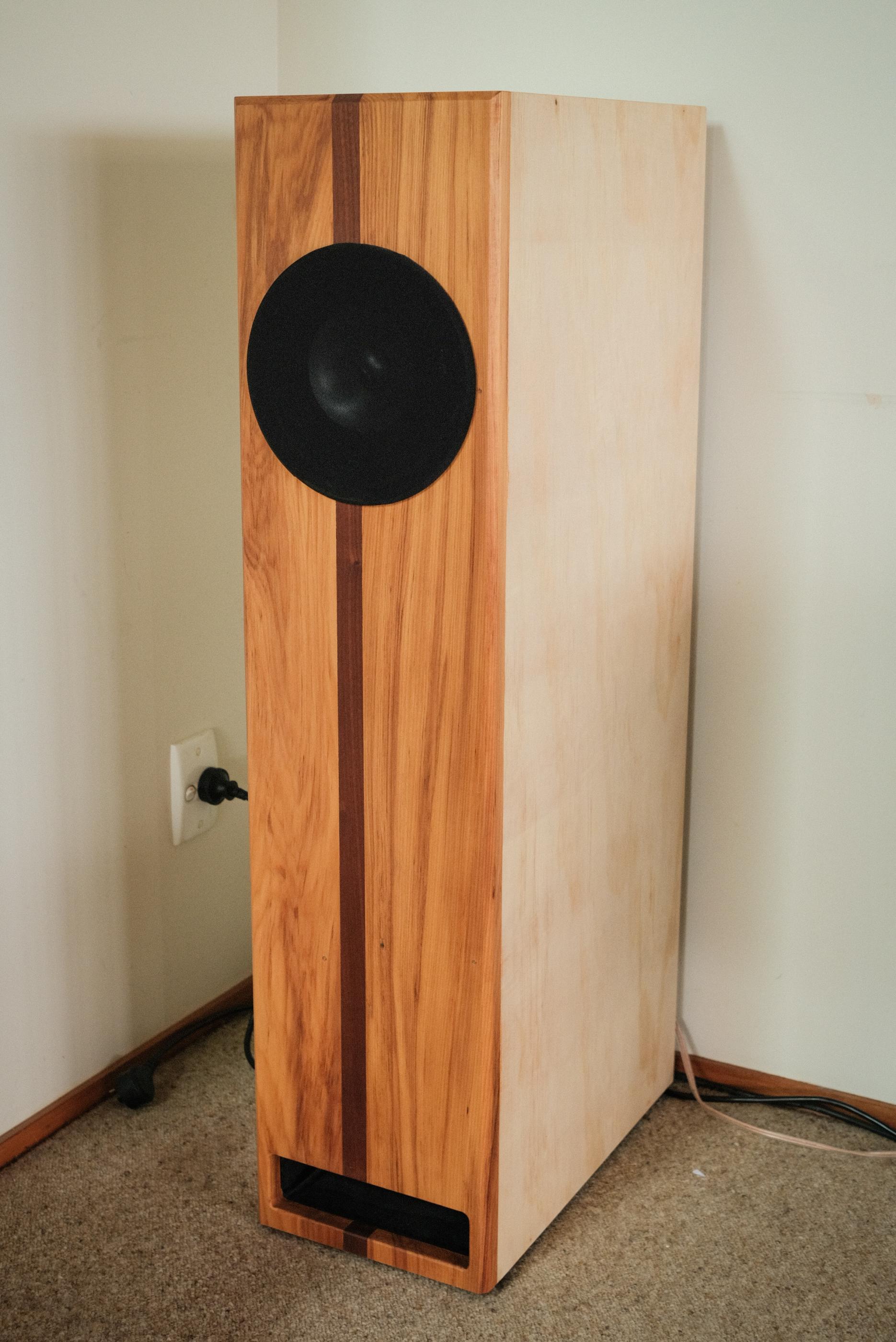

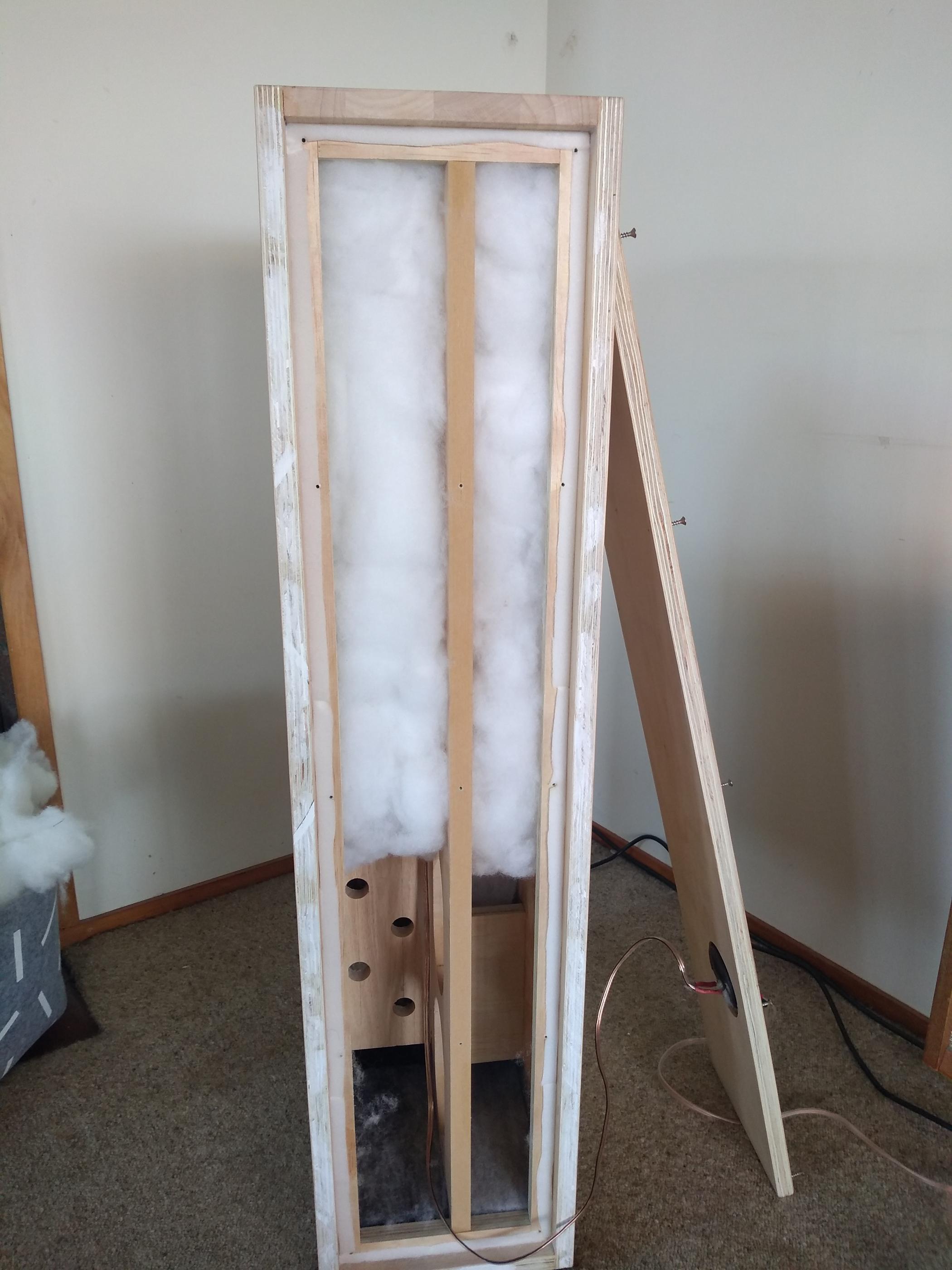

I've attached a couple of images of current stuffing configuration and front of speaker. I'm aware my current stuffing isn't what is recommended for this design. I had tried that initially, and ended up where I am now through trial and error. It seemed that stuffing throughout the length, especially closer to the terminus end started to reduce the low bass more so than I desired.
Dave - I would however be interested to lightly stuff the whole line for comparison to current arrangement.
Again - I'm not unhappy with the speakers at present, was just interested to learn more about stuffing effects, especially with respect to the observed peak around 940hz. My recent previous builds have all been open baffle so this was my first MLTL.

Seems due to the small dimensions of the cabinet, around 7" or so.
I agree
I agree
Interesting - I'll need to measure but probably the only dimension close to that would be between side bracing and front/rear speaker wall. (I'm assuming what is being suggested is a standing wave between two parallel surfaces). Will possibly try opening the holes in the brace or making sure stuffing is around it to compare.

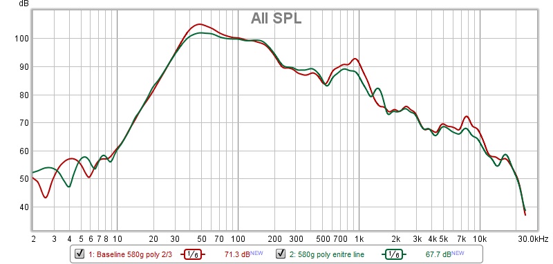

So to follow up my own query, and for sake of comparison, I measured the vent output (1cm from opening), at the previous stuffing configuration and again with the same weight of stuffing (relatively)evenly distributed throughout the line. Total stuffing weight was 580g (1.27lbs) per cabinet. Stuffing is cheap craft polyfill. This is just under 50% of recommended stuffing weight. UMIK- 1 mic into REW.
As can been seen, this attenuates bass output circa 50hz by around 4db and also smooths some of the other observed peaks.
Thought it may be of interest to others anyway! I spent a lot of time searching the net for similar types of comparisons in Pensil speakers.
If this proves too significant a bass reduction (following extended listening) I may look to reduce weight again but maintain the whole line stuffing. I have no idea of the interaction between the port output and the direct sound coming from the driver itself, and to what degree the vent output translates into in-room FR.
It looks more teased than many. But too dense at a guess.
I take that back. Looking at the picture in the next post it needs more teasing. A fair amount.
dave

Gotcha - I did do this in a bit of rush to take the measurement so will probably need a little more attention. Based on what I'm hearing in my room, I'm thinking around 450g may be the go. Will post more measurements when I get a chance to play again.
I am also on Dave's list of "people who need to pull the stuffing out and tease it until you can't see straight". I am looking at wool carding tools at this point. While doing it all by hand will be faster and cheaper, if I can come up with a method to tease the material properly using inexpensive tools in a fraction of the time (excluding shipping), I think that a lot of people might benefit.
