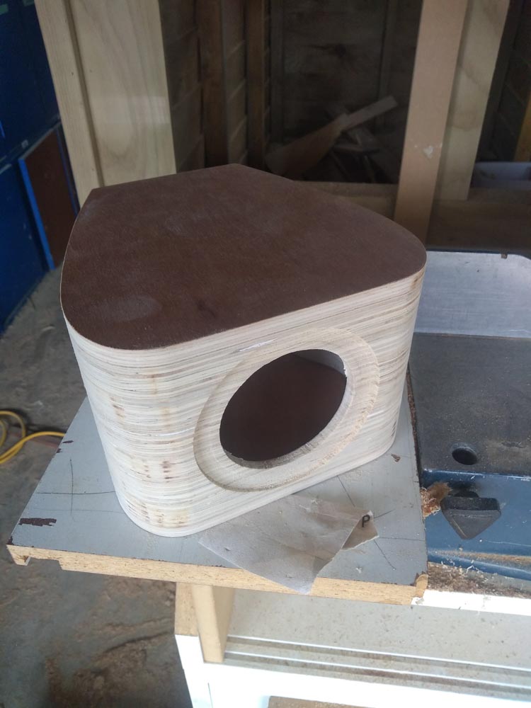

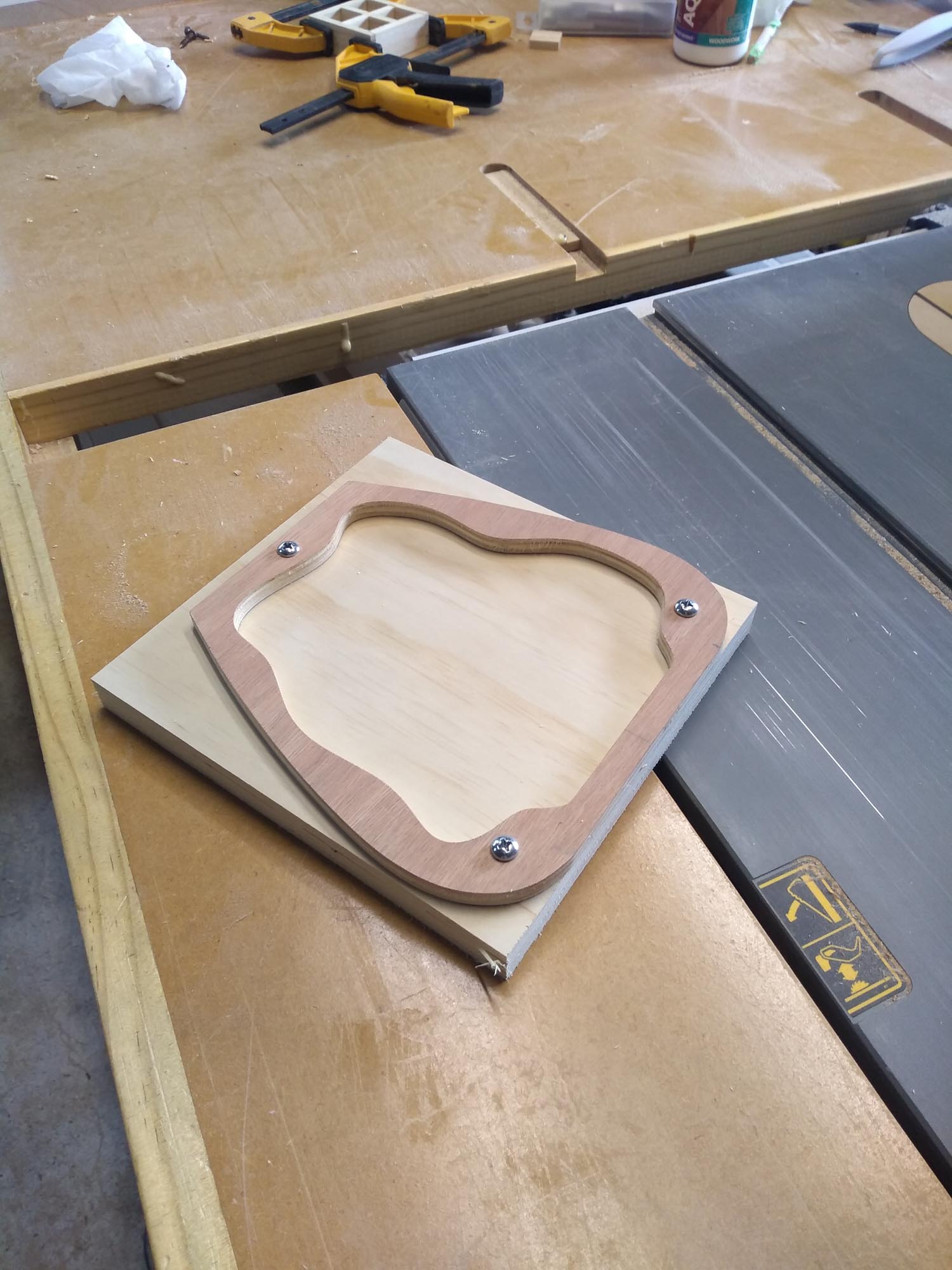

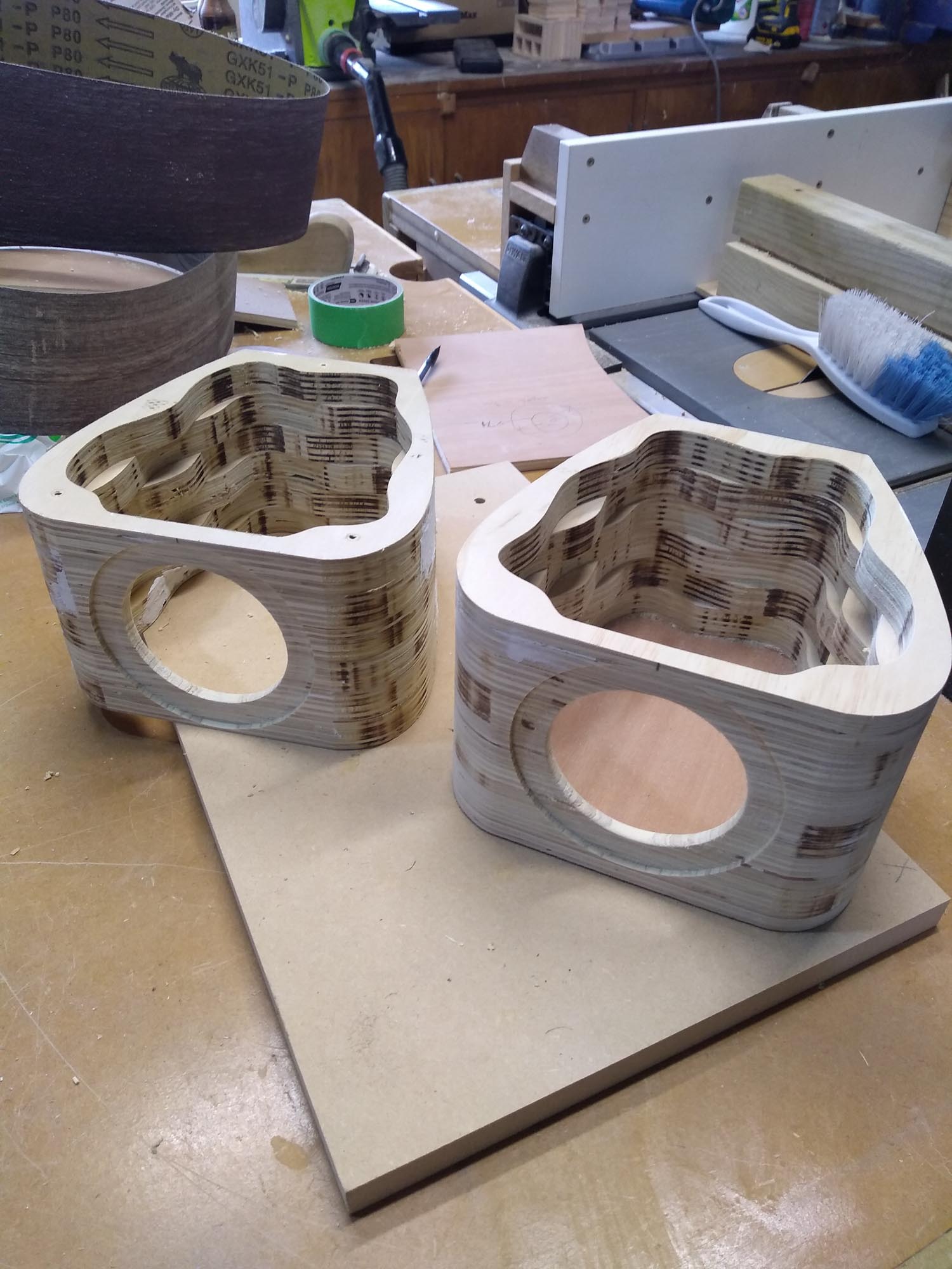

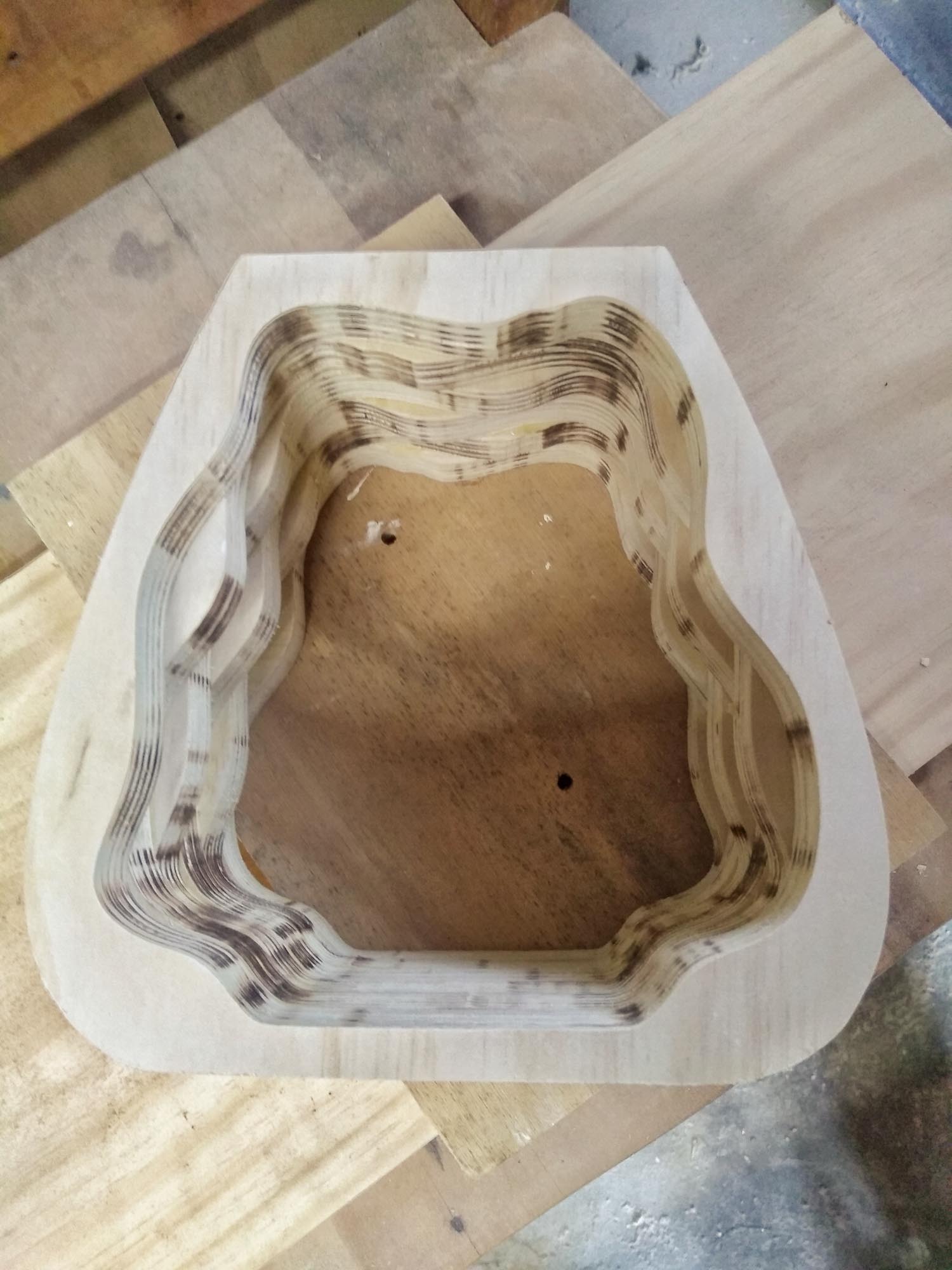

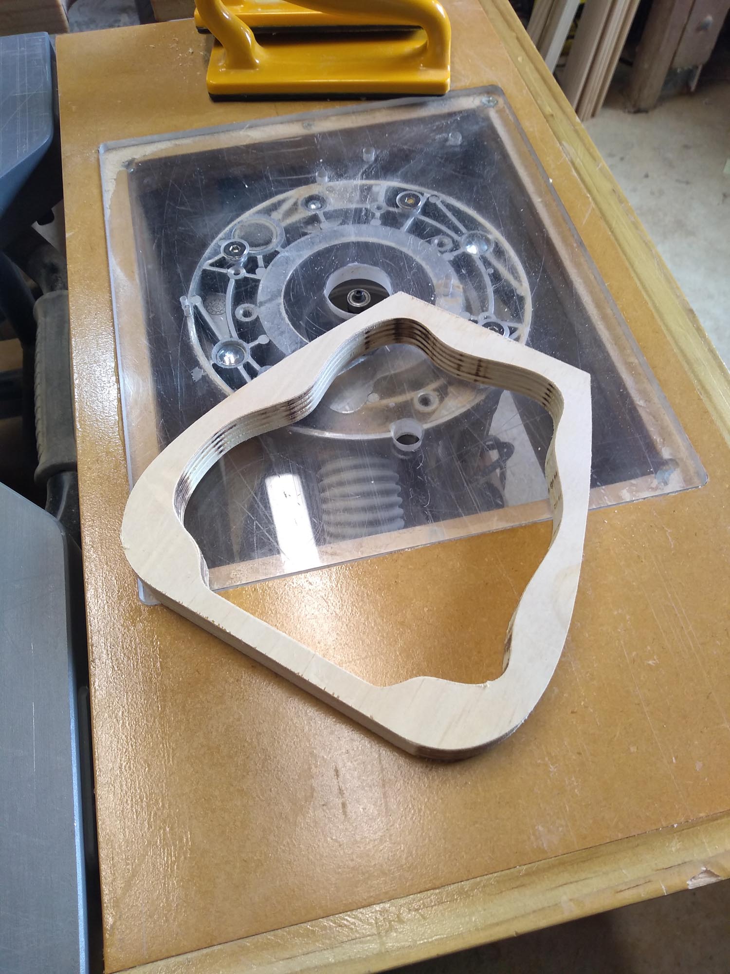

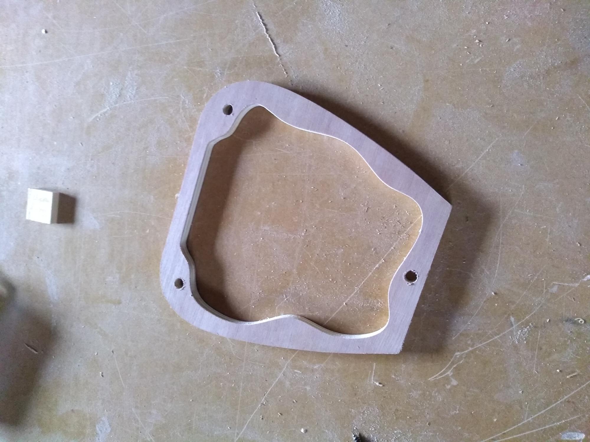

While waiting for drivers to arrive I made a start on a sealed enclosure. I'd wanted to try a CNC multi-laminate idea, so thought it was a good opportunity to do this on a small scale - and yes it was definitely inspired by another much more ambitious build on this site. In saying that, this design isn't highly considered but I'm hoping that the external shape will reduce diffraction and the internal shapes will serve to mitigate standing waves (in theory at least). Each speaker will be six 18mm layers high, and layers will alternate to provide a more complex internal geometry.
Box volume will be ~2L as per Dave's suggestion. I CNC'd the template from 9mm ply and will build the final form from 18mm ply. I'm using the template to cut the ply with a flush trim bit. I could have done it all via CNC but the machine I have access to isn't mine and is fairly light duty so was looking to be a long process.
One down, 11 to go, then top/bottom plates, speaker cutout, external finishing, terminals, and then should be done.

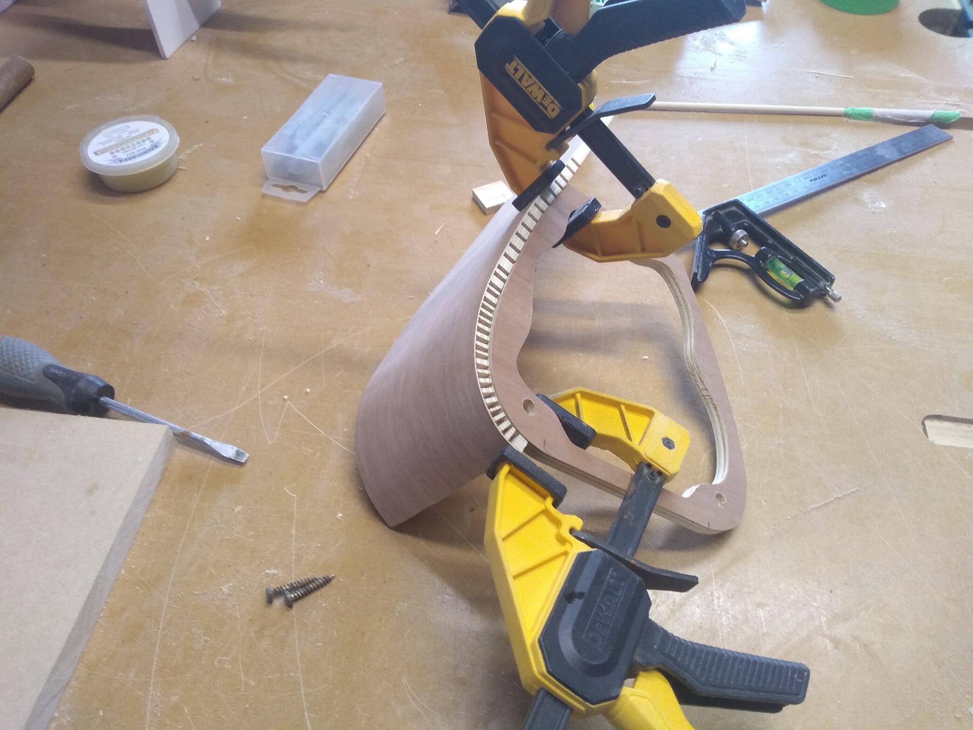

As an aside, I also experimented with some kerf bending - however, dunking it in hot water did not have the intended effect and was the end of this experiment

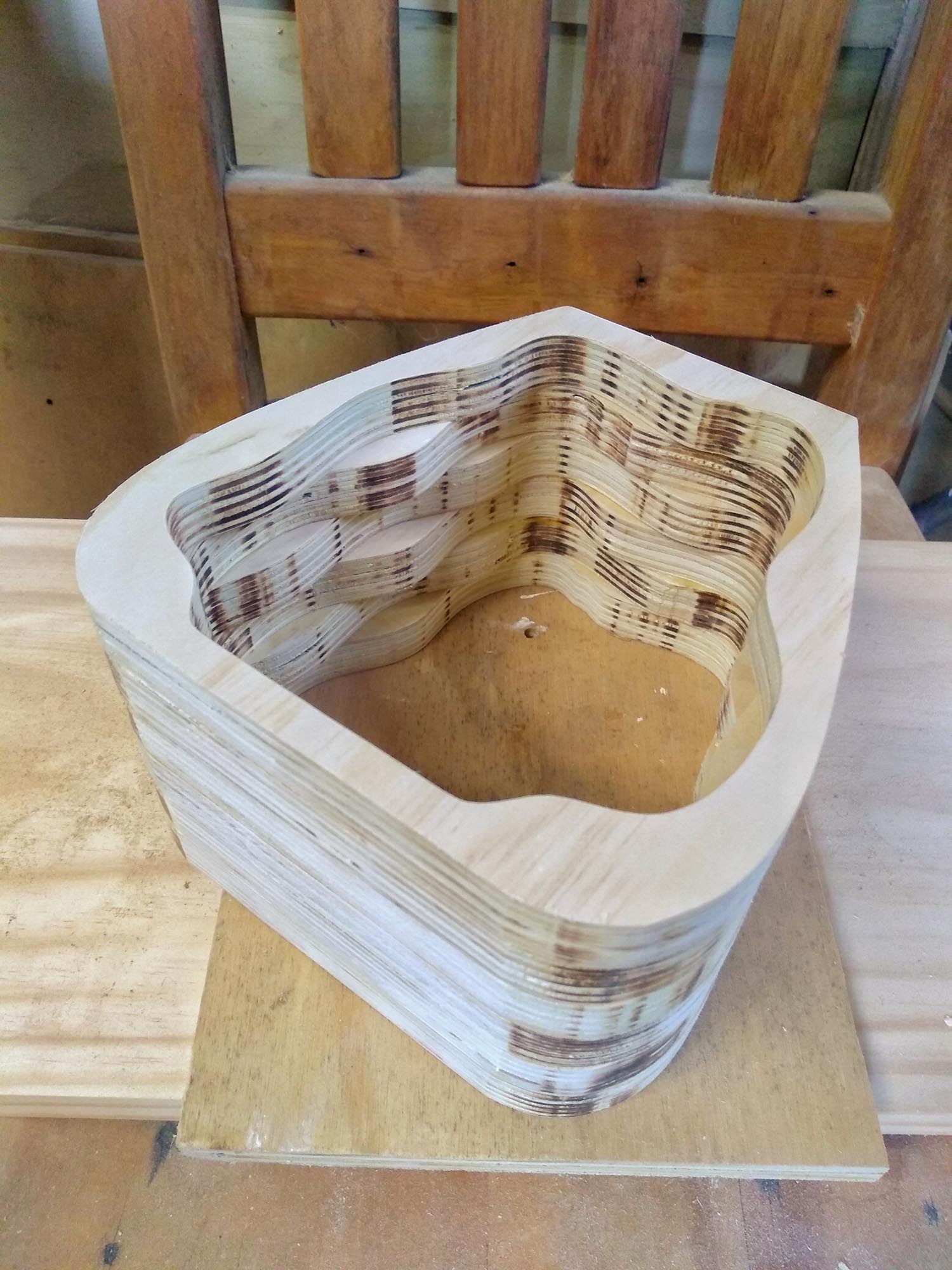

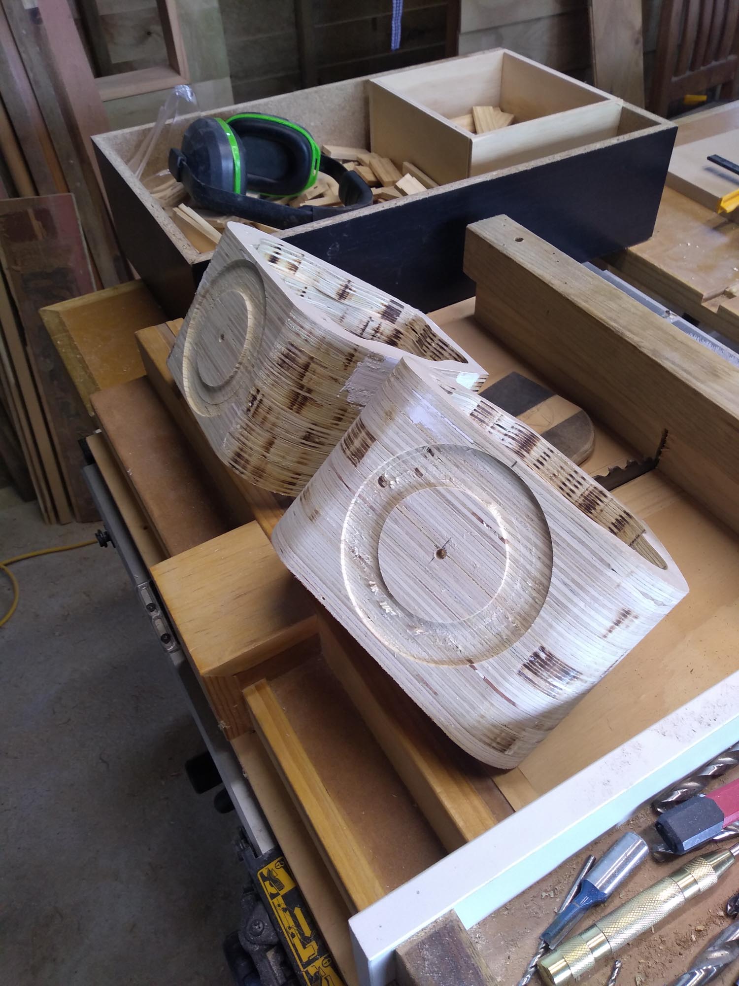

Made a little progress on these. One side 'stack' is complete. Unfortunately my router bit is starting to get blunt, so might need replacing before I can complete the other side.
I like the concept but next time (floor standing MLTL??) it will be CNC all the way! It's also going to be difficult to tidy up the exterior so maybe a fabric wrap or similar is in order.

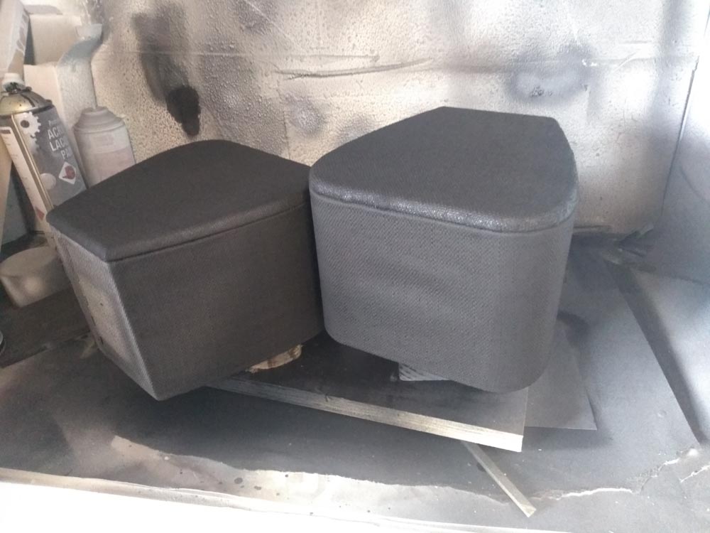

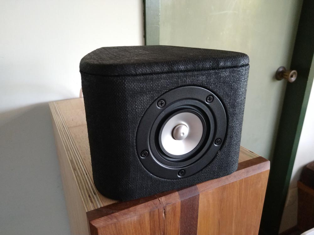

Quick update - drivers finally arrived after a rather long voyage. Finished up enclosures and wrapped in fabric which I then opted to paint black...possibly not the best choice.
Have been listening to the CHN50s for a couple days and am really impressed, even in such a bass limited application. Neutral FR and good dynamics to my ears, possibly not the last word in HF extension, but will need to run a mic over them at some point to see what they are doing.

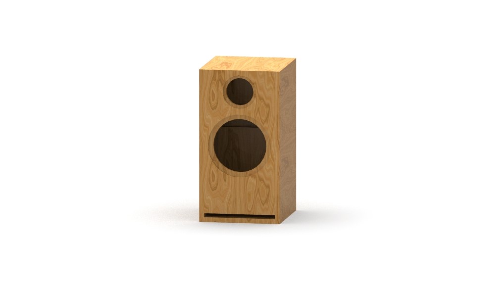

Still pondering next steps. I modeled up my Pensil in HR and it would seem I could actually mount the CHN50 into the existing enclosure, and the volume loss (assuming small sealed box) wouldn't be significantly detrimental to low end extension.

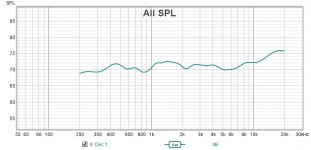

For anyone interested, I got to do a couple basic measurements last night. No problems with HF extension - on-axis there is a significant rise from 15k which smooths out nicely off-axis. Impressed with the overall flatness of response.
Attached measurement was taken at 1m and gated at 6ms from memory, around 10 degrees off-axis. I'm pondering whether I am better to build a two way of some sorts using the CHN 50 and the CHN 110, rather than mangling the existing Pensil cabinets...decisions...decisions...
